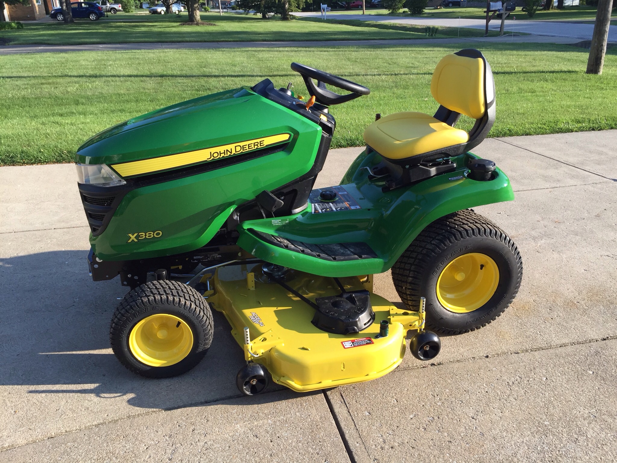

I bought JD X380 this spring. I also have two acres to cut. I have a lot of trees, patio stone lined flower beds, little bit of inclines, a landscape mound that is about 100' long, about 10' wide and about 5' tall. I have a 54" deck on it. I was cutting before with a Skags 48" walk behind. Took 2 hours with the Skags and I walked at a decent clip for 6 miles. Just got tired literally of all the walking. I can cut the same area now in 1 1/2 hours. I have an open area that is about an acre that is a bit bumpy. The machine cuts nicely, as long as you adjust the anti scalp wheels like they tell you in the manual. The left pedal that lifts and lowers the deck is a lot easier than a lever. Parking brake is easy also. The seat moves back and forth and also has three different positions for the springs, which changes the way it rides depending on your weight. I wouldn't buy a gas engined mower that wasn't a Kawasaki, love their engines. Fuel injection is spot on, gas filler is big and in a nice location on the left rear corner. The 54" deck is as big as I could go and still fit in between some fences and flower beds. The extra 6" over the Skags 48" makes a very noticeable difference. I like the gas gauge and it has the hour meter and pto rpm gauge too. My favorite feature is the magic yellow button that lets you go in reverse with the pto engaged and keep cutting. Works like a champ. You don't have to hold it in the whole time, just push it rit before you step on the reverse pedal. Once you hit the forward pedal, it resets itself. The tractor seems to be built pretty well. I did a lot of looking, reading, and research before buying this. Most of the other machines in this size are not made to last, course they are priced cheaper, but I don't like throwaway stuff. I also bought at about the same time a JD2032 with a front end loader and a backhoe, for maintaining the property. I still have to get a brush hog, York rake, and box scraper. Bought them both from the same dealer, who gave me a very good deal and seemed very knowledgable. Hope this helps, any questions, feel free to ask.
Mike Hawkins
