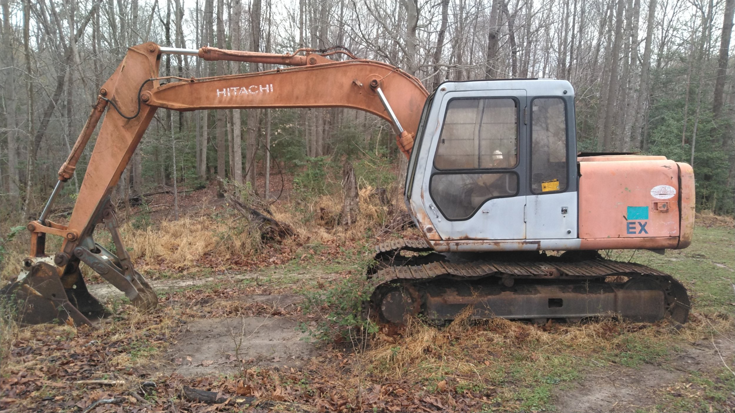

I have been wanting an excavator for about 10 years now. I have been trying to figure out how to afford to buy one for 10 years as well. I have rented a mini-ex several times to do work and clear land but always dreamed of having my own. I finally ran into this Hitachi EX100. It is grey market and a family member owned it. I am extremely lucky, thankful and grateful for this family member letting me have this.
They were done with it and did not want to invest any money into it to fix the hydraulic leak.. It was right down the driveway from my property and had been sitting for about 4 years with briers growing up around it. I would ride by it all the time and never think anything of it. I was wanting a newer mini-ex. I also thought it was probably no good. I was wrong. It cranks right up and purrs like a kitten. It does need some TLC. As of right now I have $ 1500 in it. Had to have the rotary valve assembly rebuilt and put new hydraulic filters in it. I used it today to dig up some stumps and knock down a few trees. I am a happy camper.😁
Items that I will be fixing/maintaining in the near future are changing engine oil, filter, coolant and new exhaust (rusted out). It needs a throttle cable/motor but rigged up right now to work. One of the boom cylinders has a leak and I am going to address that next week (just seen this). It is going to need new track tensioners but my mechanic said it will be fine for now. Also, will be replacing hoses as necessary. I am new to this world of excavators and have a lot to learn. I am estimating probably spending about 10 to 12 grand total to get it where I am content. I have a heavy equipment mechanic helping me because I don't have the knowledge or skill set yet to fix things on this. Also, a little intimidated by the size of it but excited as well. It has 5700 hours on it and came with a 2 buckets.
Congrats on a great find. It's good to take your time to find the right deal.
Be careful operating it before fixing the track tensioners. If the tracks are loose, they will come off. And they look loose in your pic. Ask me how I know this...
Yes. I am planning on spending now to fix the tracks. My cousin used it like that for who know how long but knowing my luck, they will come off.

As of right now I have around $ 4,000 in it. This includes:
$ 1400 Rotary Valve Assembly Rebuild (mechanic, rebuild and hydraulic fluid, including new hydraulic filters)
$ 1800 New Exhaust System including mechanic to install.
$ 150 Oil Change done by myself
$ 200 Air filter, Anti-Freeze and other small maintenance items so far
$ 3,350 TOTAL so far
The 2 track tensioners will total $ 3,000 and probably 1500 for the mechanic to remove tracks and pull out old tensioner and put new one in. So about $ 4,500 total for that. I am just going to keep running as is until I get to this. So far, it moves just fine. Tracks are just froze up in places.
$ 8,050.00 will have me pretty much good to go for a long time.
Have not priced the boom cylinder yet. It is a very slow leak and my mechanic said it will be ok for now and just keep an eye on it. I will also be replacing the hoses as needed so that will be a cost as well.
When all said and done I am still thinking around $ 10,000 for everything that needs attention.
I will tell you one thing to think about if getting an older excavator, if you need a hydraulic pump, pull out the pocket book. If I ever need a hydraulic pump for this thing I am looking at $ 8,000 😫. I am so glad the hydraulic pump is in good condition!!!! Make sure you check that put before buying. I put 200 dollars up front just to get it checked out. It was money well spent.
