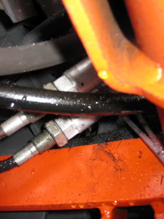

Jayhawk this is what my caps look like with the hole drilled into them.
   / joystick freezing up in cold weather
#25
THANK YOU!!!! That helps a whole bunch. I will drill them out tomorrow and keep my fingers crossed that will take care of my problem.
   / joystick freezing up in cold weather #26
:confused:I don't think those are the caps you need to drill out,
it's the other end, it has two screws holding the cap on.
   / joystick freezing up in cold weather #27
You can do the caps on either end ( two on each end), but this was the cap that had held moisture and was freezing my joystick.
