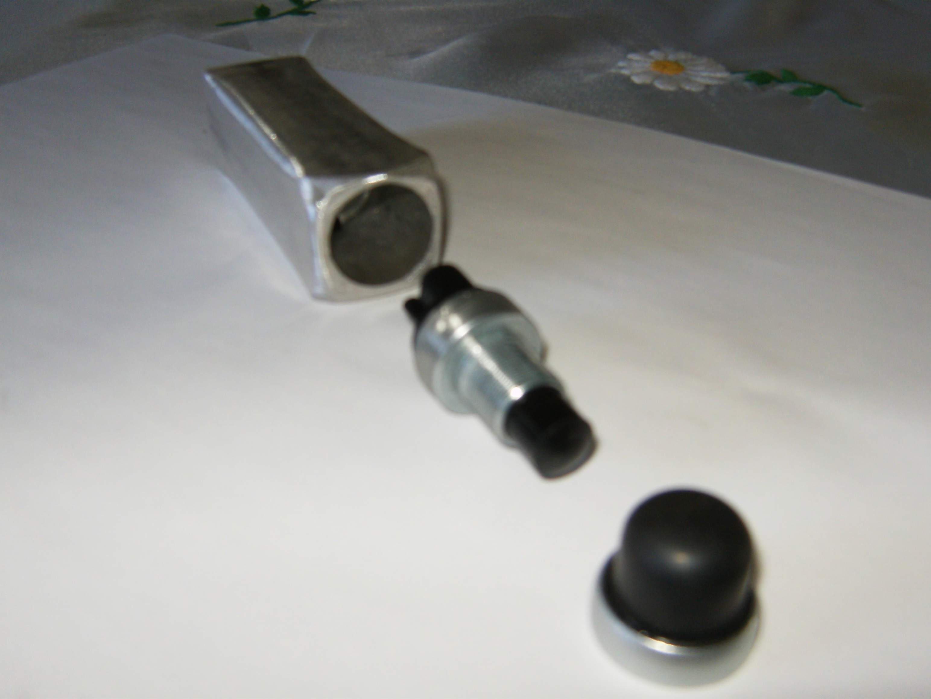

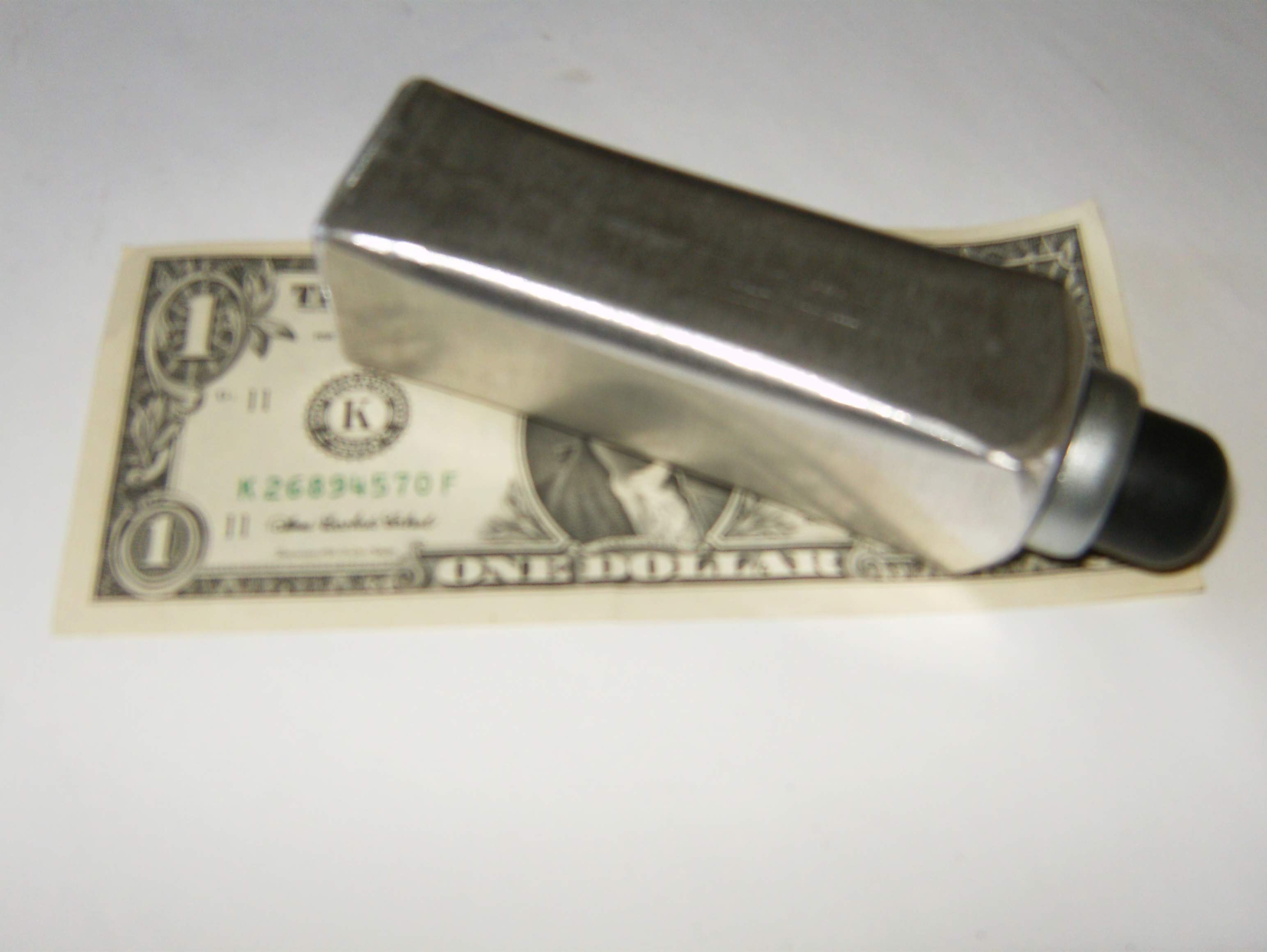

OK-I'm not real good with attachments, let's see if I can do this!
http://www.philmore-datak.com/mc/Page 187.pdf
And pictures:
OK- Started with 1-1/4x 1-1/4 aluminum block, a few holes, a little 'tapping', some shaping, and 'voila!', a 50amp switch knob! $10- total. Have a great Easter everyone! ~Scotty

Very cool Scotty;)
