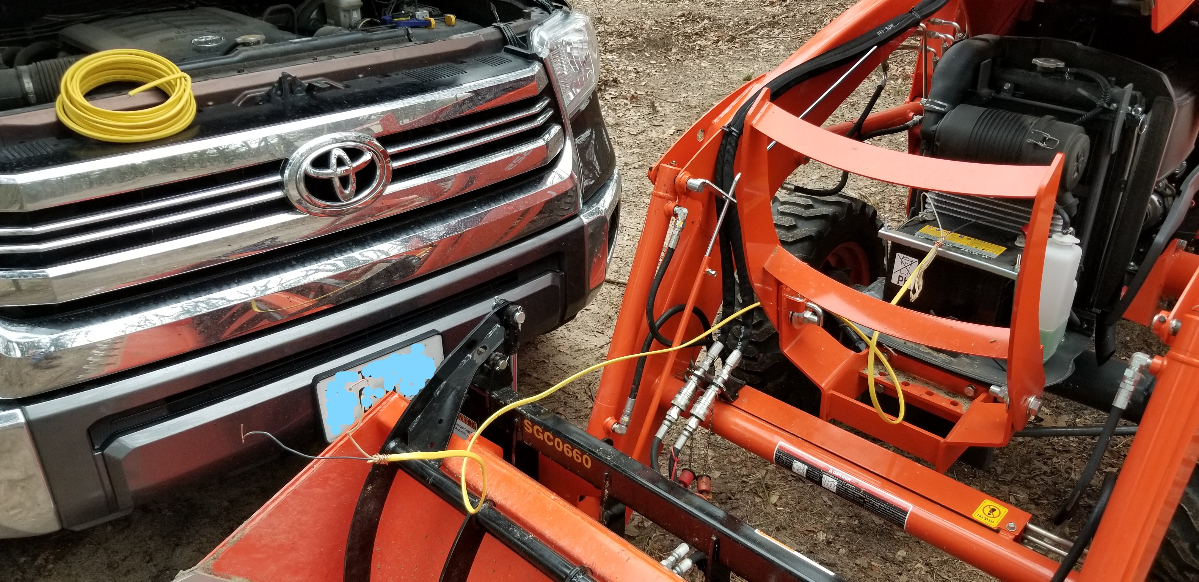

Accidentally ran the truck battery down today... Kubota to the rescue! Does this meet approval of the jump start experts on here?
