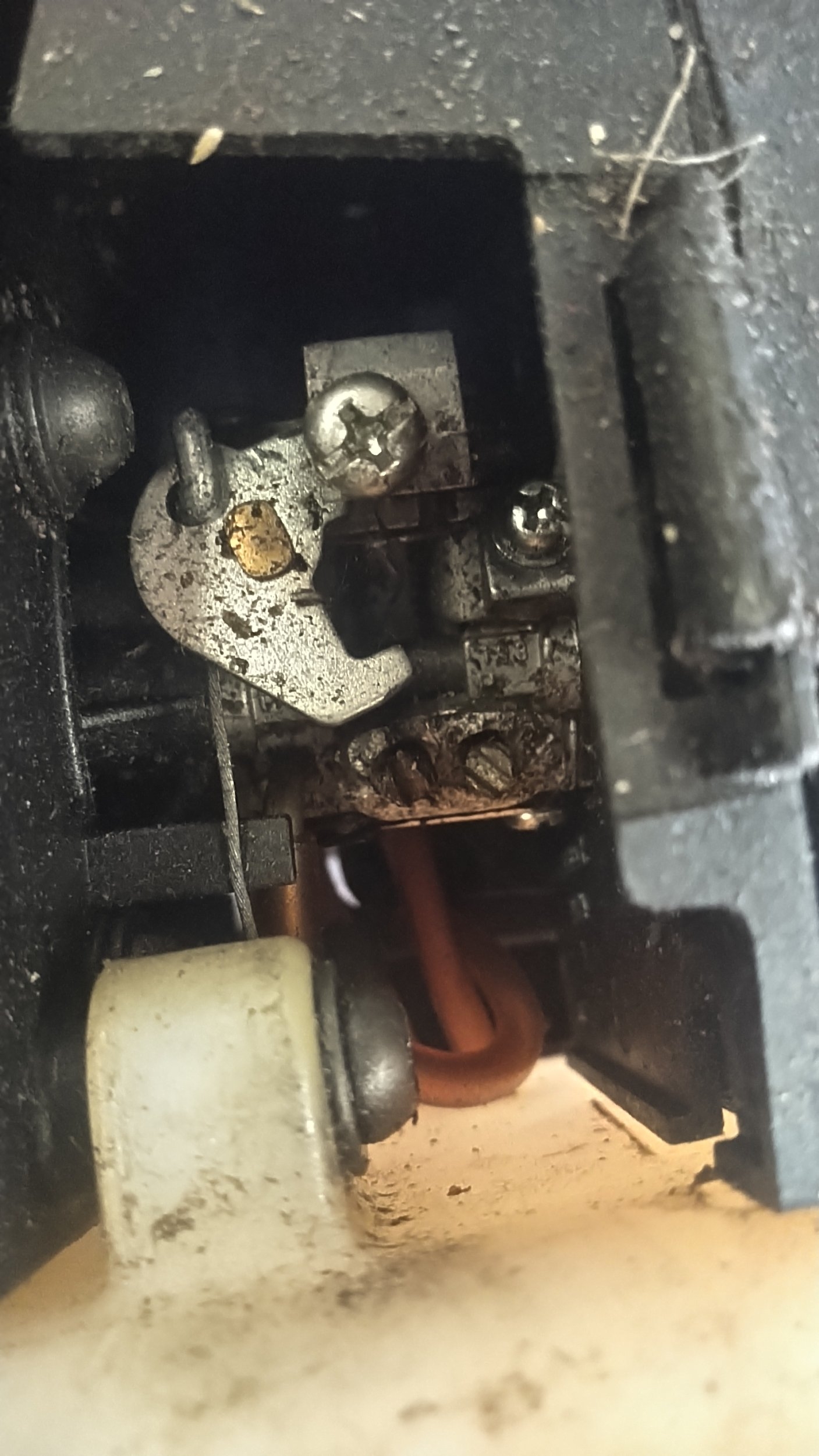

Probably why most run 40-1 now, yep it was probably direct drive problem was when it eventually warmed up it still had a terrible bog on the top end of the power band until I opened up the H speed adjustment screw, however low speed and idle never could get it acceptable to where I could use it. still a complete POS and I expected more even at the price I paid. I owned and used two cheap boxstore weed wackers for a decade previously at my cabin and made them work for occasional use. I can say the echo 225 I eventually bought is a completely different level of qaulity for less than a hundred bucks more and completely worth it in my opinion. And still about a hundred less than a Husqvarna I use at home and was looking at for up north.

You can remove the limiter caps on an Echo quite easily and if you pull the aluminum connector, you can put the limiter caps back on with no limiting and the caps are much easier to get a screw driver on too.

I disagree somewhat from that I remember buying a brand new carbureted snowmobile around 2004 I remember in the owners manual for break in first few tanks of gas it stated to add oil to the gas it also had oil injection. I do think by putting excessive amounts of oil in a two stroke you will have significant carbon build up in the engine which will eventually score the cylinders if built up to much. Getting back to a junk Weed Wacker that TB had a bog (dead spot) on the top-end of the power band sounding very similar to when I've blown other two strokes cause they were to lean. So I enriched the h speed screw by unscrewing it went away. Like I've stated previously I called the customer number on it before I screwed around with it was put on hold for almost hr, said f-it and tinkered away. As for the line completely unwinding the bump feeder was jammed. If it had a clutch to engage the shaft it may have been prevented or at minimum would have idled better instead of putting a load on the engine immediately at start up. Maybe I got a Friday special and it was a fluke, and I've got my moneys worth on other cheap box store brand equipment but was so sick of this one I brought it back the day I purchased after many failed attempts to use it and get it running somewhat reliably.
