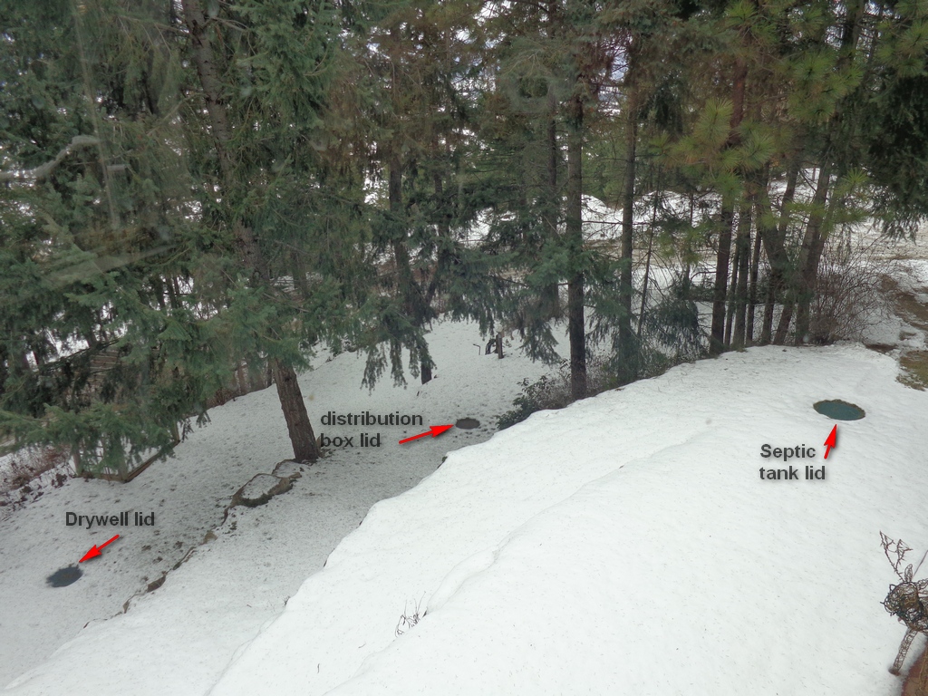

This would be a good sign your system is working there's another dry well but it's behind the trees.
The top of the tank is about 3' below surface and the dry wells 4' to the top then the extensions. This is a good time of year if you have snow to determine where your tank is if you don't know.
I had to check, mine is down about 12-14" and I know where it is. About 4" snow cover and not a sign. Of course mine has a very light load, only me and I don't flush anything but solid waste and TP.
