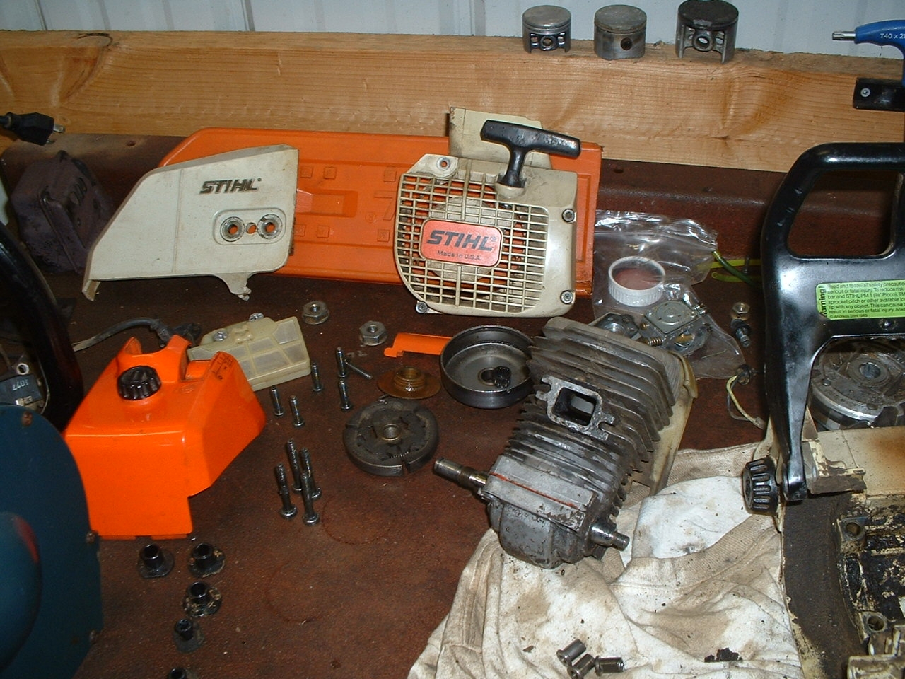

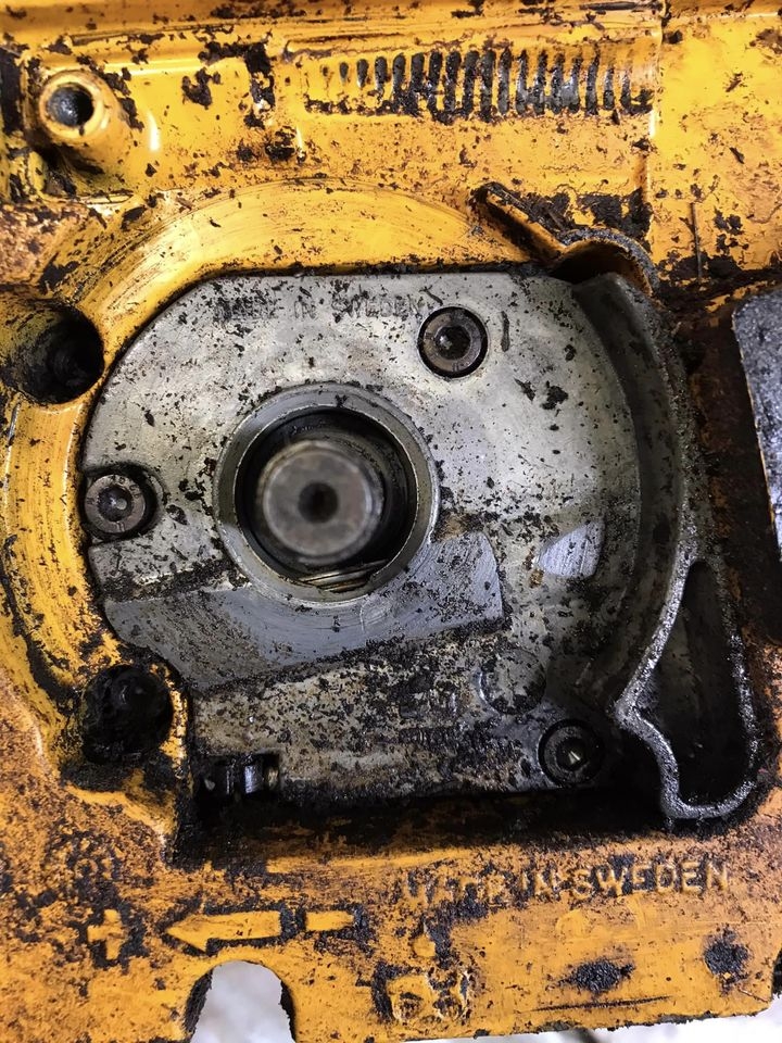

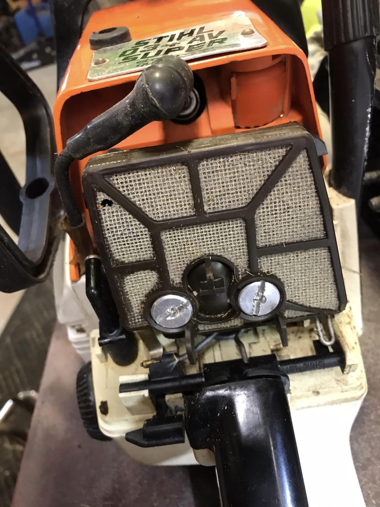

Hated seeing this one come in hurt. Stihl 034 super.
I'm only one that has serviced it since new. Think he said bought it new in 90-91.
Owner older and saw fell out of tree trimming some limbs. Now he wears duct tape bandage on air filter done by owner.
I ordered him a new oem air filter. Besides the hole that got poked through. He took a brush to the flocking. Which isnt good to do. Lot missing now.
Old pic showing West Germany on recoil.
It wears a 460 rescue handle now. This thing is strong and great psi. Getting older suks for him with no decomp.
Also updated it to 2 pawls instead of 1 like came when put new pulley in in past.
View attachment 839036View attachment 839037View attachment 839038View attachment 839039View attachment 839040
I have the same saw. Made in West Germany on recoil. 034AV Superquikstop. Incredible power to weight. It was fine but I got an OEM 036 jug kit with all the stuff. So I had to buy 036 plastic. Never had lower bearings and I worry about that but the saw is a spare to the 361.

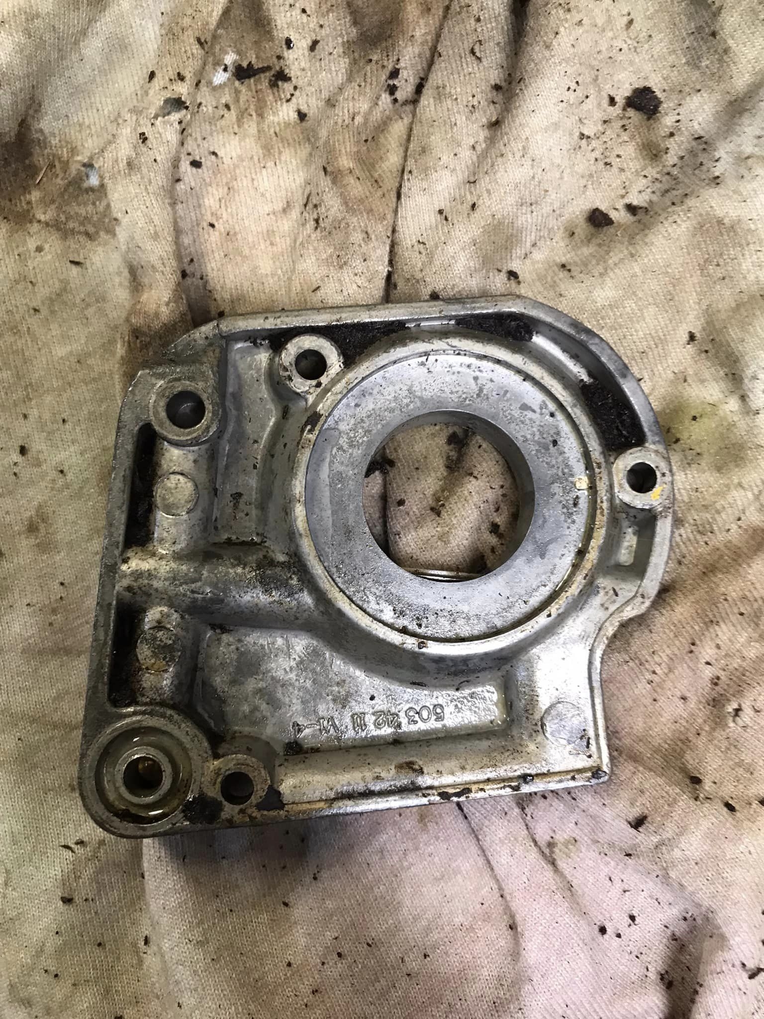

Always weird when getting out of state calls for parts from folks I don’t know even online.
Thanks for the out of state dealer that referred them to me.
Was out of NOS but still haves used for them.

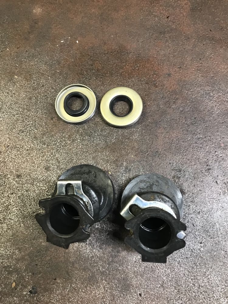

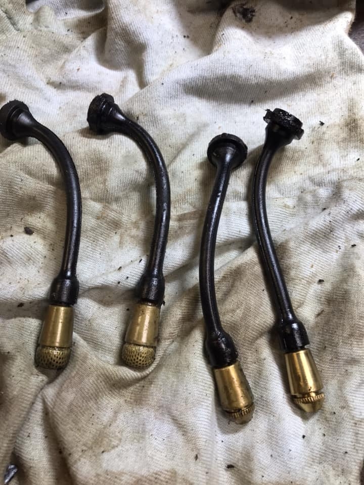

Partner made poulan giving life to the bought new partner made jonsered.
Pulled 4 lines and pick ups too. 2 ends no good since part of them came off.
Never seen the screen come off any before.

NLA parts heading out to BC :oops: . Brrrrrr
NOS seals and big intake boots for 60cc under.

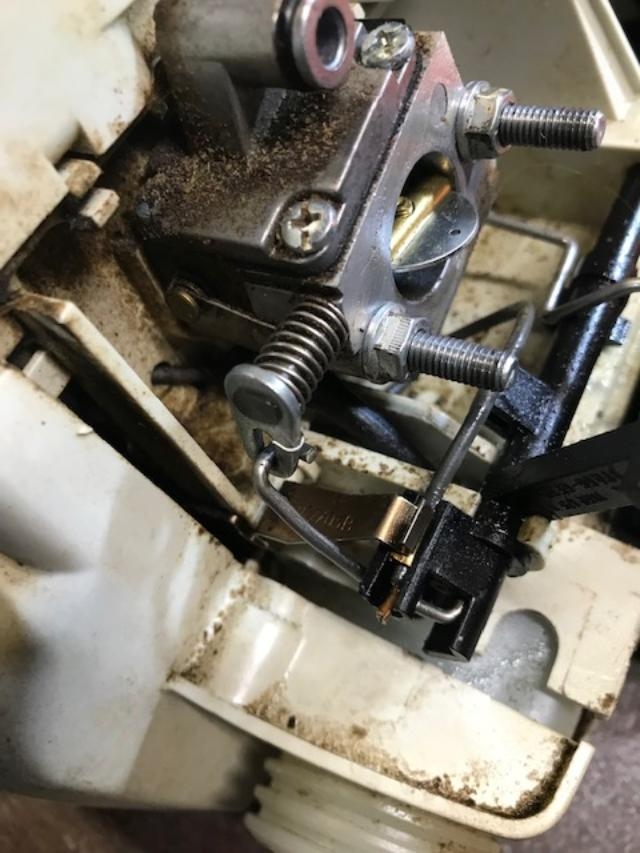

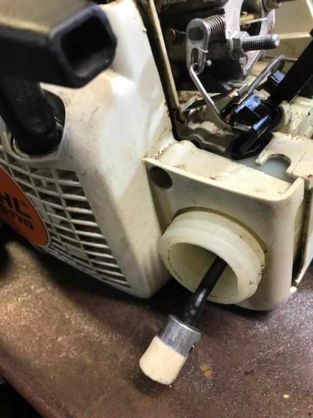

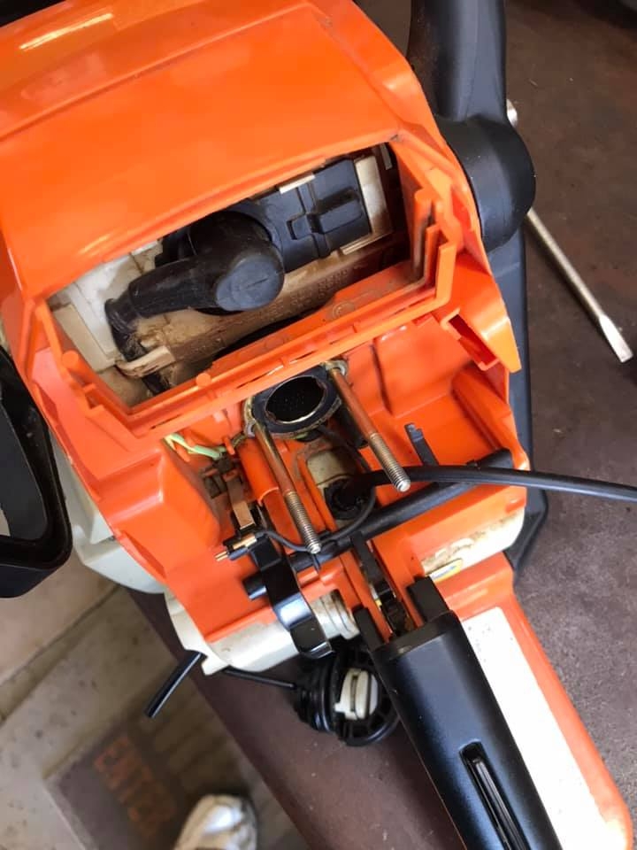

I've done the redneck echo fuel line trick in alot of different saws. Stihls mainly the 025 290-390. But this is first 170 I tried it in. Perfect. No more oem lines that just give up ghost. Never cared for the molded lines in their whole older plastic series myself.
Stihl 170. Guy never ran ethonal fuels. He always efree and also can fuels too. Stihl 390 025 170 and now 261 replaced 025. The 390 025 has been redone over the years too. Till 025 last fix was more then saws worth.
Never had one come back needing fuel lines after doing them with echo line to date.
Cool thing about this guy. He cleans his saws up before dropping off. All his saws always look like new. Just firewood cutter in late 70's.

Tygon maybe?
   / Just another junk chainsaw
#1,649
Tygon maybe?
It was stihl oem line. Tygon is crap line too for lasting. I use it only in certain trimmers since no other choice. Then also make sure it is real tygon with 4040 all on it. Not some aftermarket crap. It is even worse.
Ive done all 3 of his plastic stihls with echo line fixes over the years. 025 one the case wore out where cylinder sets so it didnt get rebuilt by me due to cost compared to getting a better saw = 261.
