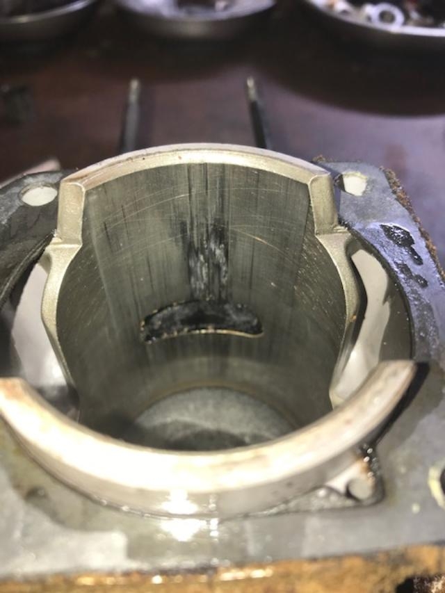

Nicer oem piston. One in it has a carbon scoring mark on ext. Pulls 160psi. But to make it nicer for next owner when I flip it.

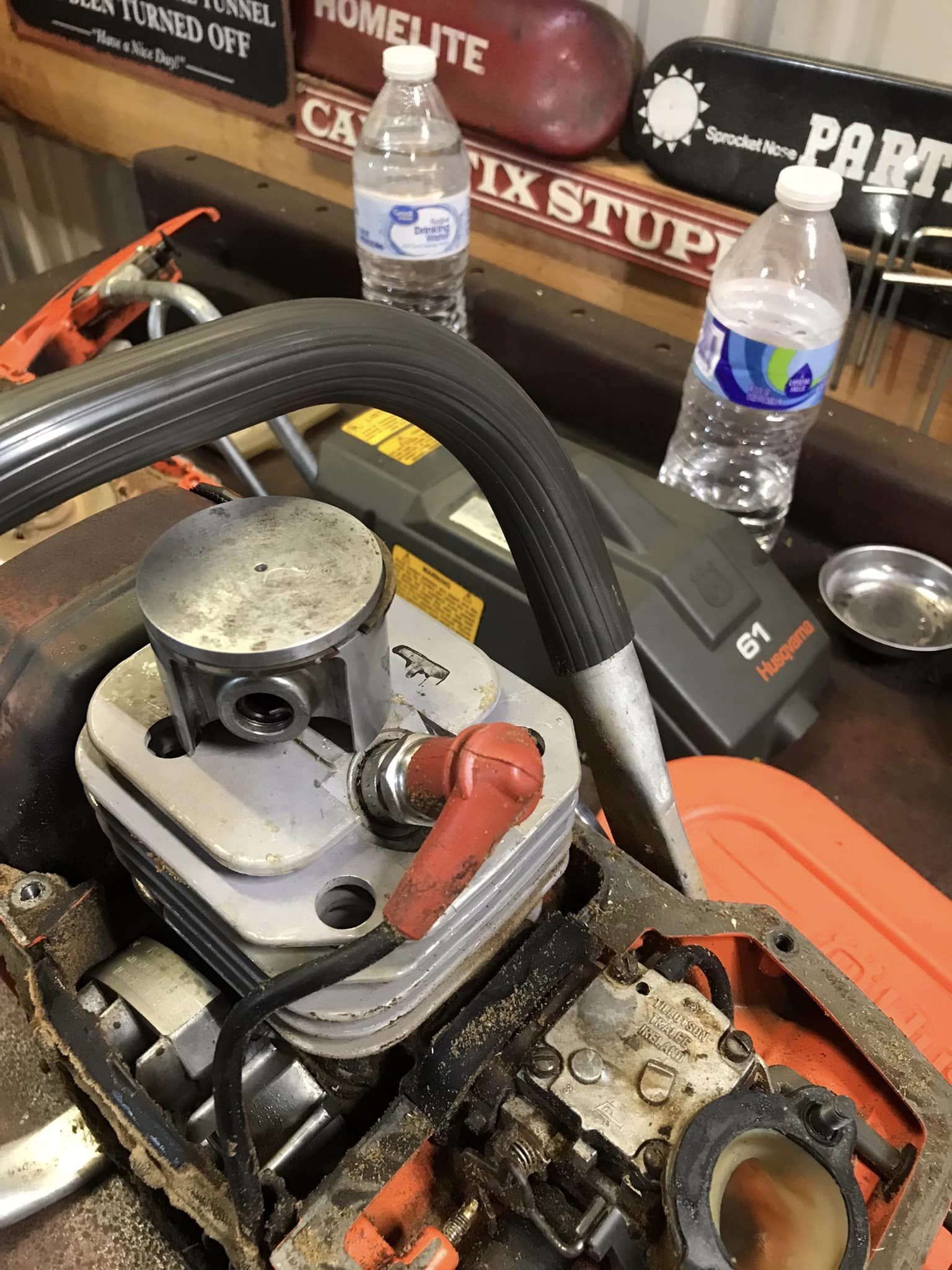

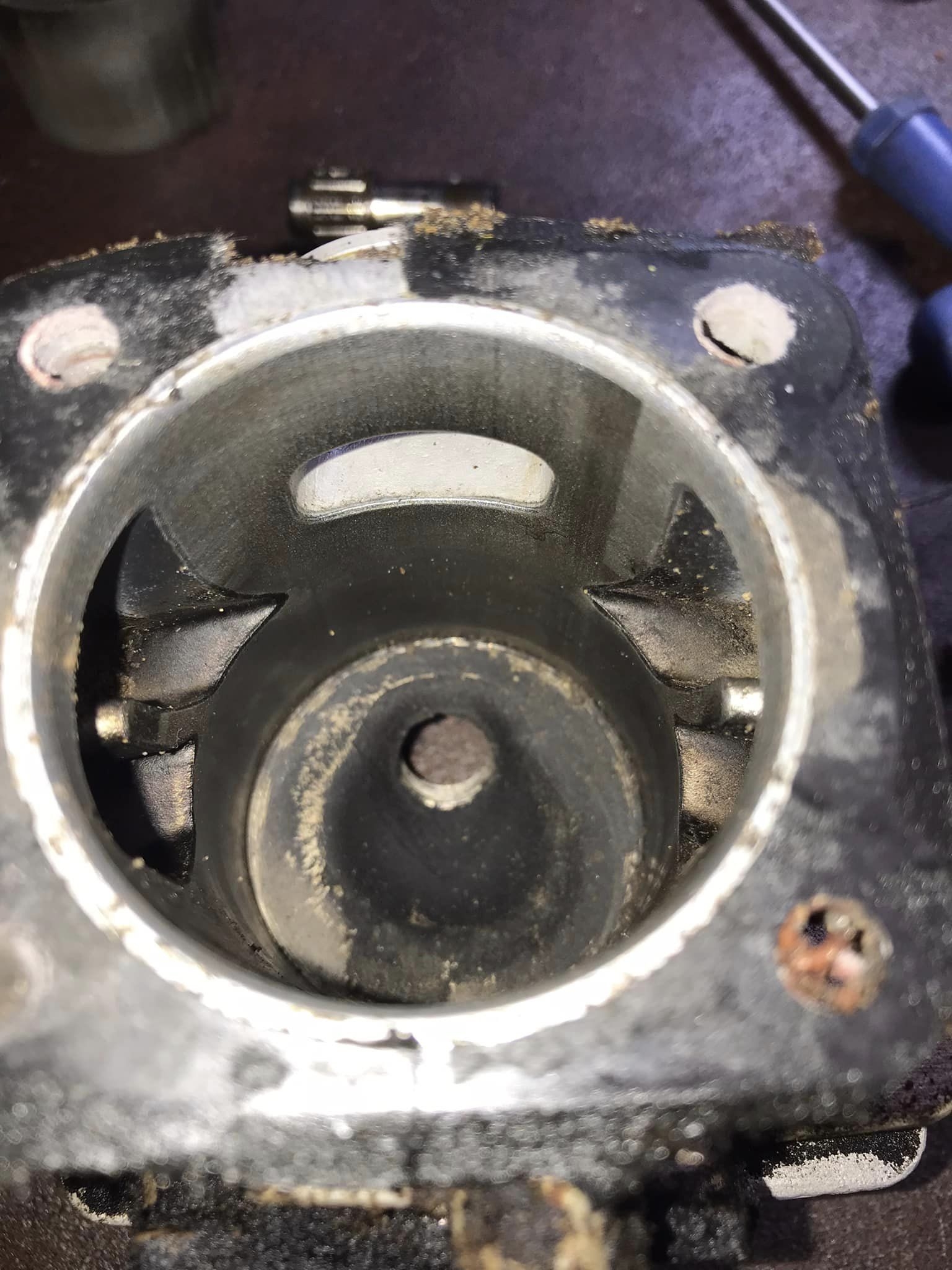

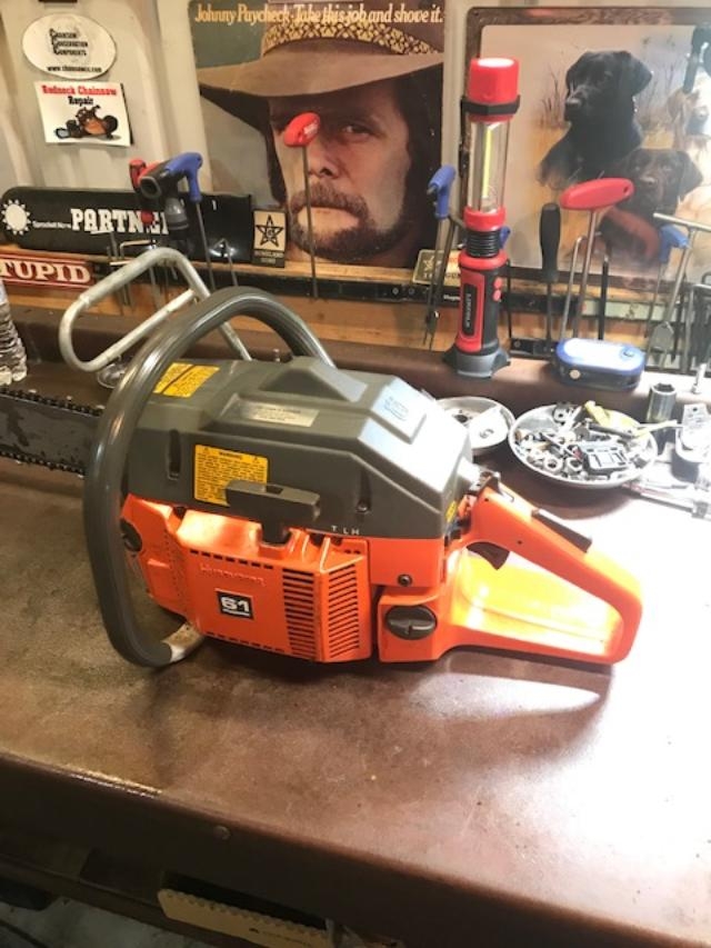

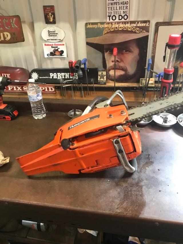

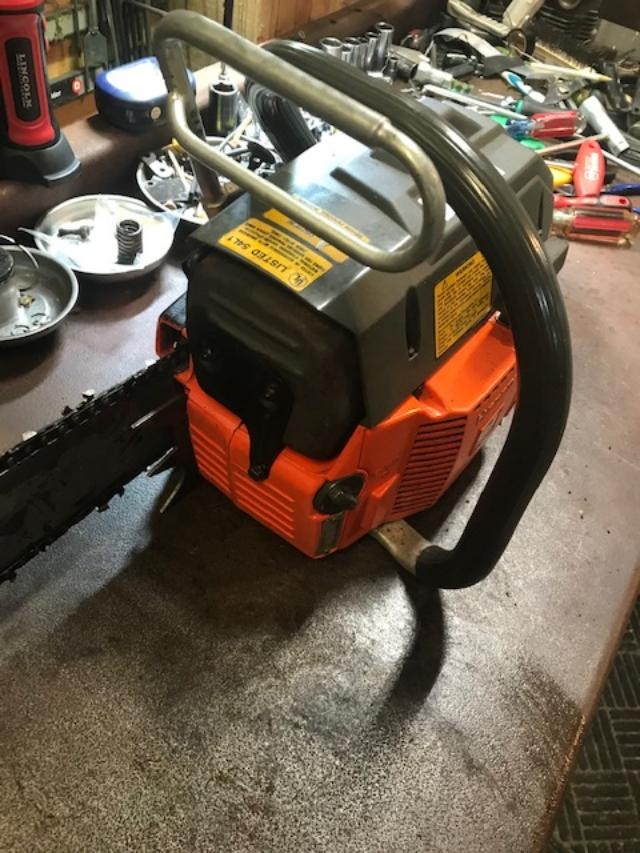

Tore down and cleaned up 61 yesterday morning.
Such a easy saw to work on. Like working on the 60's cars I had.
Before after cyl.
   / Just another junk chainsaw
#1,723
Started right back up too.

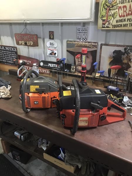

I expect the closed 50mm Gil2 50mm 670 champ to just walk away from the 61 open 48mm K&S. But will be fun testing anyways.
Owned all the 266's 268xp 268 272 66. Just never a 61 as wasnt a saw I wanted. But this 86 one was to nice. So going to find out.
#1,725

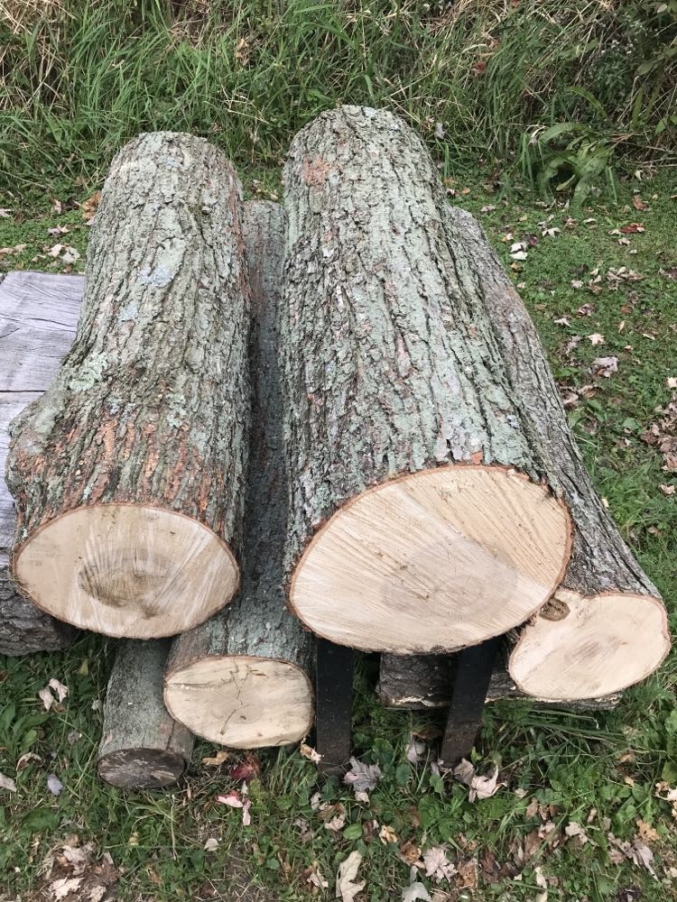

Went how I figured. Both stock. 670 has gill muffler mod both sides. 61 muffler has a inner baffle and notta done.
I don’t want to cut on 61 muffler being I am going to sell it.
6.5's J to mid 8's H.
They all would get the job done. Not a race cutting firewood.
12x13 round used, one on top

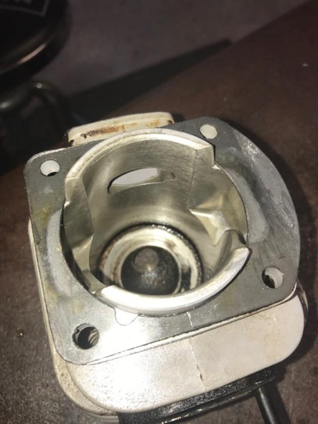

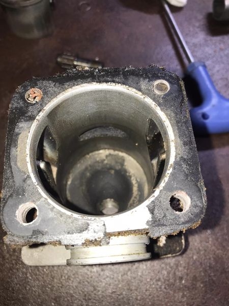

Wanted to see what the cylinder looked like under the dark stale mix coating inside cylinder. Nice bore under there.
Poulan 365 60cc cylinder before and after cleaning.
Didn’t even need my first 2 steps. Just did the 3rd one with fresh crosshatch.
