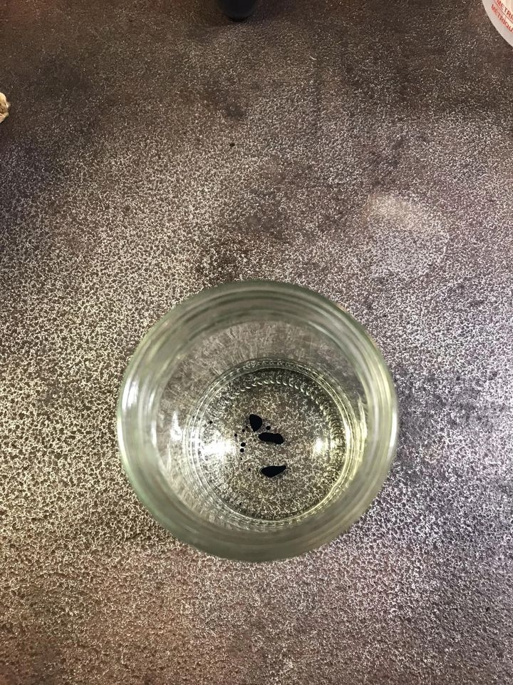

Yep both my stations has it's own pump hose for the E-free gas.
If not you pump a gal or so in truck before you do. Just common dang sense.

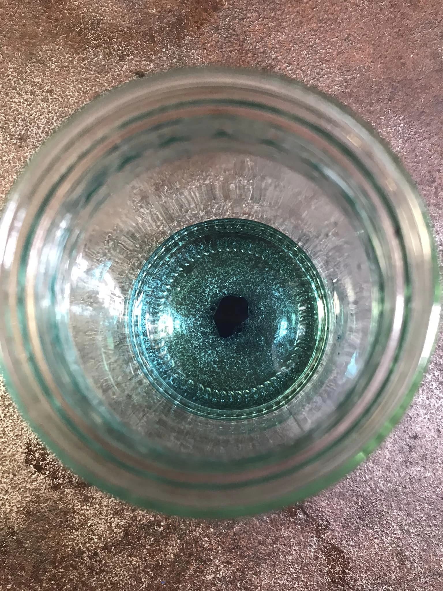

Like I have shown simple few min test to make sure Efree is always efree. ;)
More common sense. ;)
Gee wiz look how easy. Less then a min.

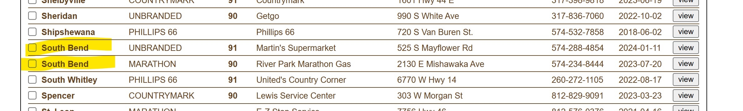

I only know of one non-ethanol serving station in my area. It is a separate pump. I know of several in Oklahoma. They had separate pumps as well, but their's also had several octane choices. Ours only has one.
FYI, this site lists 2 stations. 90 and 91 octane, if accurate, you got the good stuff.
The first one is the one I was talking about. I've been going to that local chain since I was born for groceries with my mom. The cashiers used to give me one of those suckers with the loop sticks. Grape! 😛
The second one is in the next town over.

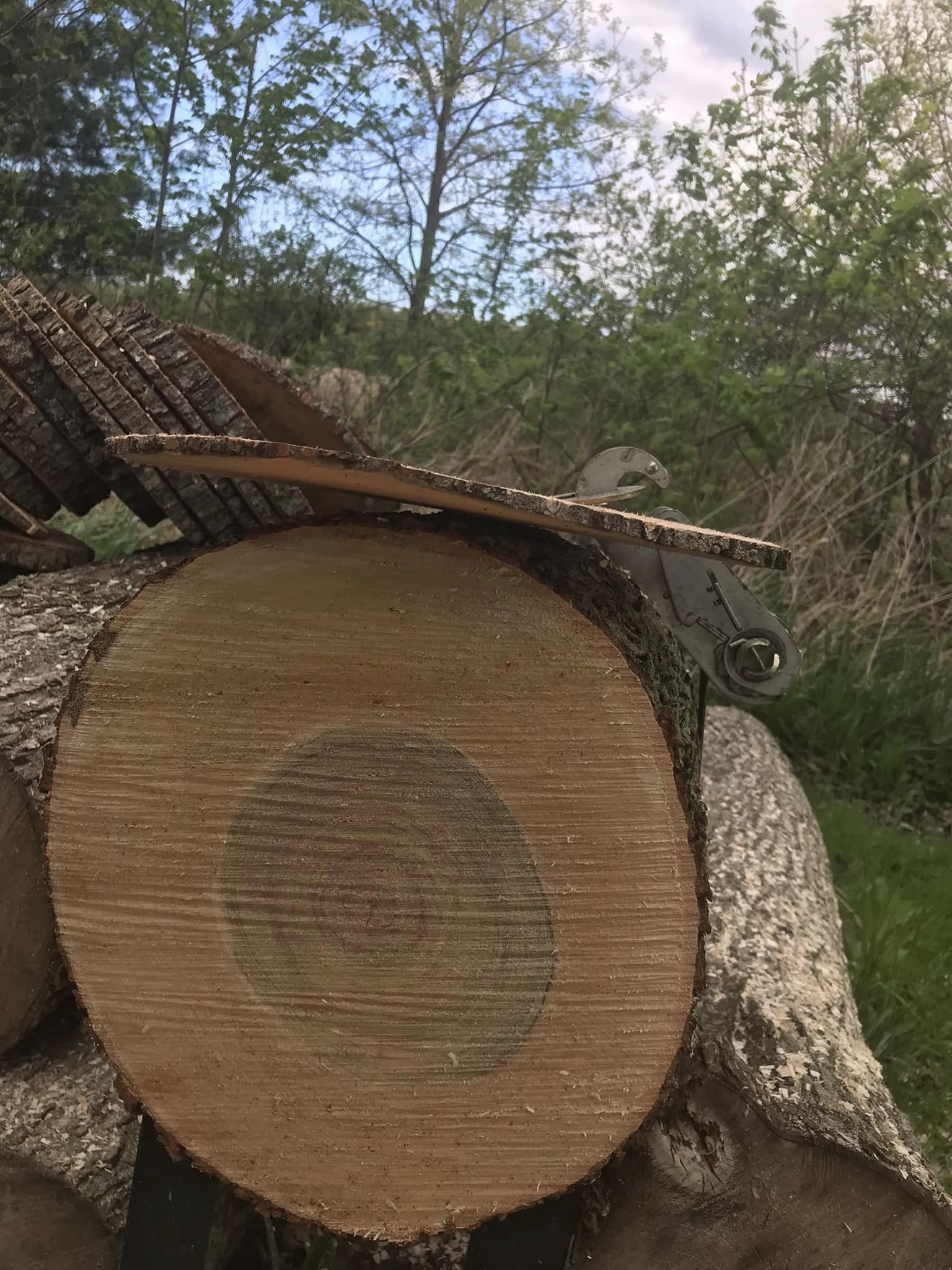

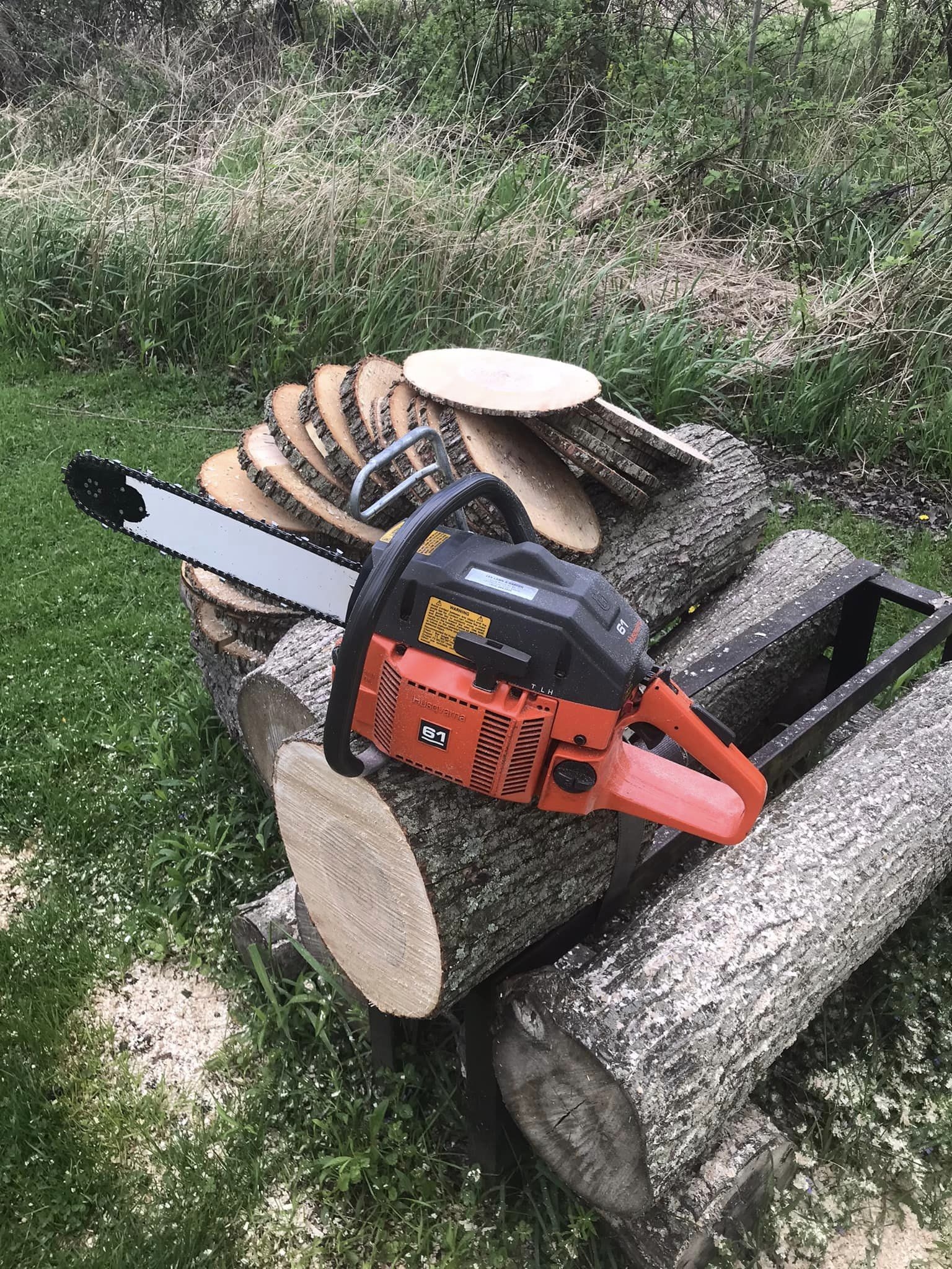

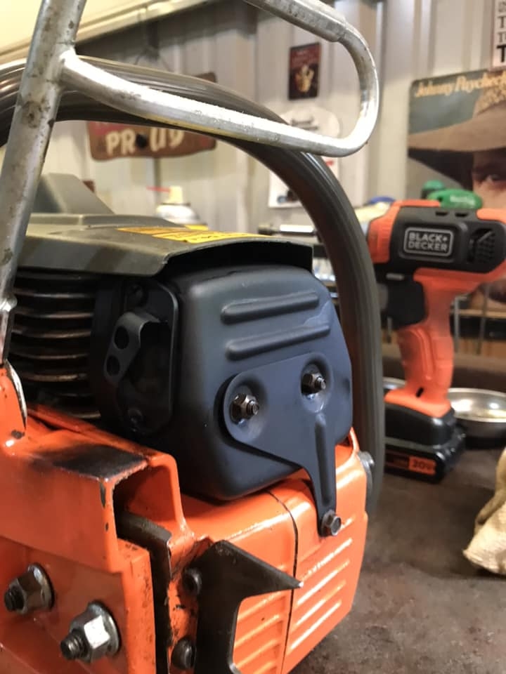

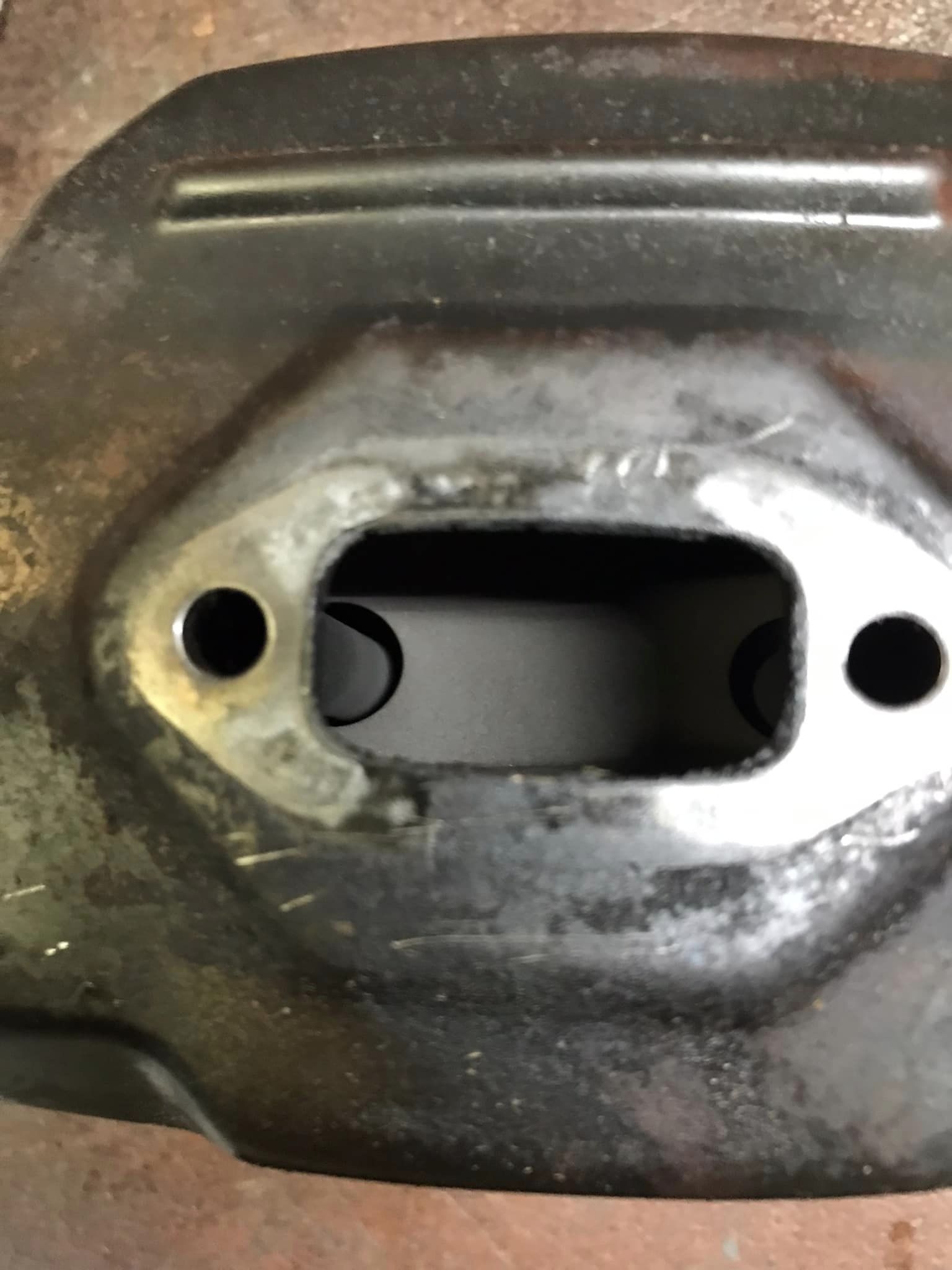

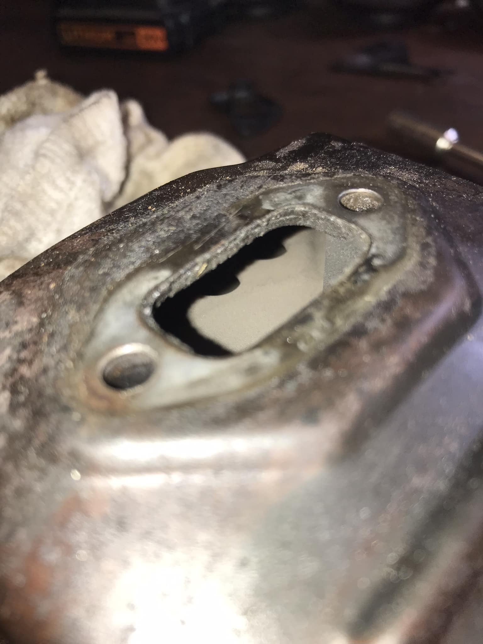

Thin to win right.
Last cut surprised myself I didn’t cut out.

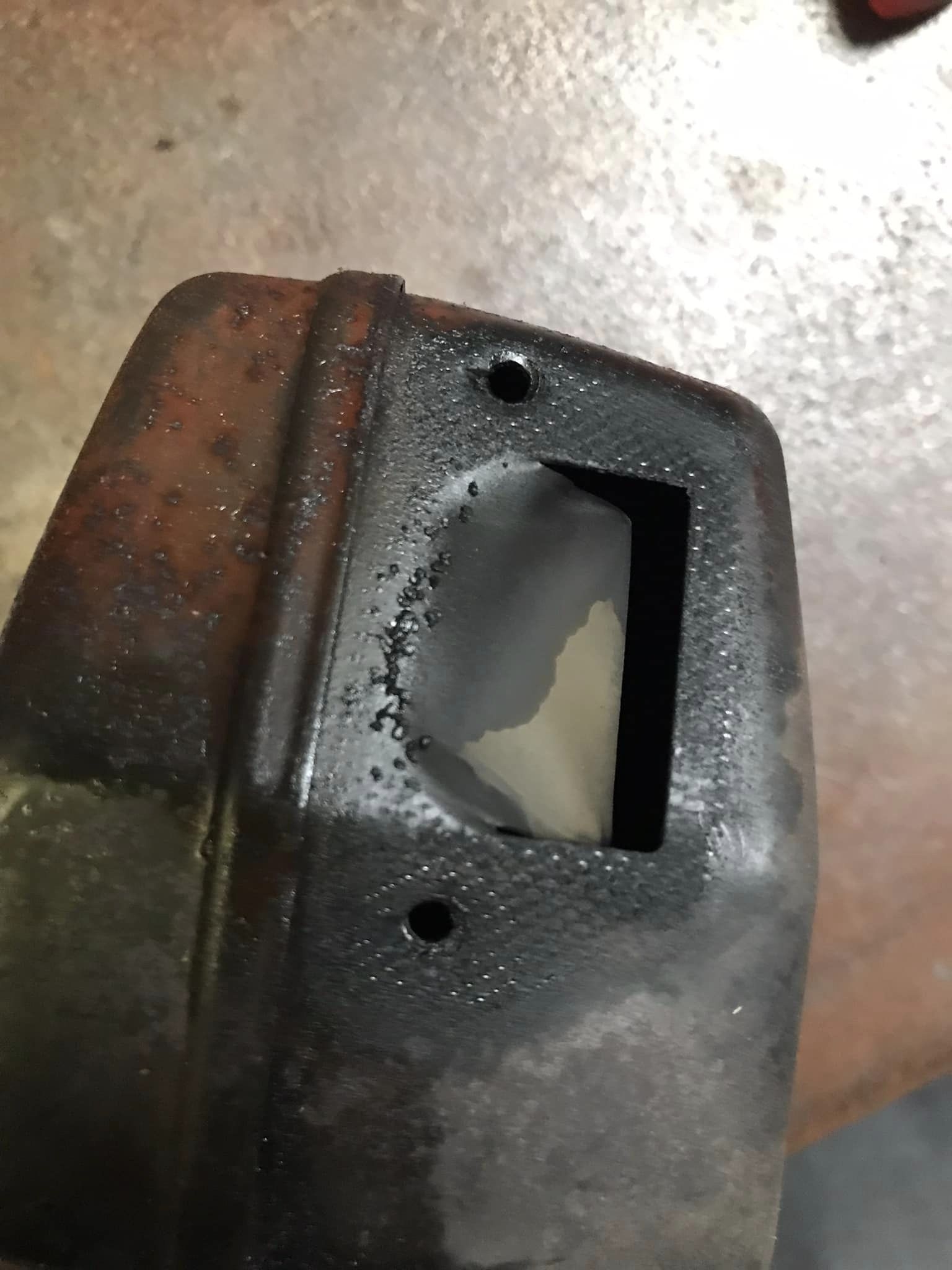

Even opened center baffle and opened the closed exit they did on these. Like they were purposely killing the flow out. 2 small holes at bottom of baffle to go through. I did just enough as I like them to look stock still.
Not with a 61 you won’t. Runs like a open port 60-62cc saw.
Surprised they were doing that crap even in 86.
   / Just another junk chainsaw
#1,737
Gave it a quick coat of black rust reformer. Since out of my bbq high heat black.

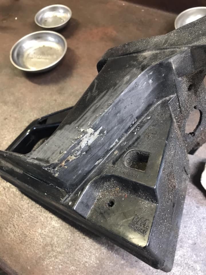

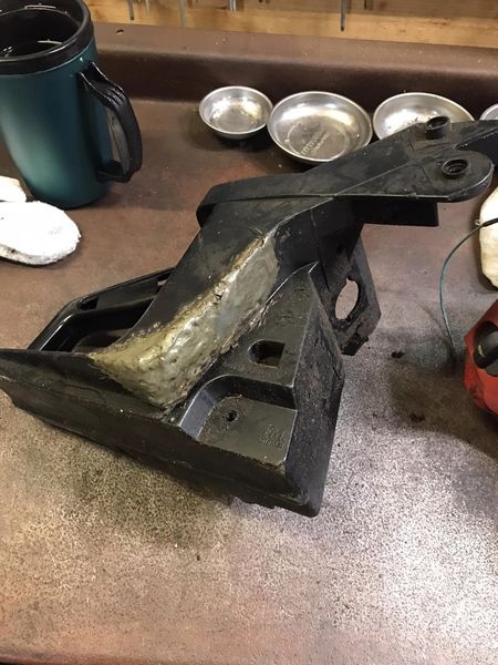

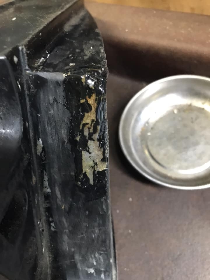

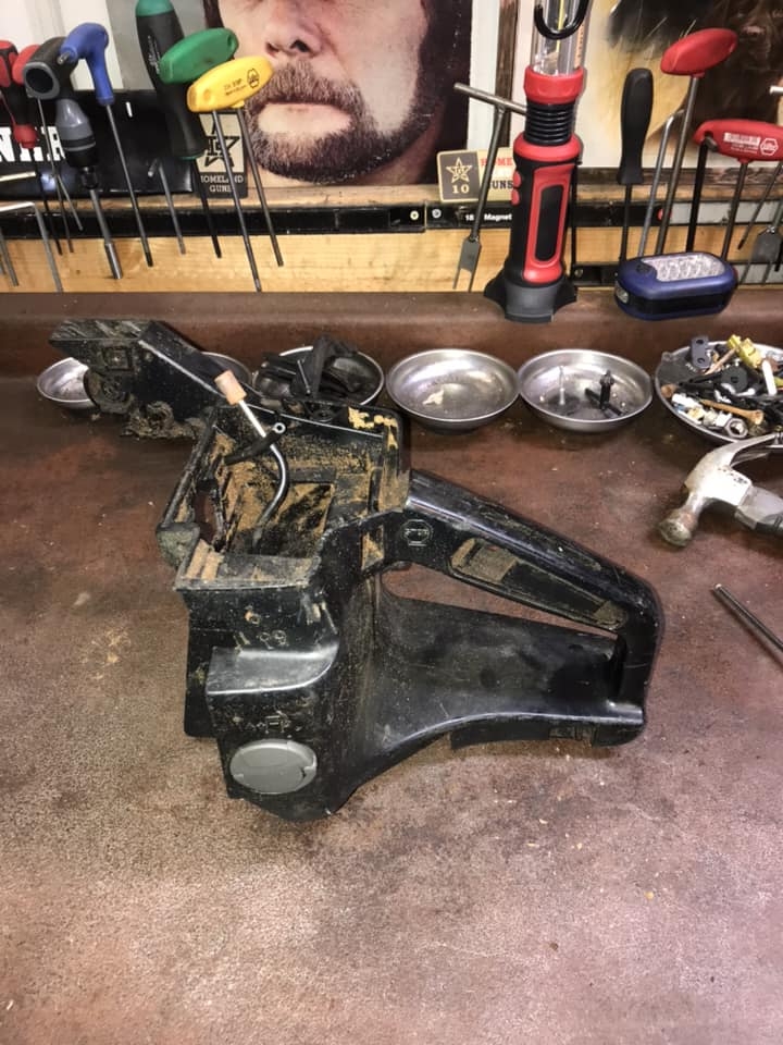

Folks and their jb weld fixes.
Trying to save this NLA Gen3 tank. Chip and grind and sand away the mess.
SealAll is what I use for this type of fix.

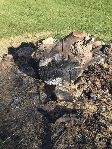

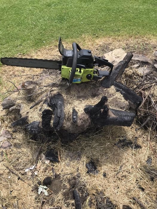

64cc poulan 4000.
Guess I didnt post it here. This was with a regular chain I sharpened that was a chain I pull from stuff coming in that I wont use for regular cutting. I call them my crap chains for root cutting. 70dl set up.
Ended up ordering a stihl carbide chain from friend and breaking it down to drive link I needed.
Man I am impressed with carbide chain for dry dirt encrusted root ball stuffs.
74dl broke down to 72dl.
Showing how far regular chain got before begging to be sharpened.
