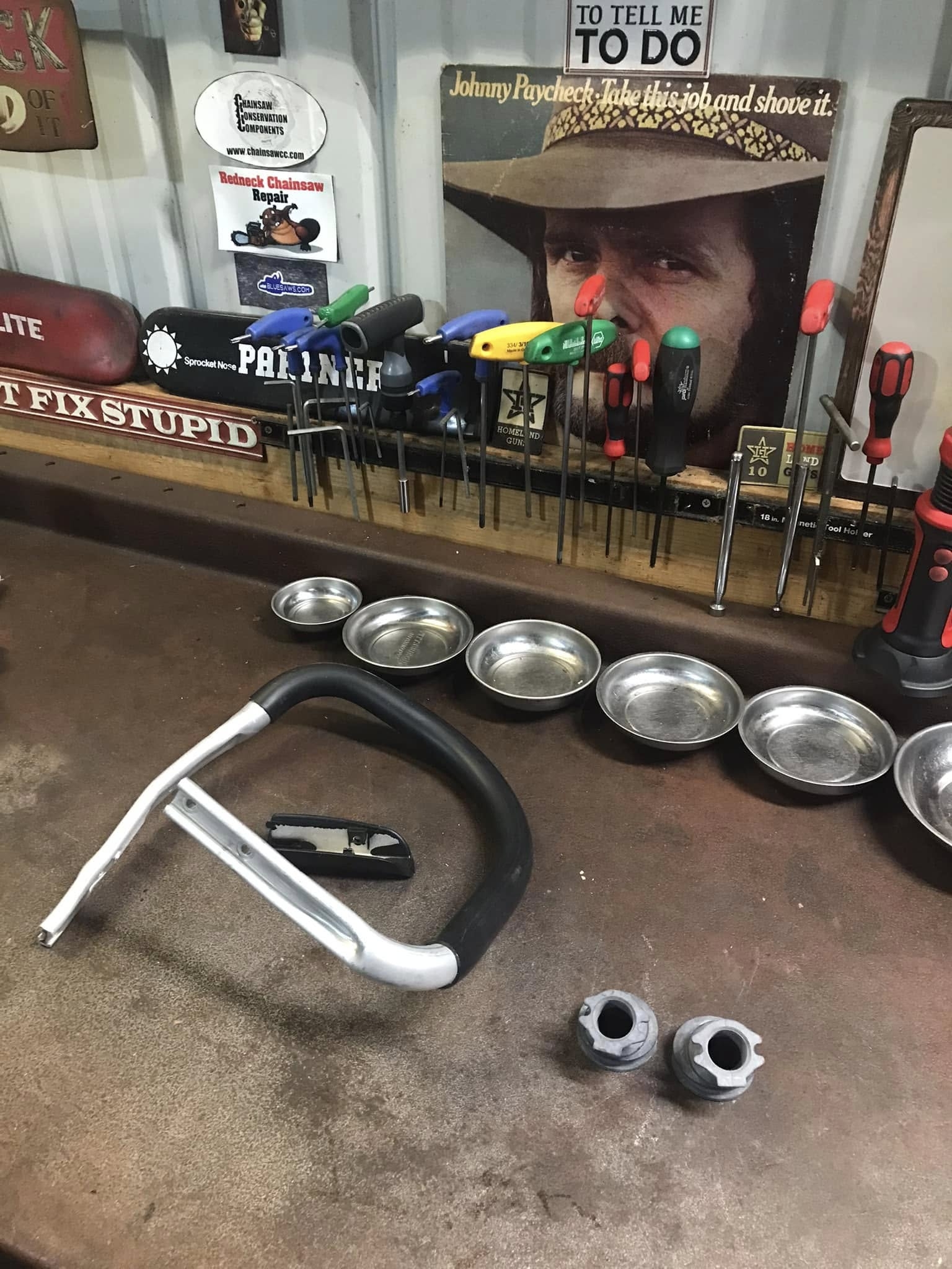

New 501 metal with rubber coating 2 piece kit to replace the cheap plastic crap that comes on 4910 490.

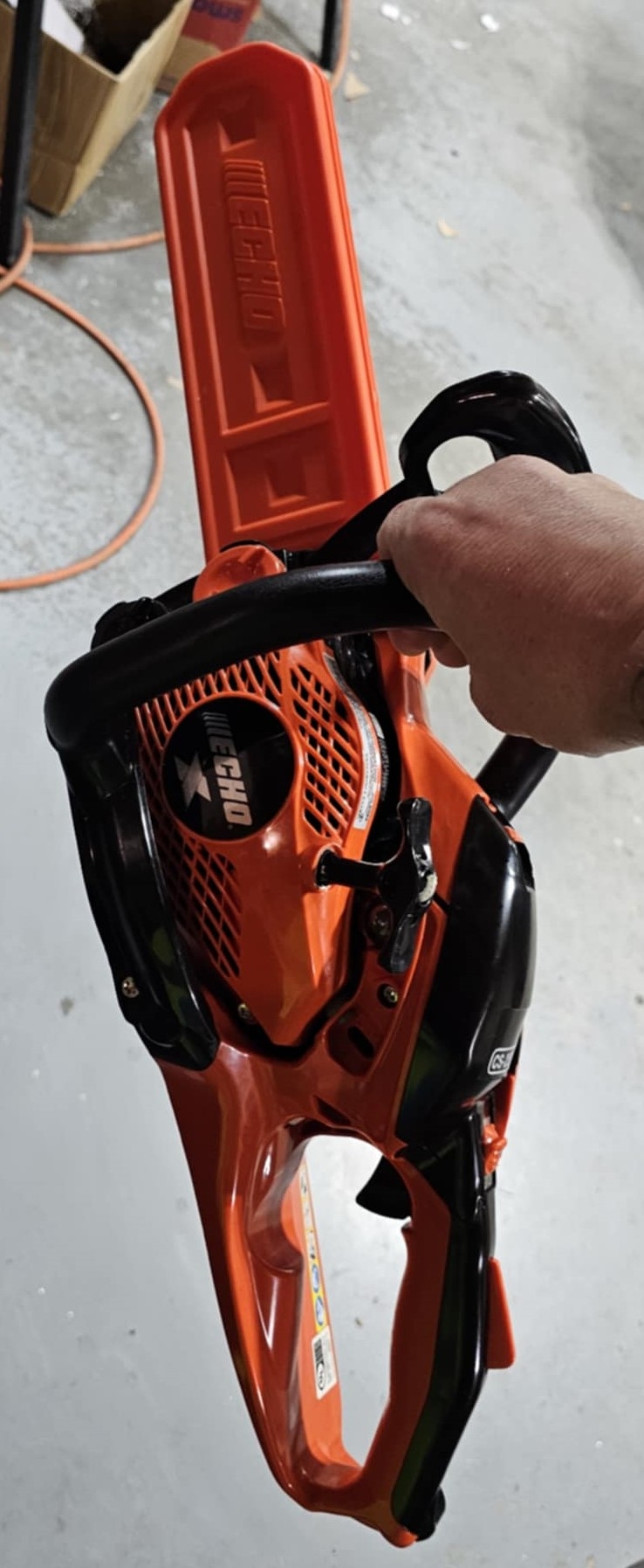

Dang the new 4910 isnt even here and a guy wants to trade me a new echo 2511PN for it.
Hmmm Dont really need a 4910 and rear handle version of 2511 to go along with clone 2511 be nice.

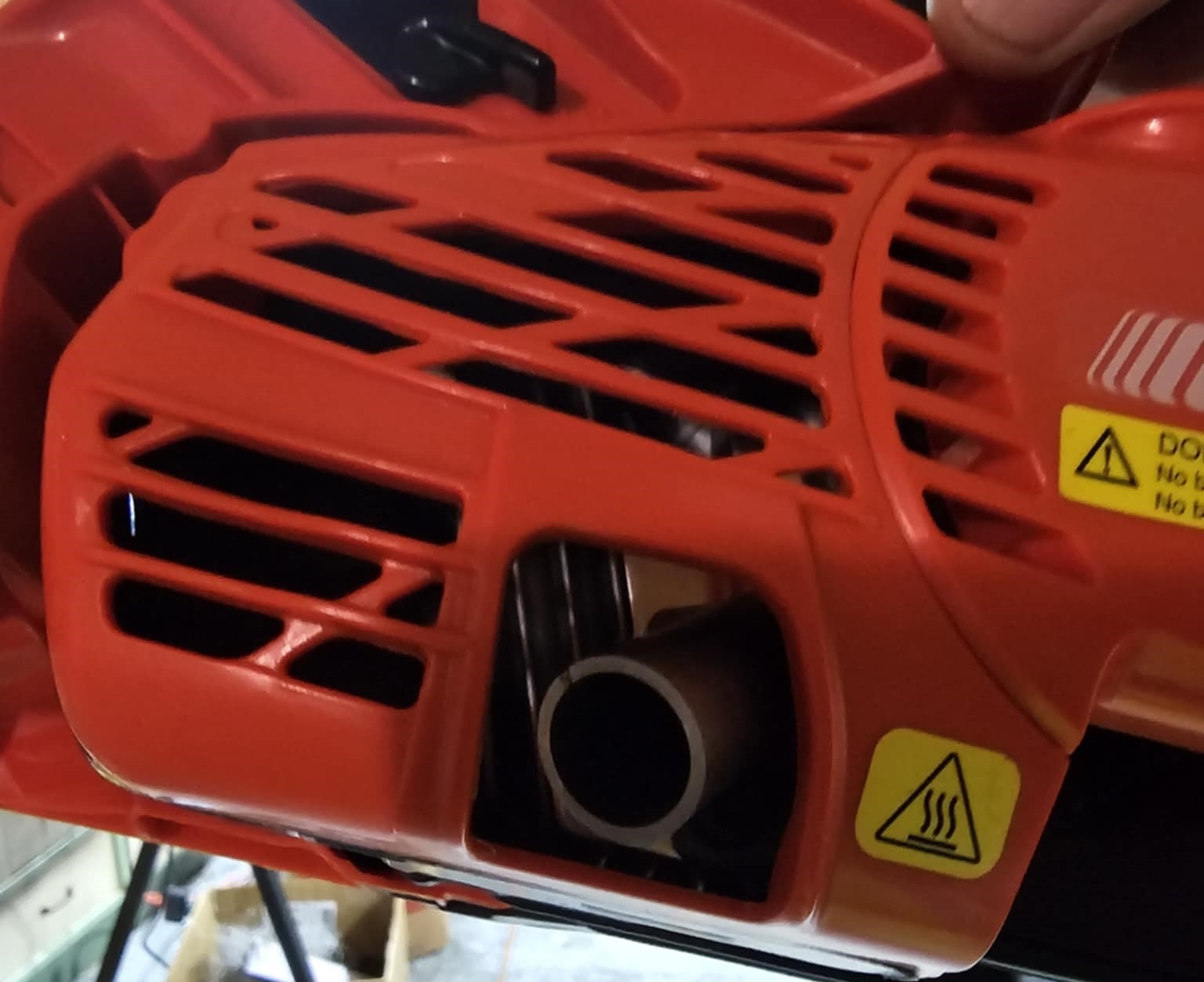

Plus side he already put a Egan pipe on it too.

I have a 2511T with the Egan pipe. It's an absolute screamer of a saw. I cut a lot of wood with that thing just because it's so dang fun. It would be a tough decision for me considering the 4910 and the 2511T are two of my most favorite saws.

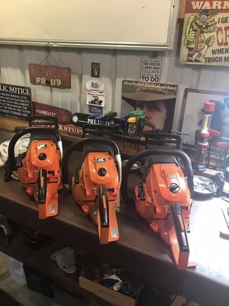

I have 2 501 muffler modded and a echo 490 ported already and a clone 2511 TH.
I am sort of leaning toward the rear handle 2511.

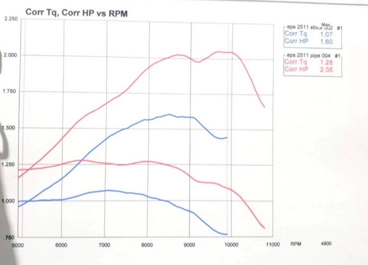

With that pipe on it is better then some guys port job and their muffler mod.
I did a thread on a bunch from dyno runs. That little pipe alone is most of the gains made.
Some using stock muffler but opened up and ported cylinders. Didnt gain as much as the pipe alone.
