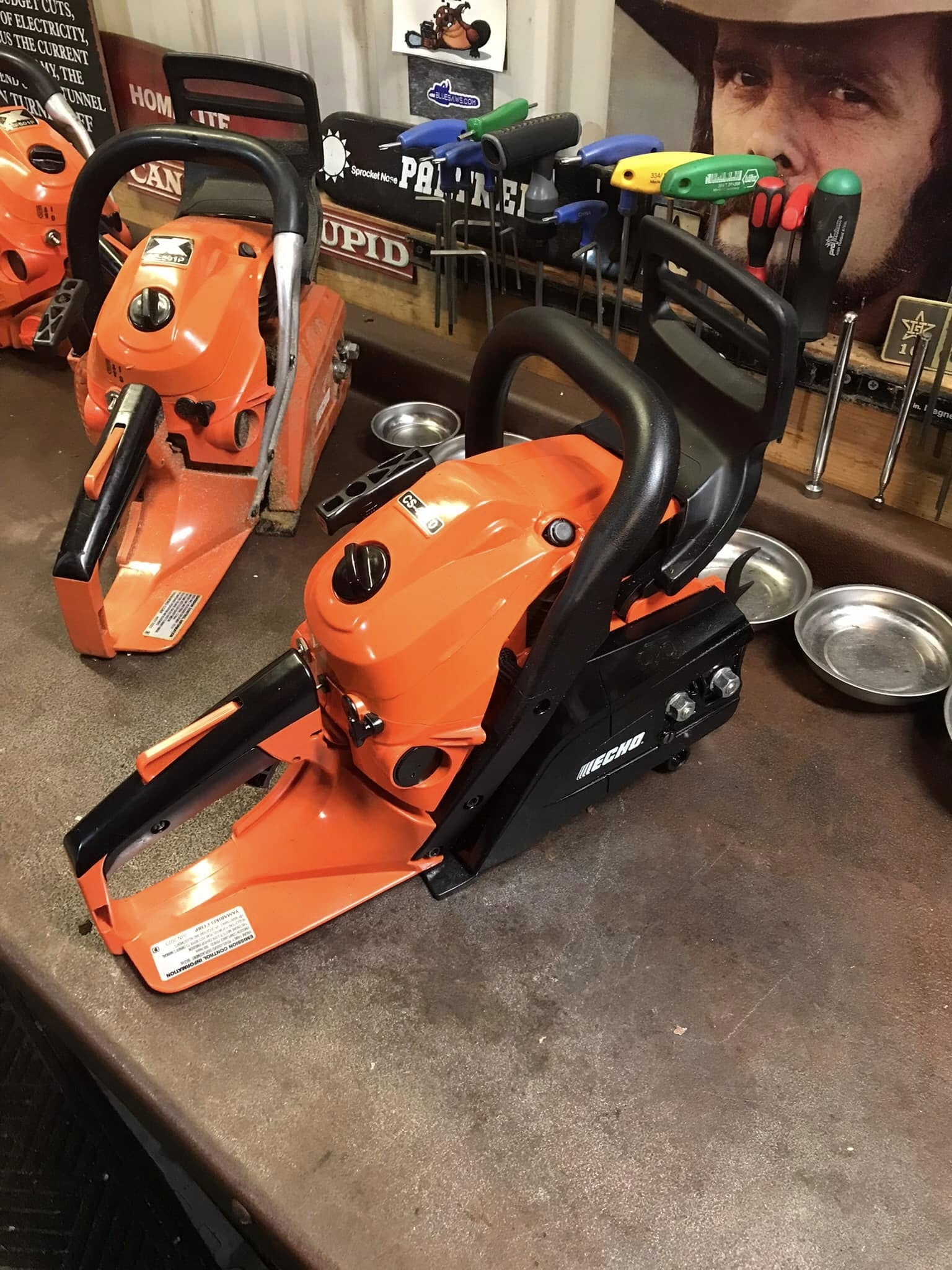

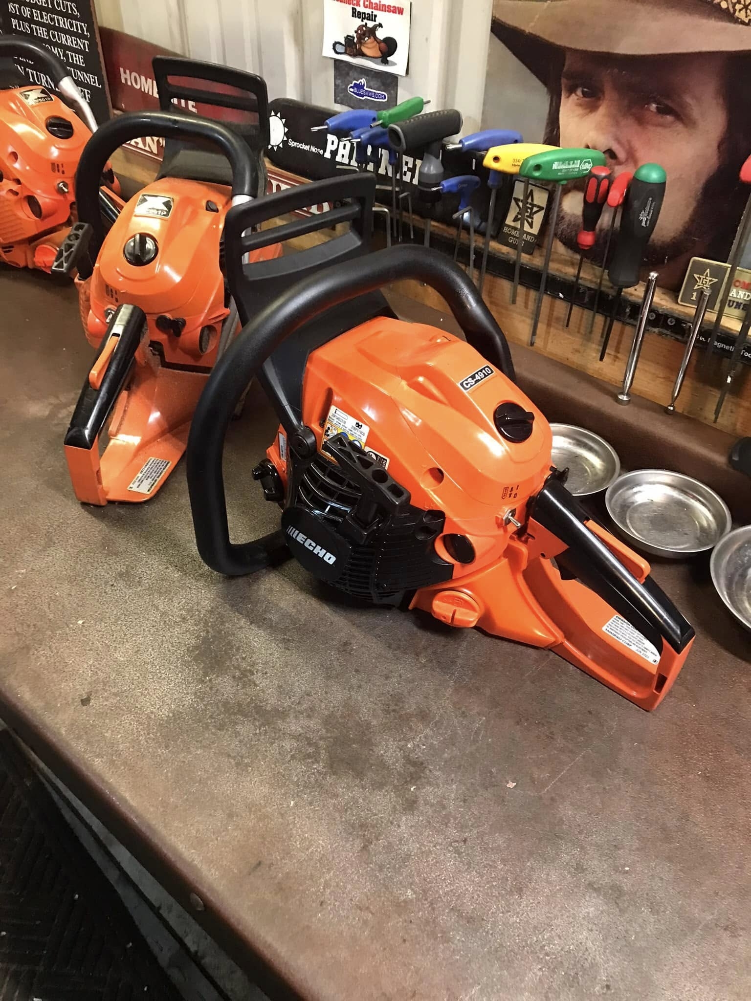

4910 I took on trade to go with the 2 501’s and hack ported 490.
Swear never even made a cut before.

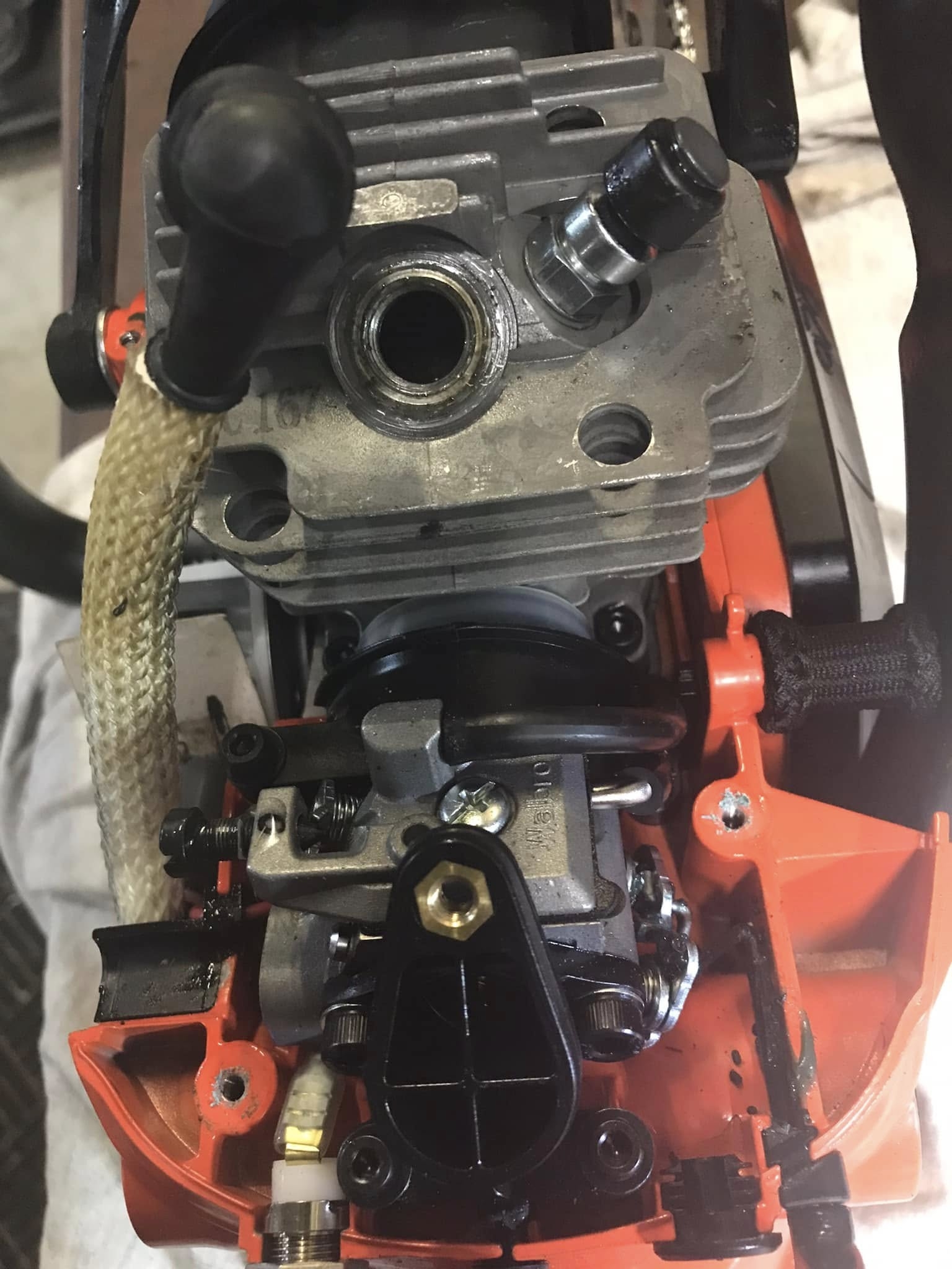

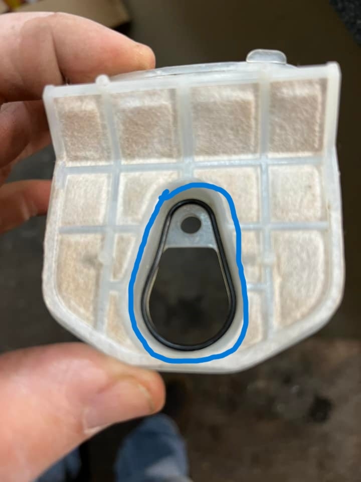

All they need to keep fines out is this nickle o-ring. You can add grease to base of af mount too but didnt see a reason to to date. Been doing this on these since 2022.
So one going in right away too.

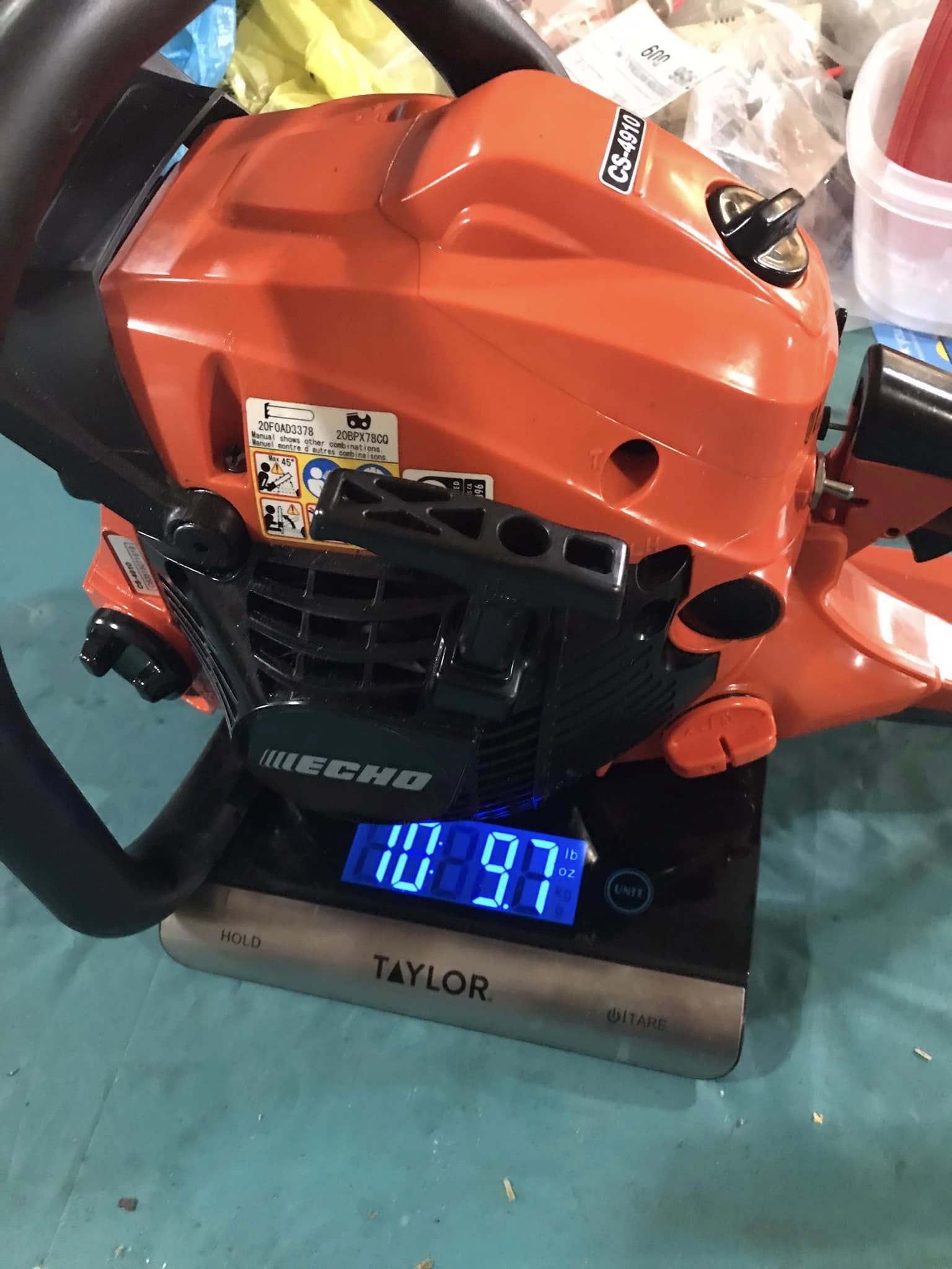

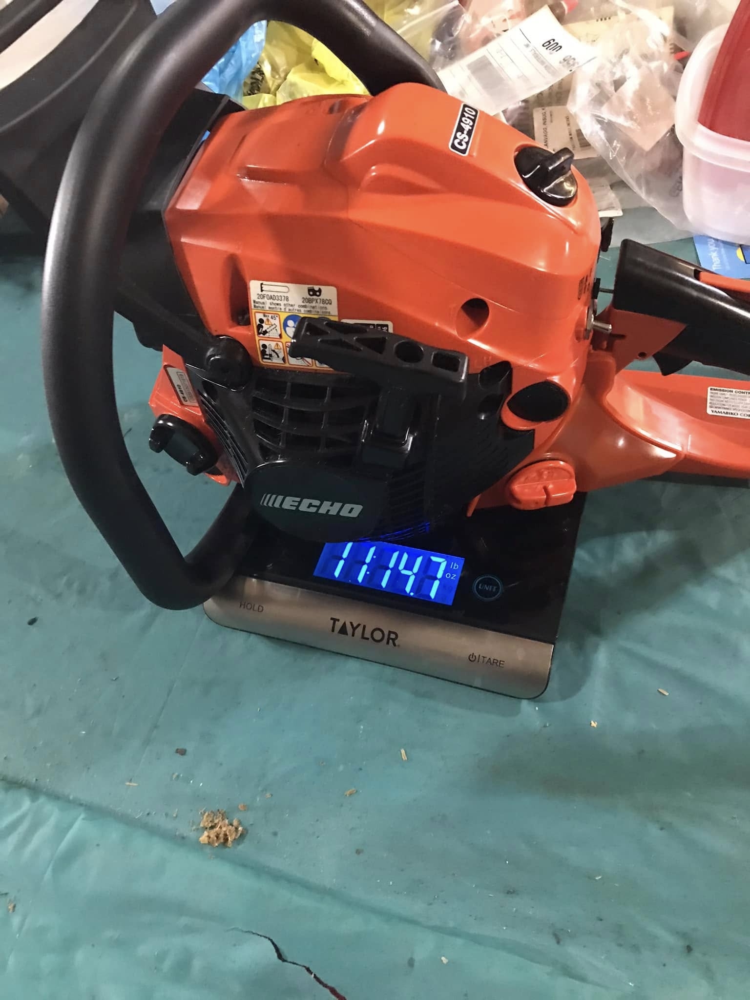

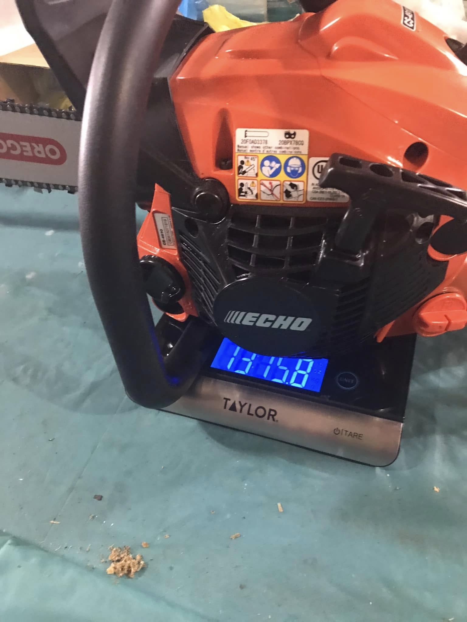

Echo 4910 PHO weight dry and like new clean.
The both tanks filled up PHO
Then both tanks filled up and 16" oregon versacut 325 050 C33 chain.

#2,017

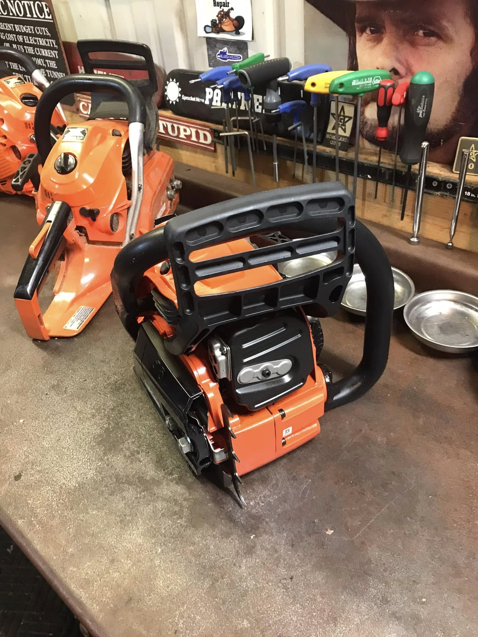

4910
Tune was so off from factory again. Idle 4400, lazy bogging L Side to lean. H to fat in Mid 11’s again.
So a real Turd if someone bought it to use. As is. Smh.
I’ve had 2 now I would throw if tried to use the way they came. Horrible not usable at all.
   / Just another junk chainsaw

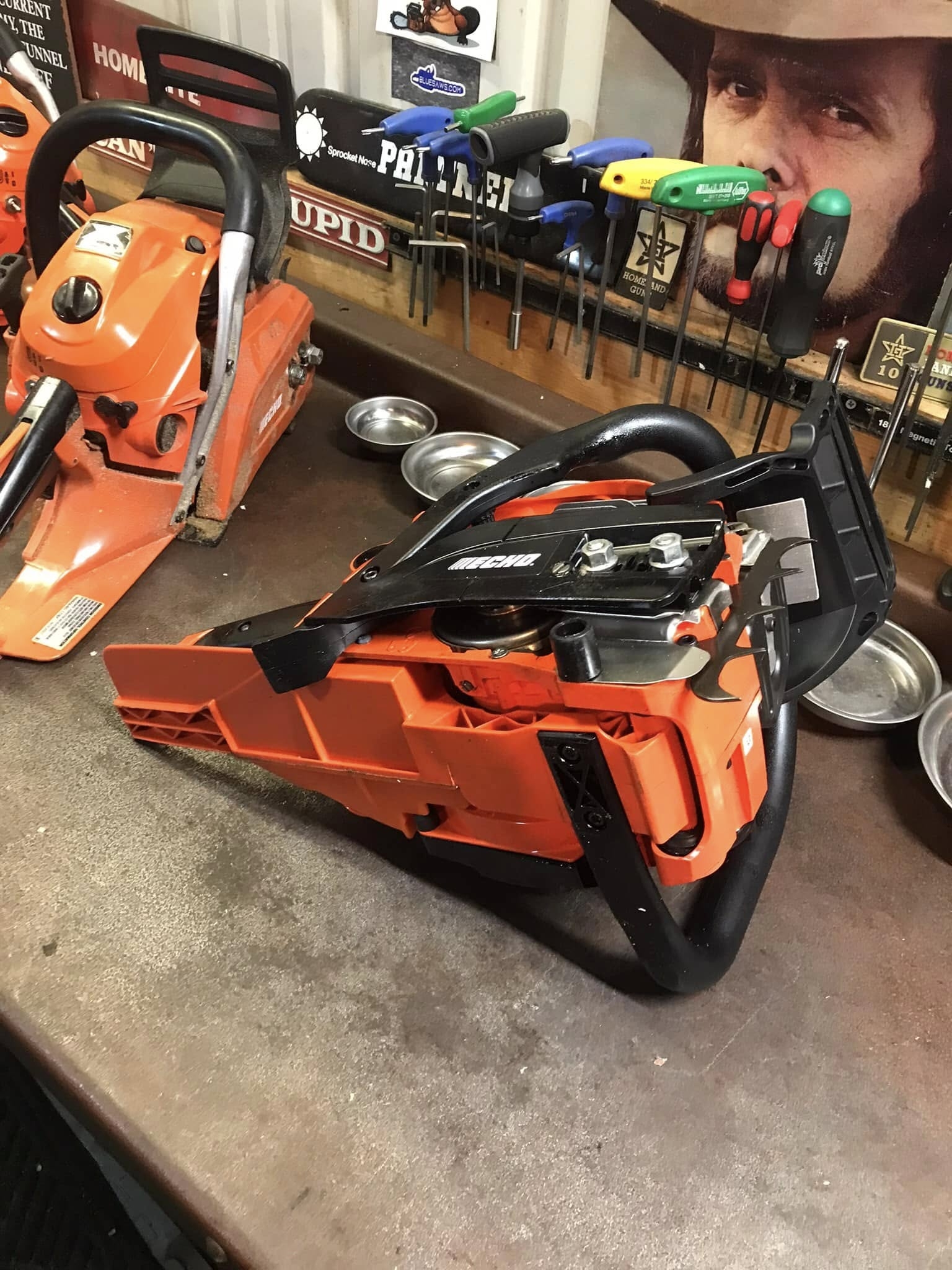

#2,018
Others with limiters still on I could tune right. This one wasnt happening the L was so off.
Pulled the plastic stop to get enough L for tuning. The muffler mod and tuned to 13.5K with H.

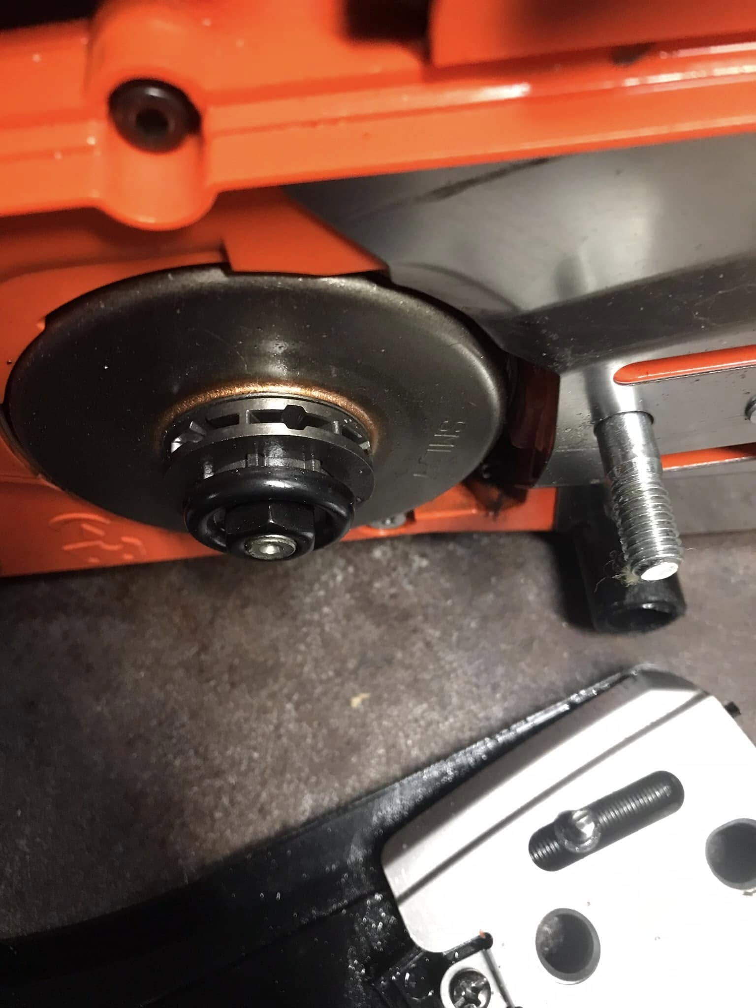

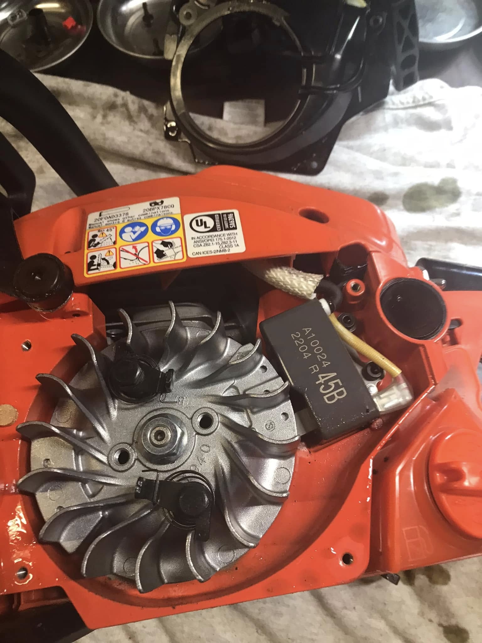

Went and picked me 5 extra fasteners for the top av’s on these things.
They keep getting impossible to get out. 2 out of 3 now.
I've stripped hex 2 out of 3 now. 🤦‍♂️
Try putting a dab of lapping compound on the tip of your hex driver. Works for Phillips head screws too.
Patrick
Worth a try but dont know if it will stop the tiny hex fastener from giving out.
4mm
