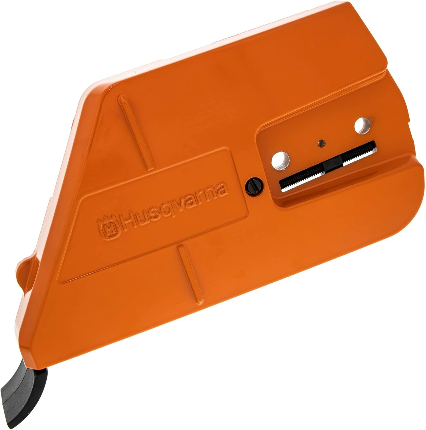

Most likely some sort of 'high impact' plastic. Saw builders today are employing more and more plastic parts in as much as they are less expensive to produce, are lighter and structurally are just as good strength wise as alloy.

How does it dissipate heat, I thought that's why pro saws were magnesium? Lighter but still metal vs cast alloy?
I understand the complexity of weld repairs, but don't think the plastic would be easy to repair either?

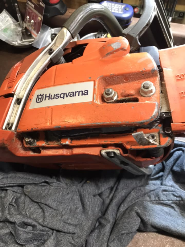

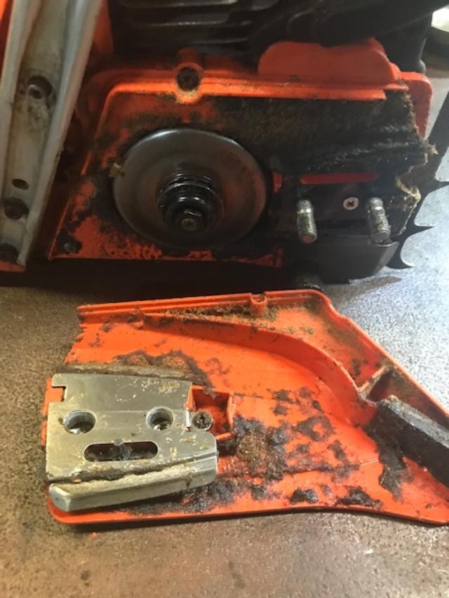

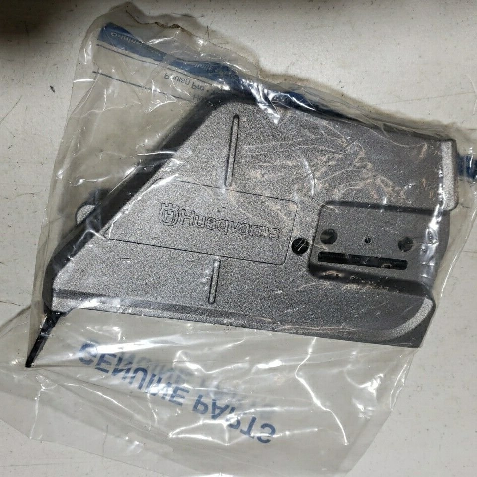

Husky covers MAG not plastic.

MAG can see paint off this one on older.

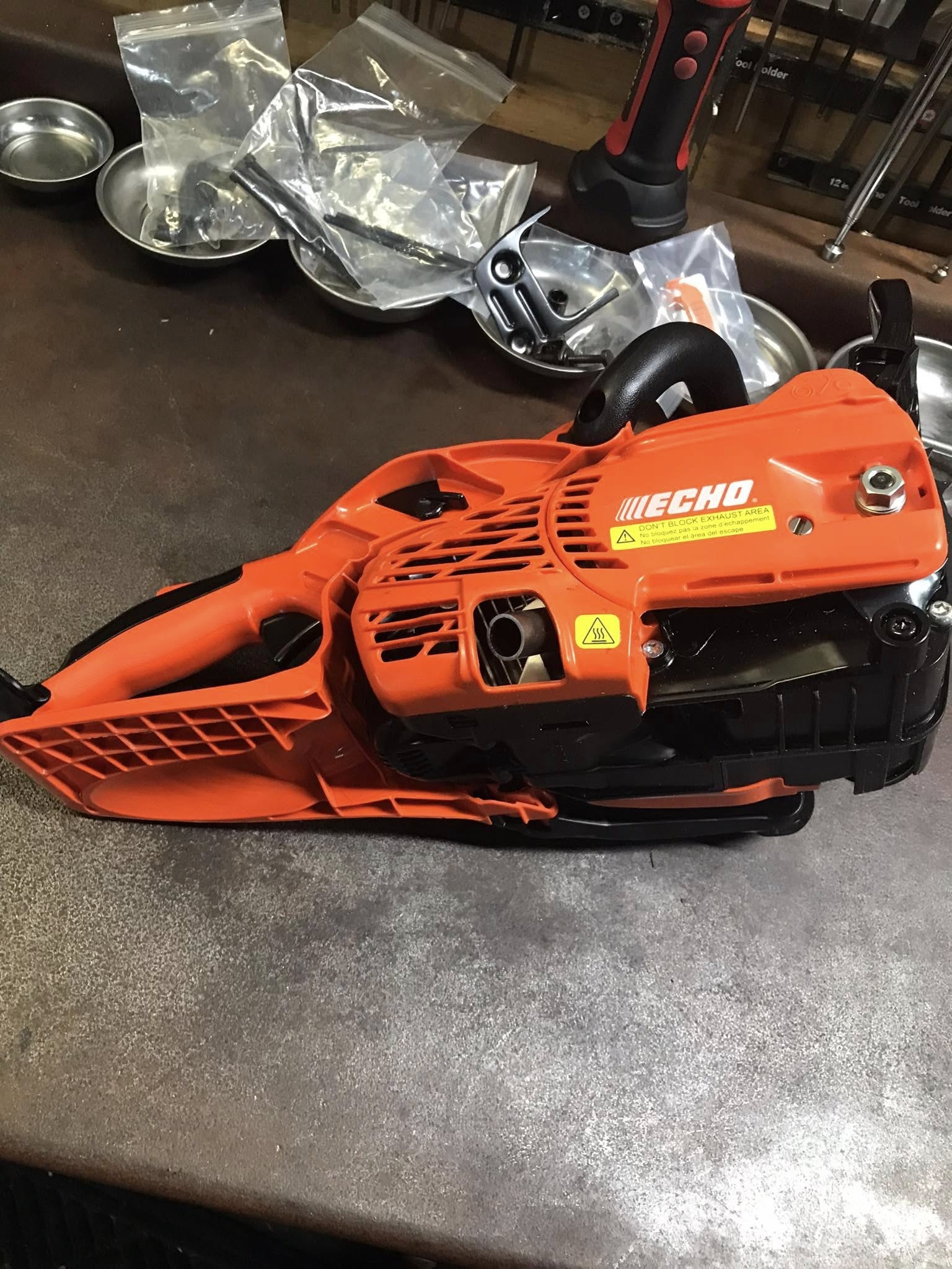

Dont listen to him. Echo uses PLASTIC
Husqvarna uses MAG metal
New ones
   / Just another junk chainsaw #2,185
Yes, Echo non-pro uses plastic. Was wondering what that cover was on the new husky since it had a very plasticky look. Expected it would be magnesium like the others.
#2,186
My pro 501 is plastic too. Wish was a mag cover.
Pretty sure my 2511PN is a plastic cover too. It is in bold lettering right on website.
