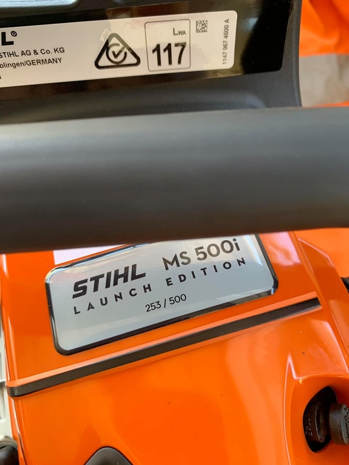

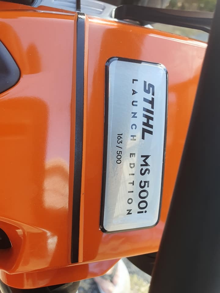

#2,173
First 500 are the collectibles of them too.

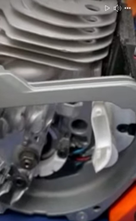

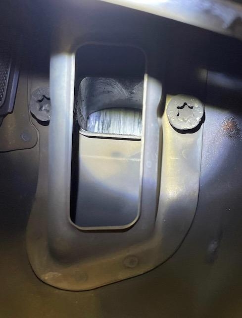

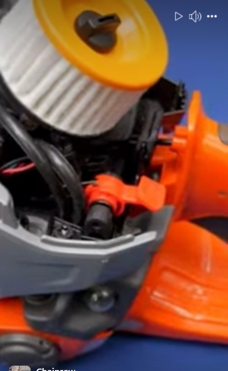

   / Just another junk chainsaw
#2,175
Pics of air filter, air injection etc etc
Can see the cutaway flywheel and xpG stuff.
