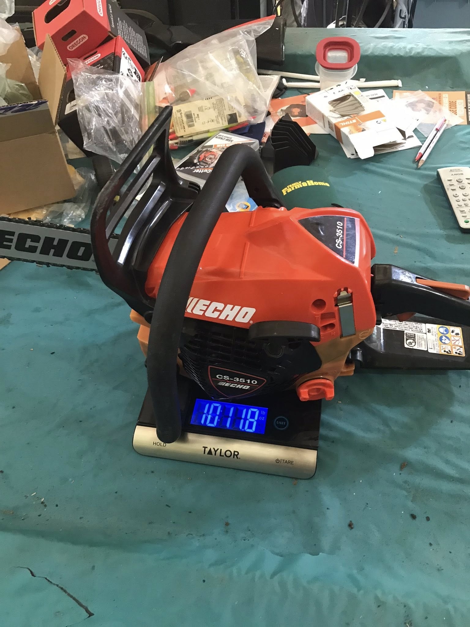

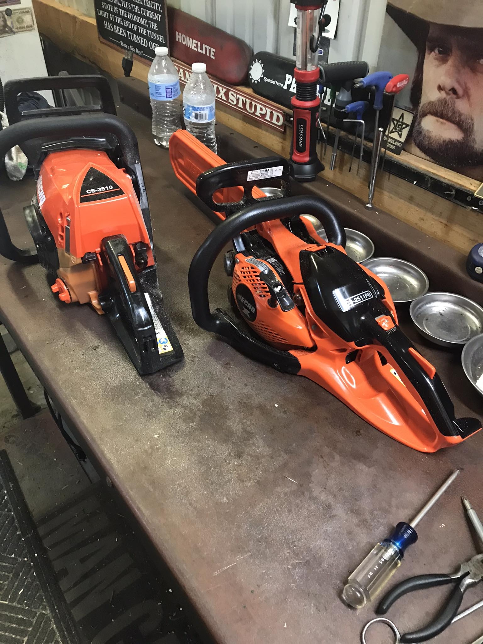

Matching up the kit. 3510.
Going with tan check side being dad cant get efree and goes through many gallons of ethanol mix.
   / Just another junk chainsaw
#2,443

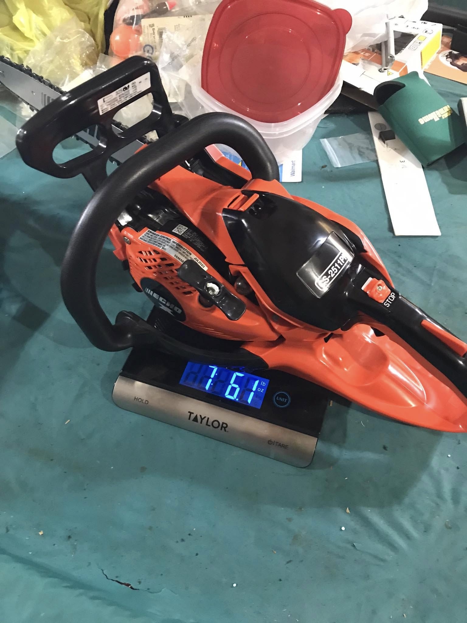

3510 weighs over 2.5lbs more then my 2511 rear handle. Even as used my 2511 lighter then 3510 PHO dry weight.
But book specs show close to same as the 2511 with egan pipe on it. Least hp etc.
Might need to compare. 25cc to 34.4cc 3510 has muffler mod too.
3410 1.7hp 3510 2.01hp and 2511 egan pipe 2.05hp and stock oem muffler 1.60hp
Echo 3510 34.4cc tuned 12.7k and new 3/8LP Oregon 91 loop. Muffler modded.
Echo 2511 25cc tuned 11.5K and new Oregon nano 325 loop. Egan pipe. Can hear still fat tune for working with.
Maple I cut this year over 9ā€ but just under 9.5ā€.
Give me the Egan piped 2511 25cc all day.
But the 3510 will be perfect for dads needs.

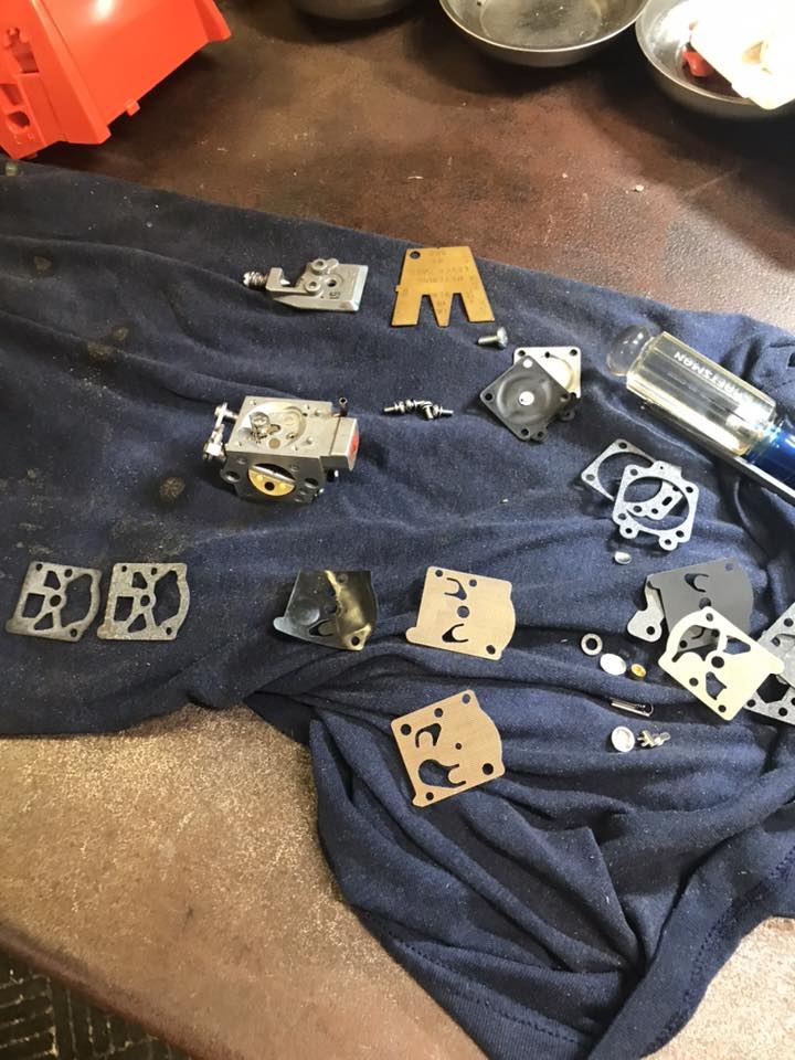

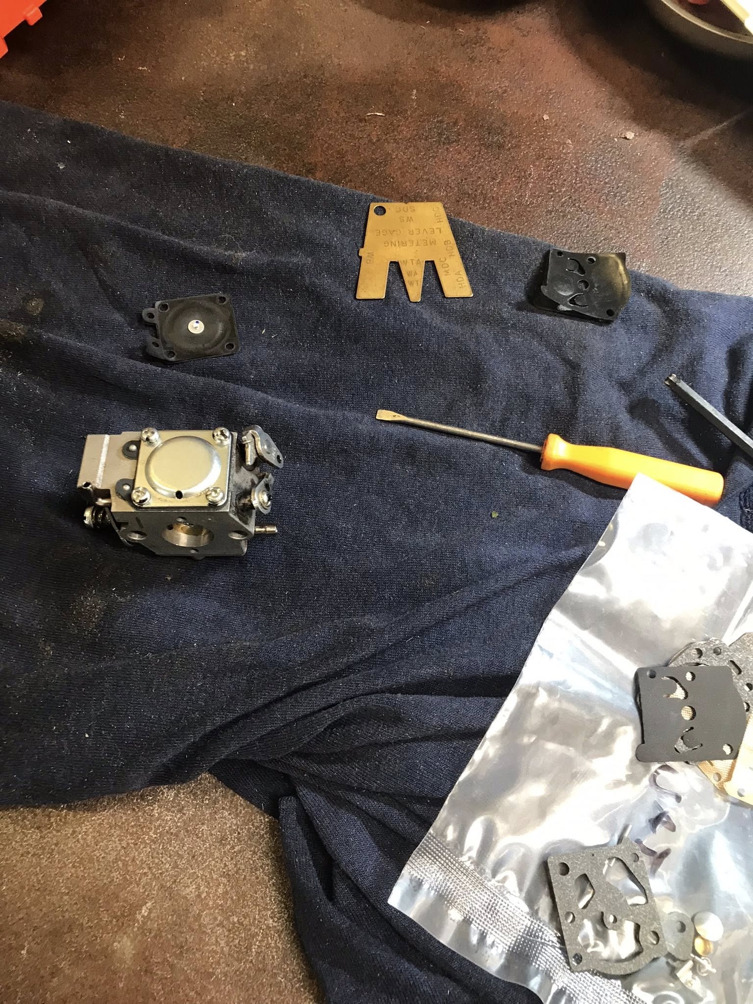

Tested echo 3510 one more time to make sure good enough for dad and easy to start and idle all day if set down too.
So far so good.
No way I would ever pay the $299 retail on one of these. I would have been disappointed. Even with my 10% off for $269.
Glad I found this used one for $100 shipped and just needed a carb rebuild and tune. 😁
But a guy in my chainsaw group told me he has a 3510 and 180 and said it out cuts the 180. Which was good to hear.
Since I gave dad a 180 easy start many years ago. I just wanted something close to that to replace it.

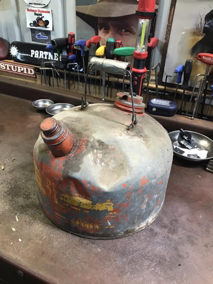

Thread on old metal gas cans on my CRG.
Dang if the one I have was even older then ones guys showing.
I dont even use it even though like new inside still.
Red wooden handle taped.
