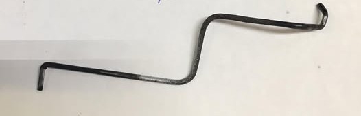

Always nice to find the part you put in a safe place just a day ago for a guy.
Poulan 5200 throttle linkage. NLA
Way to much time spent trying to find where I set it in the shop, 3 different times looking. :ROFLMAO:

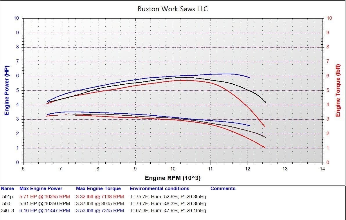

Porter in CRG FB did all 3 to compare. 550 346 501.
Me give me the lightest as used one.

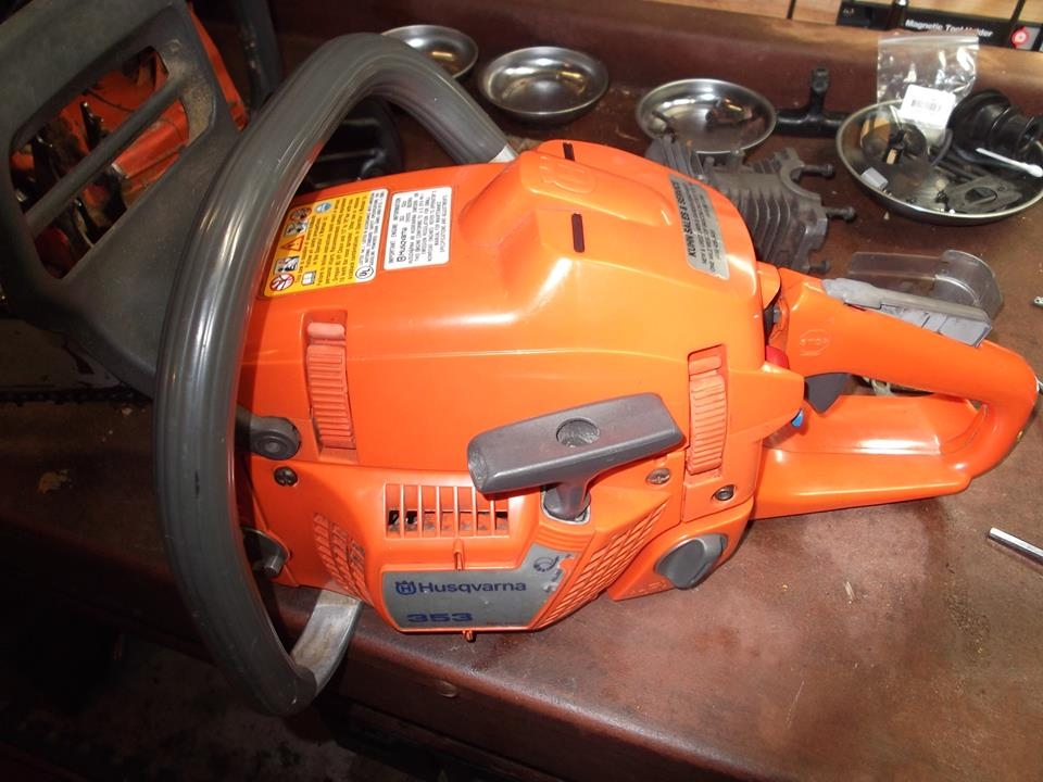

353

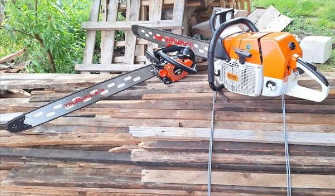

Echo 2511.
Just seen they make 18" 20" 1/4" mini micro bars for these. Why no clue.
But ported seen it cutting right through like hot cutter.
Think that would be better on a rear handle one.
I put a 14" on mine even with nano 325.

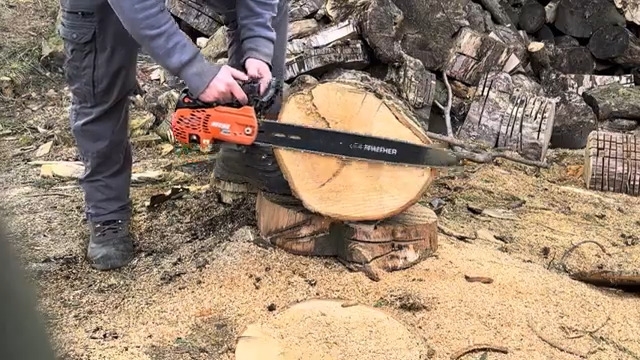

This guy in my group is really pushing the limits of his 2511.
It did make the cut he showed.

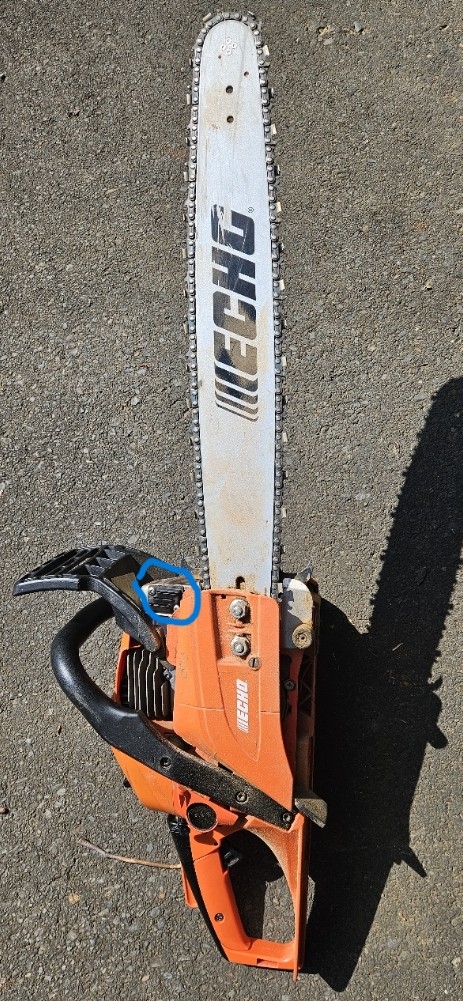

Finally put on the new Shindawa exhaust on the CS490 with 20" bar.
Seems to be a very nice power upgrade with a little screw adjustment.
Reason it took so long is the screw that Echo puts on the exhaust are so soft I had to buy a small extractor set to get it out.
Went and did some cuts and noodled a close to 30" ash round and it pulled like mad.
Probably not much added oompf , but it certainly makes a difference.
Cheapest noticeable engine upgrade I've ever done, other than drilling holes on other exhausts.
