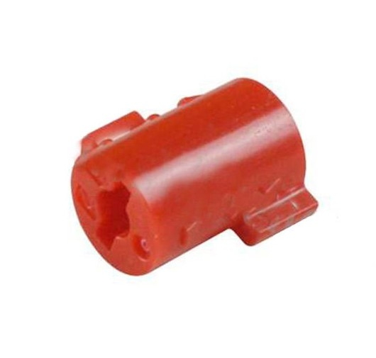

You wrote pulling the one EPA cap left to get more RPMs. I took that to mean you were replacing it. How does that help RPMs?
I took them of the red epa stops off L H. They wouldnt let me get over 10.5K rpms on H side, as thats how they stop you from adjusting.
Ran it fat long enough breaking in.
Took red stops off and got full carb adjustment. Now I am at 12.5k I had it at 12.8K but was super hot and when cools off will change. So went in favor of hair fatter.

Common kind echo has used for epa limiter cap.

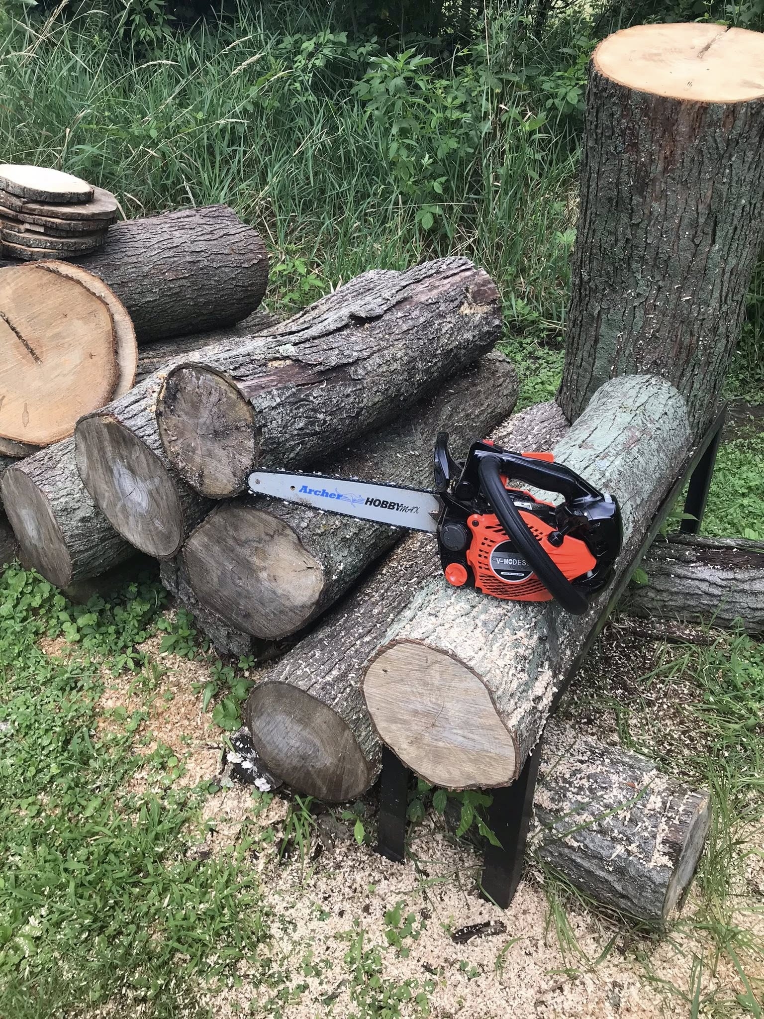

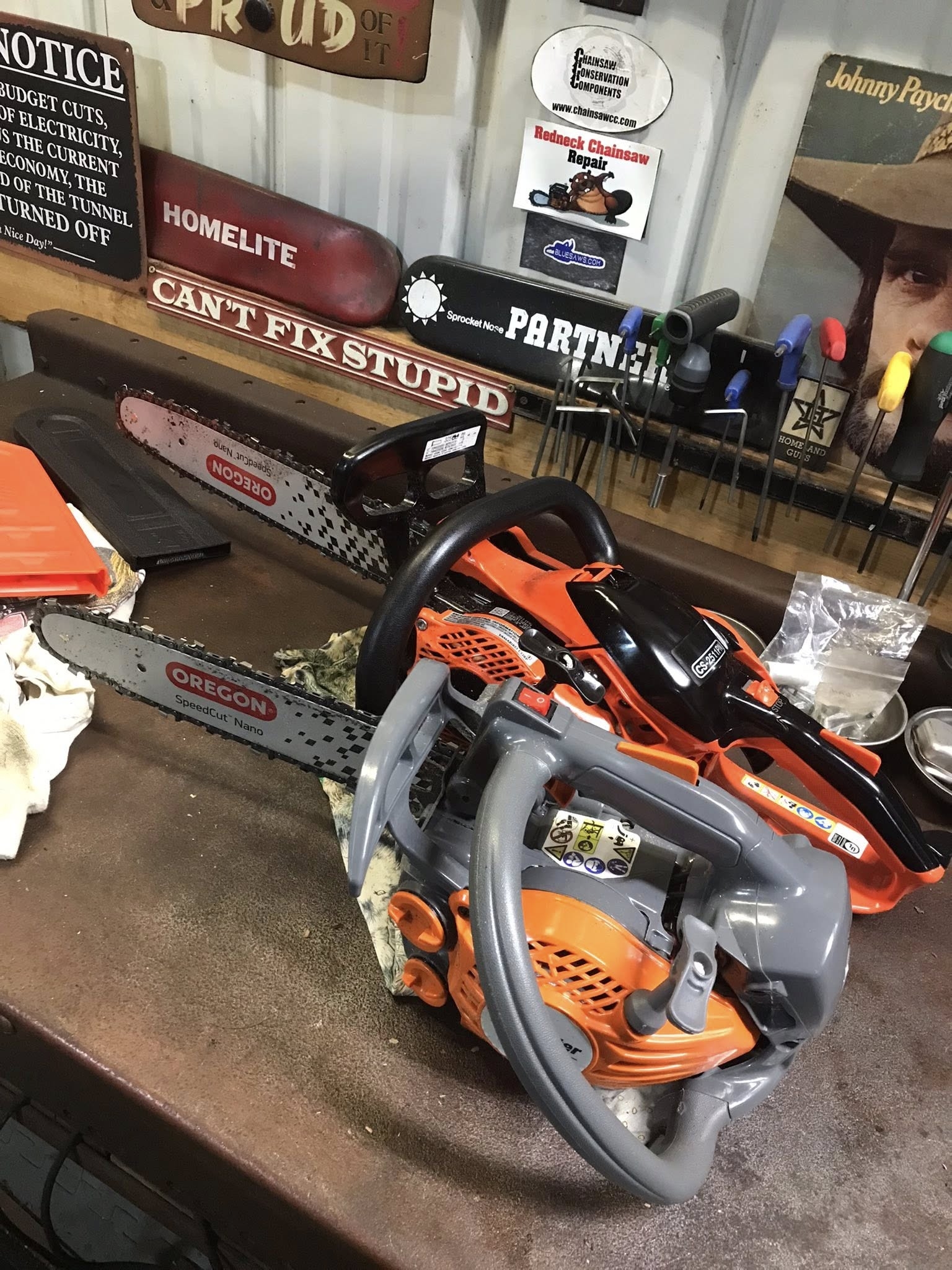

Muffler testing wood picked out for oem and clone.
Pipe, 2 cnc mufflers from different makers and the open clone.
Going to use Oregon nano 325 set ups on oem 2511 PN and clone Farmertec G2511
This vmodest 2511 just used to check it.
1/4” mini fruit tree pruner saw.
9x8 and it's 9 down.

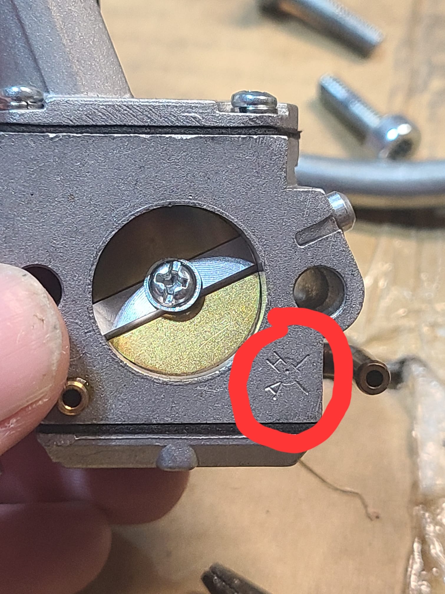

Walbro carbs on the Farmertec China clone saws
I always figured they were made at the China walbro plant.
Dealer contacted Walbro = We have contacted walbro and verified in fact that the carburetors are made by walbro. By a marking on the carb they could tell me what plant they where made in. The 660 and 372 carbs are made in Thailand for the china market. So I would assume the rest are made in the Thailand walbro factory.
   / Just another junk chainsaw
#2,550
Dealer = Just pulled the walbro carb off the new g366 pro and it has the same markings indicating it is made also in the Thailand plant.
Carb pic with marking
