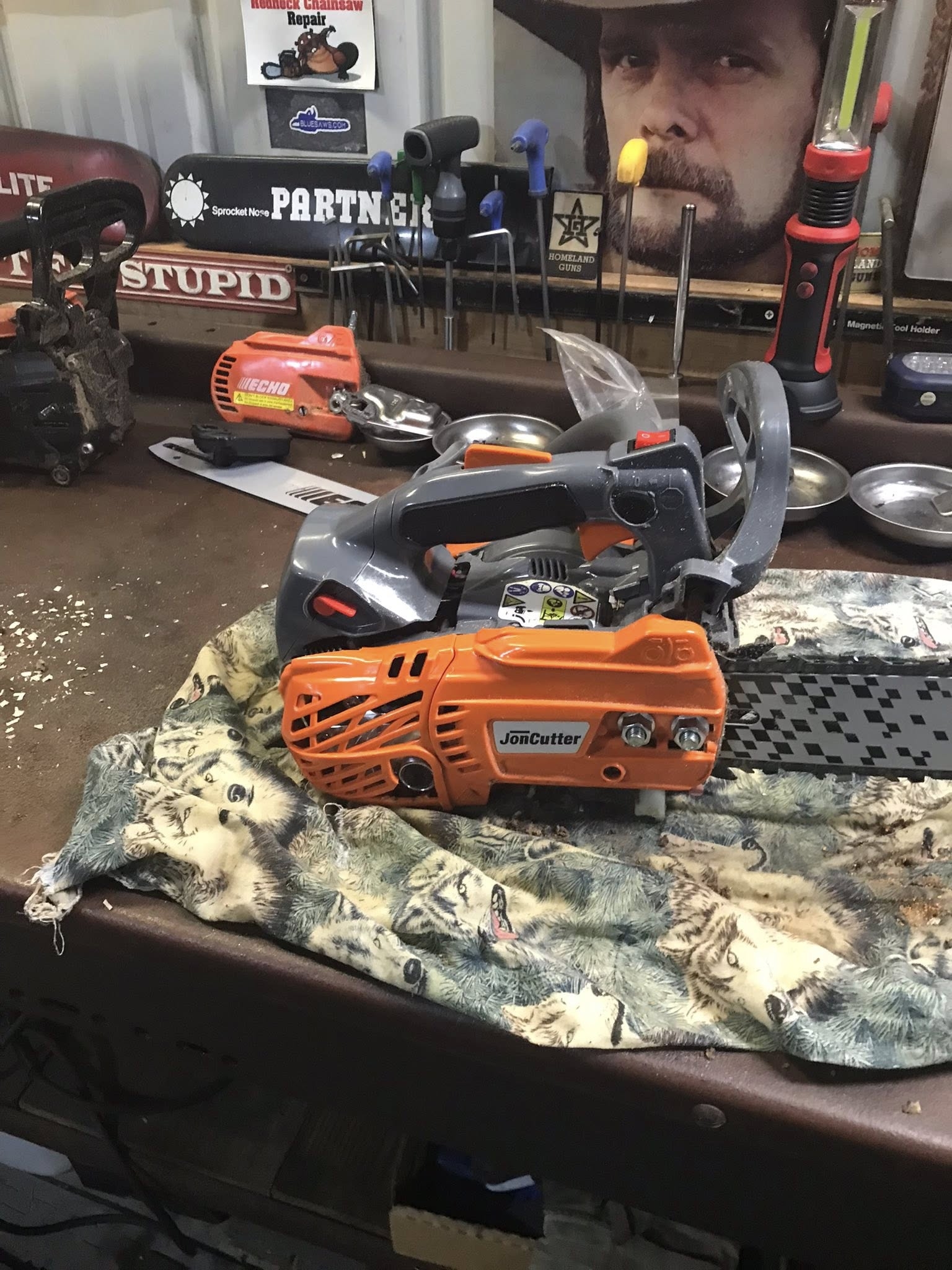

Shows around 3pm this rain might slow up so I can film. 2511 muffler testing.
Putting new loop on oem one first.
Need to flip log around. Noticed to much variations in the end piece for first 3 mufflers if did 3 cuts each. Other end was close for way longer length.

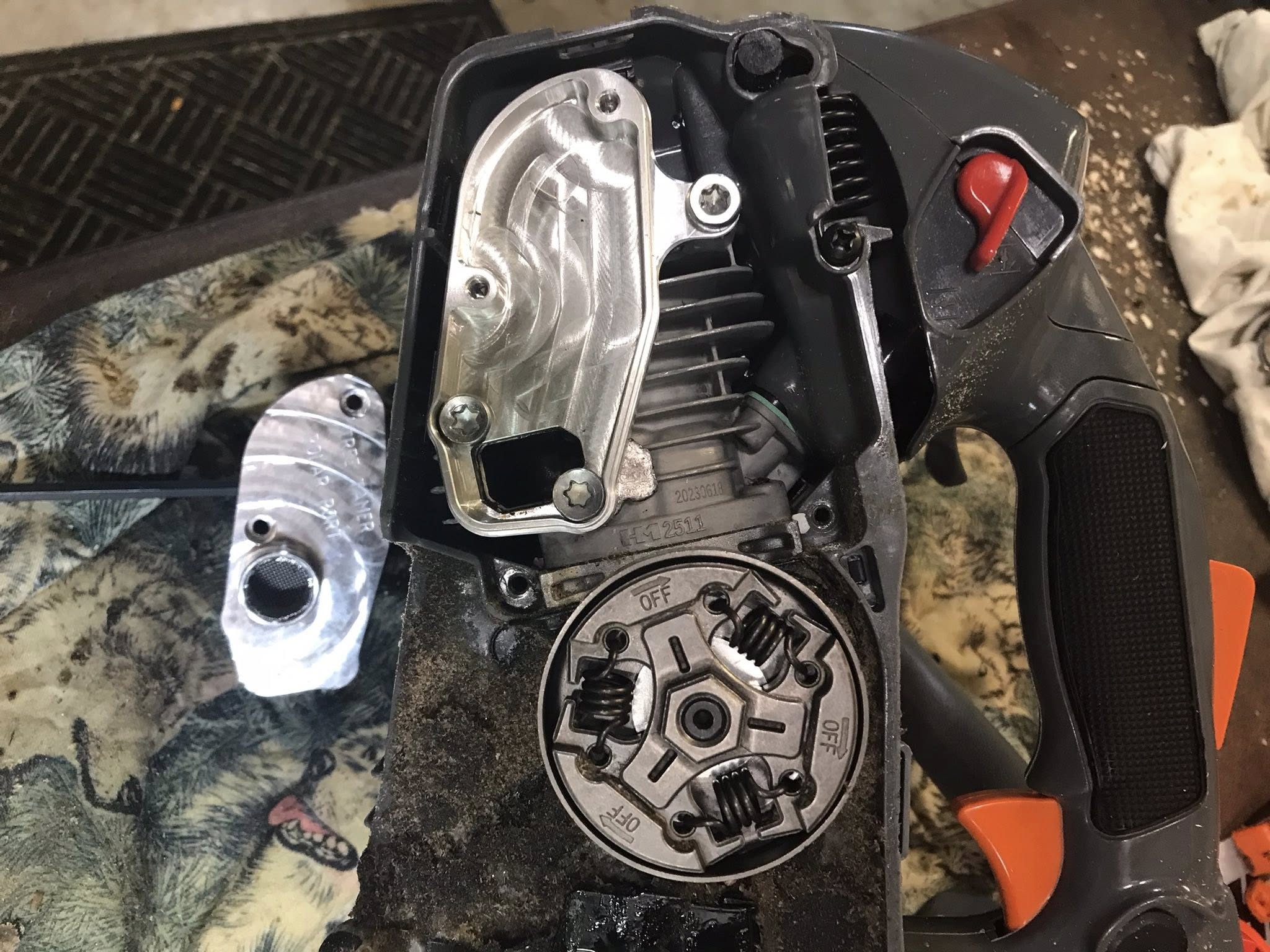

#2,568

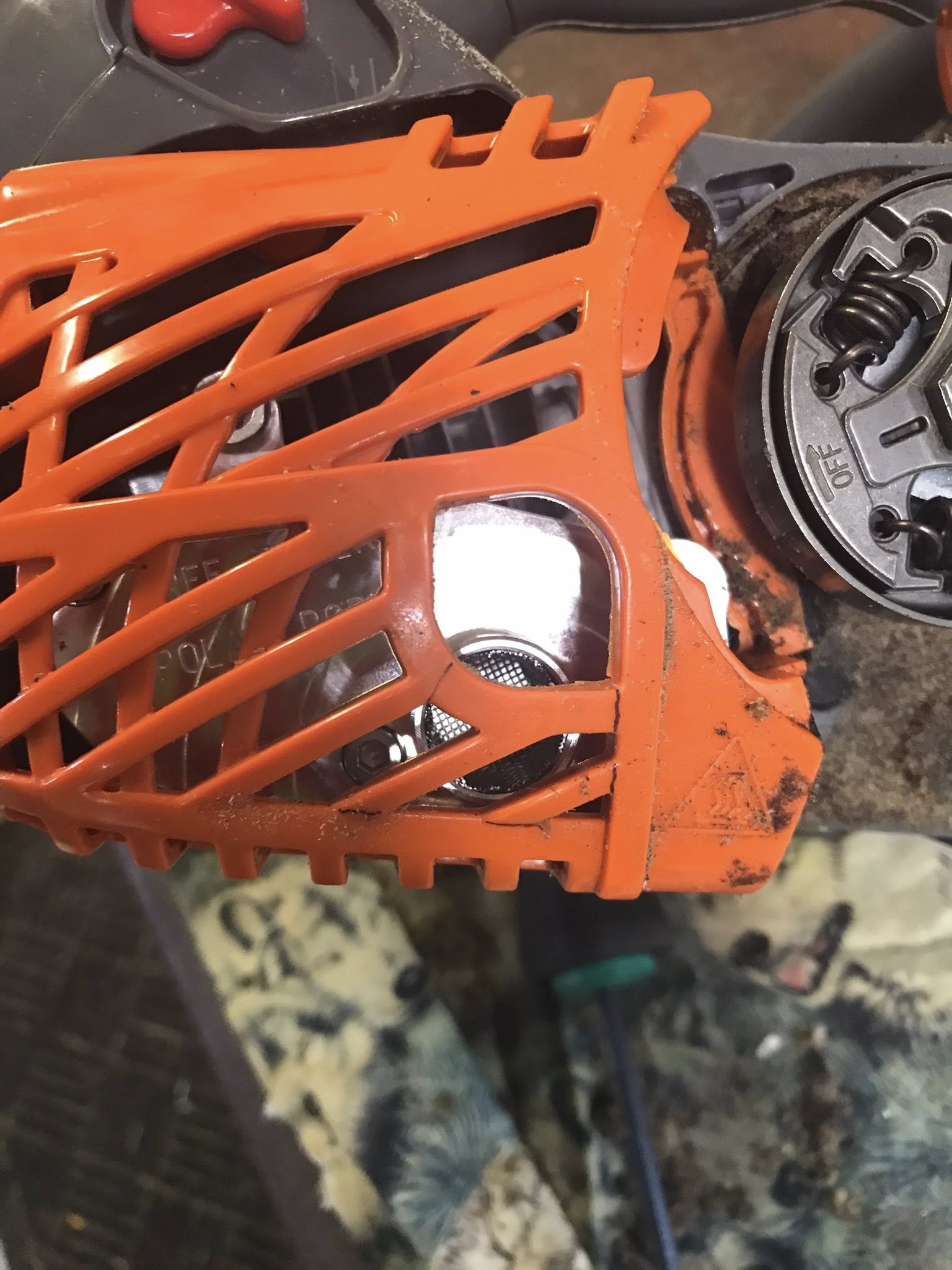

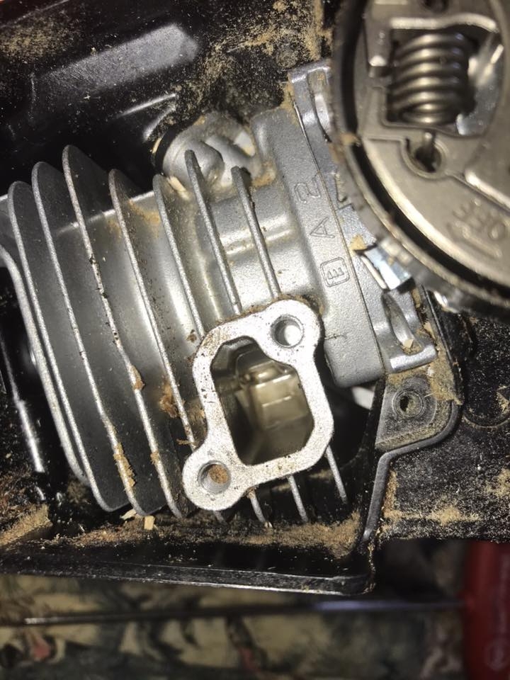

Instead of shaving the back mount on cnc mufflers to run on clone 2511. Like Scotty showed.
I decided to run 2 gaskets since no heat shield used on clones to make up that space.
PSS V2 on the Farmertec 2511.
Egan pipe going back on my oem.
   / Just another junk chainsaw
#2,569
Farmertec 2511 clone muffler test. PSS V2 was best.
PSS V2, Egan and the clone open pipe muffler.
I even put screen in on PSS V2 as I was going to leave it on the clone too.
