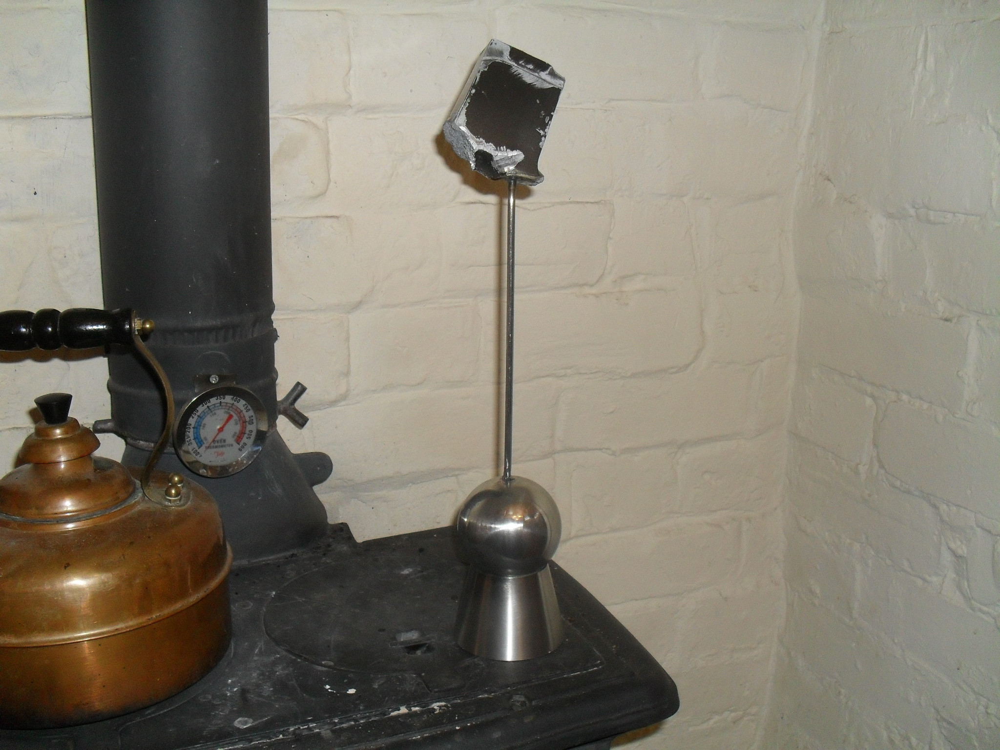

Well you're right of course and I haven't had to sharpen any of mine yet and that is the first one I have had any trouble with.
Here is the finished trophy for my friend who wrote his car off on a wet roundabout.
You can see the size of the ballbearing in this pic, I drilled into it just over an inch and it isn't just case hardened steel it is stainless steel (not magnetic and very hard)
The bit on top is a piece of his wheel that was picked up off the road, we are to present it to him tomorrow together with a photo of him alongside his wrecked pride and joy with his head in his hands:laughing:
All in good fun and he will treasure the trophy I'm sure.
Serves him write for not buying a Lotus, he went for the cheaper Vauxhall alternative :D
(you may have noticed that Sutol is Lotus backwards)

I can only think that the bit was so hot that its shaft was softened allowing it to deform after the hardened cutting edge had snapped off.
Unless anyone has a better explanation:anyone:
Bound to have been a carbide tipped bit.
