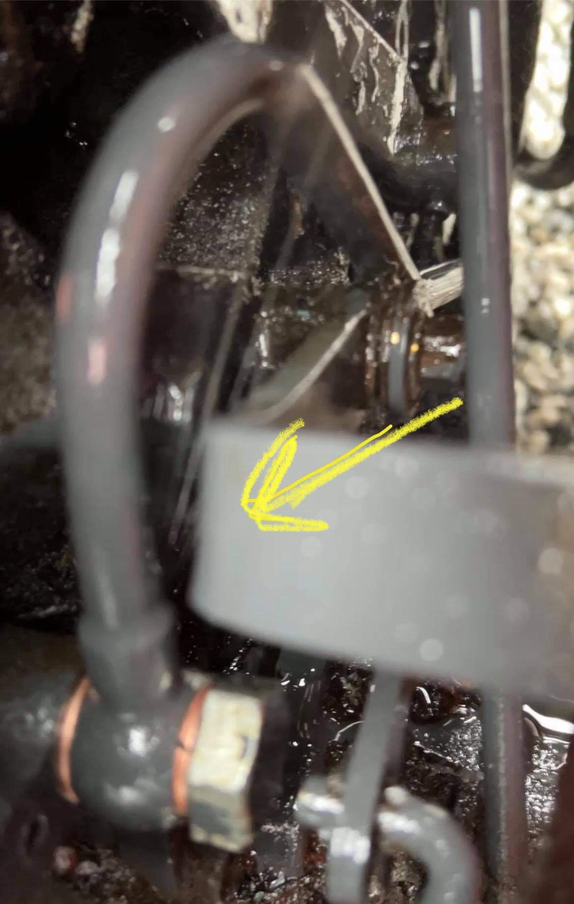

Stubborn leak persists. Is now even worse.
I replaced the banjo bolt and crush washers and got them tightened as much as I think they can be without breaking bolt again.
am now thinking that the leak is coming out of the metal hydraulic line.
it just seems to drip until you raise the 3 pt hitch up and then it sprays out with a vengeance (being careful not to get my skin near).
what are best options for fixing this?
It looks like it will be a huge headache to remove and replace the line.
are there ways to repair in place (can barely get my hand in there) or to replace just that section?
thanks for all the help.
on a good note I did get about half an hour of grading the drive before I noticed that my right calf was getting soaked from hydraulic fluid!)

Well, if you have a split hydraulic line there is only one choice: replace it. With low hours on it like that I'd think you get it to a dealer and get it fixed right and have it over with.

By all means fix it..
hydraulic oil ain’t cheap.!!
In the meantime, take a short piece of hose, cut it down the middle on 1 side..
wrap it around the leaking pipe and zip tie both ends..
Simply to deflect the spray..

Follow up question: Why would it spray out hard when I lift rear hitch to the top? Is there some pressure relief valve on the b2400 that’s not working? Are you not supposed to take the hitch all the way up (unlikely)?
what might have caused this and is this a replacement that a hobbyist mechanic like myself should attempt or better pest to the professionals?

No, there is no reason for you to need to baby this tractor. To be candid it looks to me like there are a lot of rough treatment indicators with this machine. Too much wrong for a 200 hour machine. I recommend you get it to a dealer, request a once-over and have it fixed right once and for all. With such low hours I am assuming you want to keep it quite a long time.
