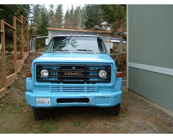

Hi guys, got a question for the heavy equipment mechanics out there.
This weekend I hauled my trailer ( 8000#) with the dump truck over to Idaho, up two mountain passes and a total of about 380 miles.
Any how I made it with no problems, however I got stuck in the snow on my property. I put the chains on and proceeded to rock her in 1st and reverse, including some power braking to try and limit wheel spin.
I now have a kind of clunking/ scrunching sound coming from the rear end area.
I wasn't able to spend any time to check it out so I drove it about a mile with the noise not getting worse and parked it.
At first I thought I damaged the rear end, but now I'm thinking U joints?
Any ideas?
Thanks, Tim

That's hopefully what you did. That way the repair is inexpensive.
Lay on your back under the truck with some gloves on grasp the driveshaft by the u joint and see if you can shake it. See if it moves or makes a rattle. Visually check the ujoint to see if it's damaged. If it is, it's a 10 min replacement job.
If it's not, it could be damage to the ring & pinion in the rear.

Just read about your problem and want to agree with Builder's advice. Sometimes you have to get the rear tires off the ground, but ususally you can tell with the vehicle in neutral. Just try to turn the drive shaft by hand and see if it moves. It shouldn't. Usually what happens is the cap over the roller bearings in the U joint breaks and then the U joint flops around. Then it's just a matter of time until the rest of the U joint breaks off and you are stranded.
If it's not the U joint, get the rear end off the ground and spin the tires by hand. If you can hear any noise coming out of the rear end/differential, you know it's in there. I've never had any work done on my dump truck axle, or anything that large. I have had work done on half ton axles. The labor was minimal since I brought the parts to the shop. For them, it was just a few hours or work, which saved me allot of money.
If it's the rear end, find a shop that works on them first and ask what you can do to save money on the repair. Pulling the axle off is simple enough and a good way to save money.
Do you have a two speed rear end? I don't know enough about them to know what to look for, but have heard that they do go out and they can be pricey to repair/replace. If the driveshaft and differential check out fine, that is the only thing left to check.

Thanks for the suggestions guys,
I got out to my property this week end and crawled under the truck, Surpise!! One of the rubber "doughnuts" around the center drive line support had some how worked its way out, and the drive line was dancing around in the bracket.
Removed the two bolts re-inserted the rubber and presto! new truck!:p
