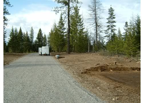

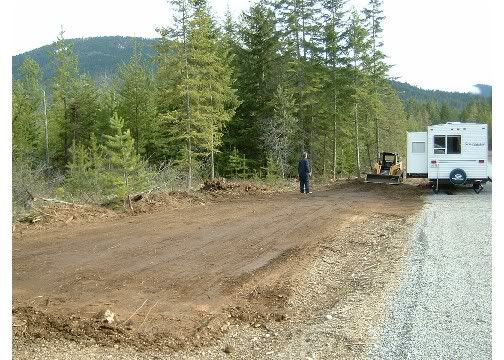

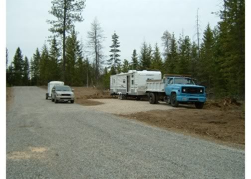

Sorry I dident get many pics, I only had 2 days to level and build a pad for my trailer. Notice my home made roller? It worked pretty good, but needs vibration. I'll have to work on that.

Hey, you're a pro dump trucker/ excavator already!!!
Lookin good.
There's a lot of older dumps out there that are just "given-up" on. Their owner just doesn't want to investigate the little problems and fix them. Many trucks can be bought cheap and with a small reinvestment, be brought back into a usefull work or weeked tool.
Look what you've got and how little it cost you. That truck will haul more than an F-550 for 1/8th the cost. Might not do it in high style or off road without 4x4, but look what you saved $$$. tell you what would make your truck look great is a new paint job on the cab and a chrome front bumper. Probably get all that done for ~ $1,500 and that truck would look excellent. Maybe a nice GMC red or white color.
