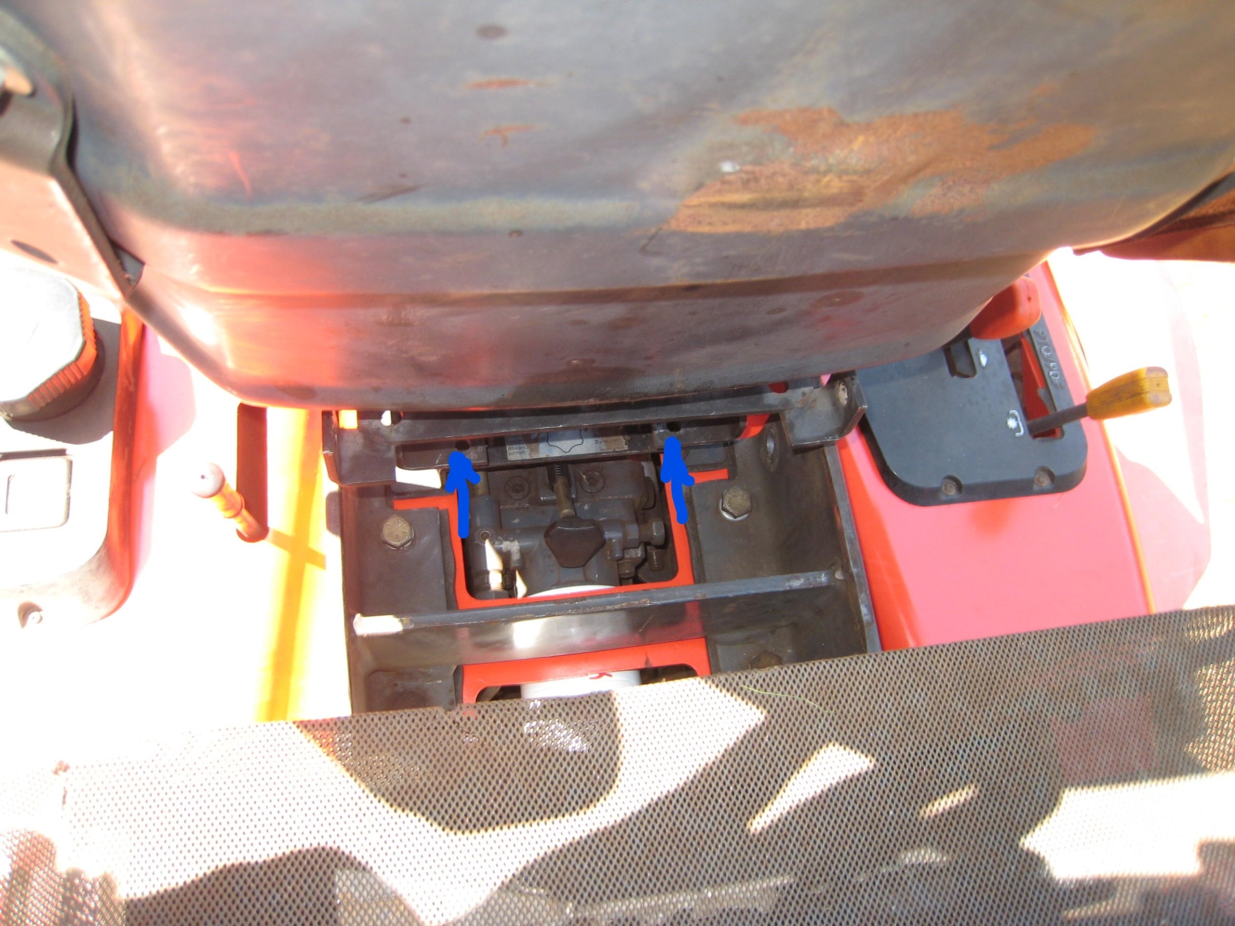

Anyone shopping for a replacement seat for F3060 should be aware of the narrow bottom mounting width.
The mounting base is recessed several inches in the fender and not just any seat base will fit.
One solution would be to just replace the seat & reuse the spring suspension/mounting but most users would like air ride seat I think, which may also be available in narrow model?
Newer F models are different as far as I know.
See the blue arrows in my photo below.
Edit:
The seat suspension base that bolts to the framing is only 225 mm (~ 8 7/8") wide, and center to center mounting holes are 200 mm (~ 7 7/8") apart.
The base sits in a narrow recessed area in the fender as mentioned above.

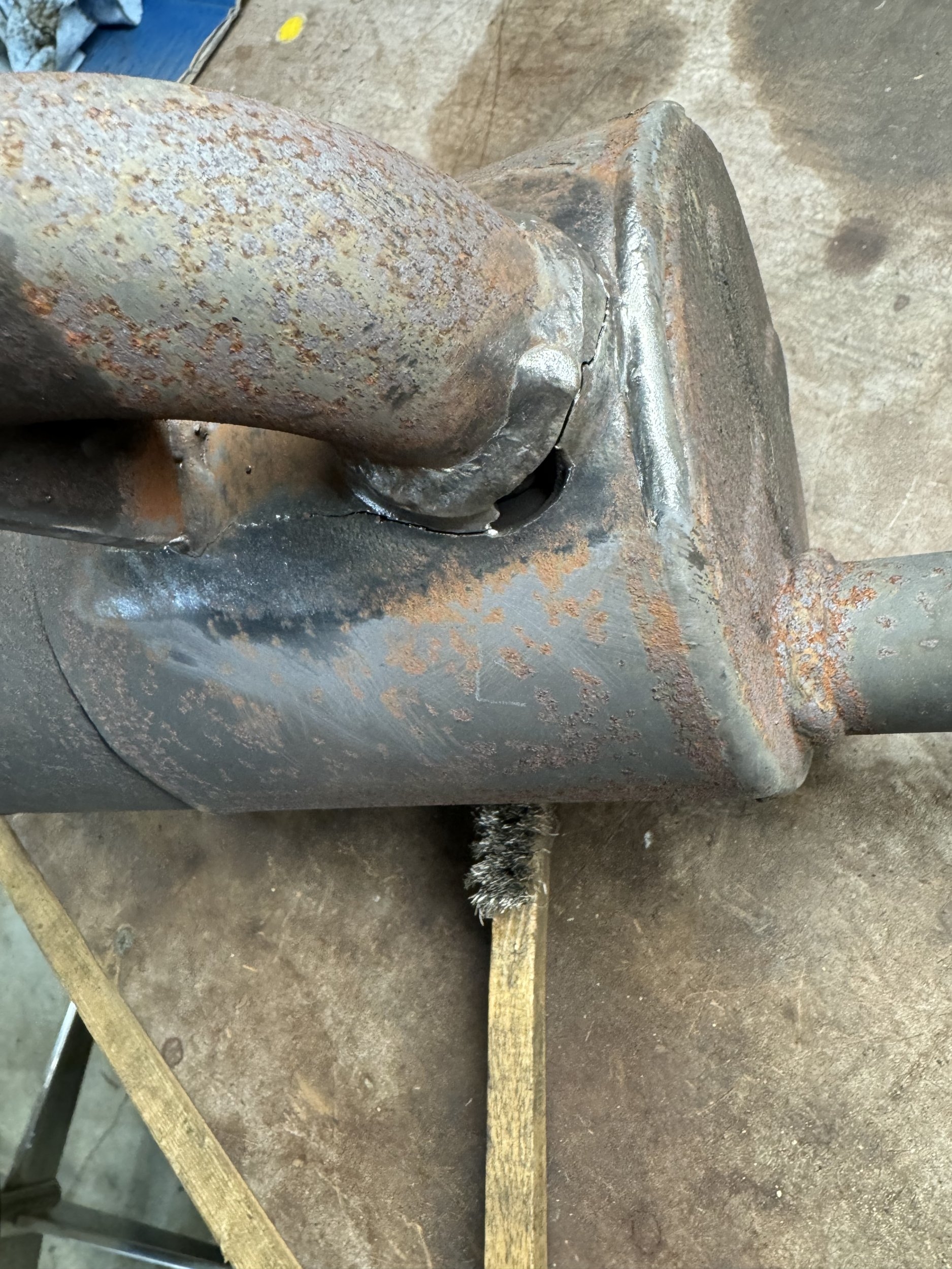

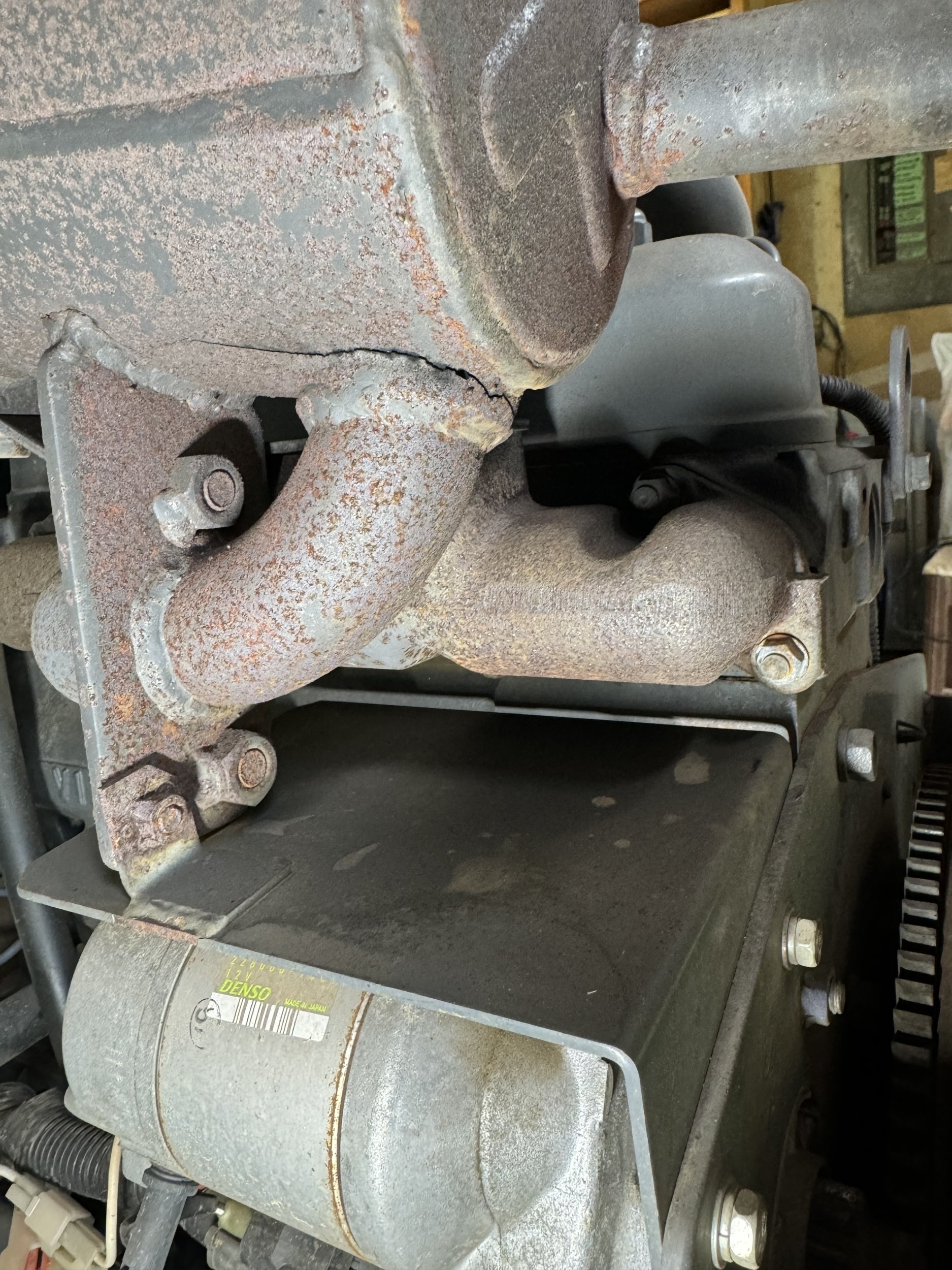

While servicing my F3060 yesterday, I learned of another item to be on the lookout for:
I had been hearing an intermittent rattle behind me, especially when cold. I had the hood open right after I started it and noted the rattle again. The muffler was still pretty cool, so I put my gloved hand on it. The rattle immediately stopped. Hmmm, I thought, what the heck is going on with that? I shut it down, and got a light. After about a second I could tell what the problem was.
Just for grins, I went to the Messicks parts site....$549. Well, that WAS fun. It didn't look like a good project for my old stick welder, so took it over to the brother in law's for a little MIG love. Due to my lack of MIG experience, I'm not including that picture, but suffice to say, the repair looks like it will be successful.
Though the muffler cracked at sometime before 2700 hours, it was pretty cool that the hardware that held it on was well designed. Nuts were welded to the brackets, and the bolts did not protrude past the face of the nuts, so everything came apart with no drama (see first picture). Also, the muffler was built of pretty heavy gauge material, so again, no drama to weld.
So, now gotta go mow.

The learning curve on MIG welding is pretty flat actually and why weldors (me included) refer to MIG as the glue gun of welding. Clean it, fit it up and Glue Gun it, preferably with solid wire and inert gas.
Finally, turn up your base idle to the point where the motor runs smoothly. It's the shaking at idle that caused the fracture.

After it's welded, take a wire brush to the entire muffler and paint it with high temperature flat black stove paint and make it pretty again...

5030,
You're right, the MIG does have a kind of "glue gun" vibe! Concerning the base idle, I have not felt that it is idling that low, but I will check into it with an open mind and see what transpires.
Thanks,
Doug

The adjustment screw for the base idle is the vertical one below the throttle cam. The horizontal adjustment screw parallel to the throttle linkage sets the maximum RPM at full throttle. It usually has a small lead disc with safety wire on it.
