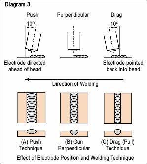

Does that mean that when using solid core mig you should be pushing the puddle rather than dragging it? I've tried it a couple times and never liked the results.
   / Just bought a new welder! #19
It really makes no difference with Mig. What ever direction works for you.
Here is a good chart put out by Miller.
   / Just bought a new welder! #20
Like SA says, it shouldn't make a difference. Perhaps you were using too much torch ANGLE when pushing?
Try it again. Easier to see going right to left pushing for me. I'm right handed.
