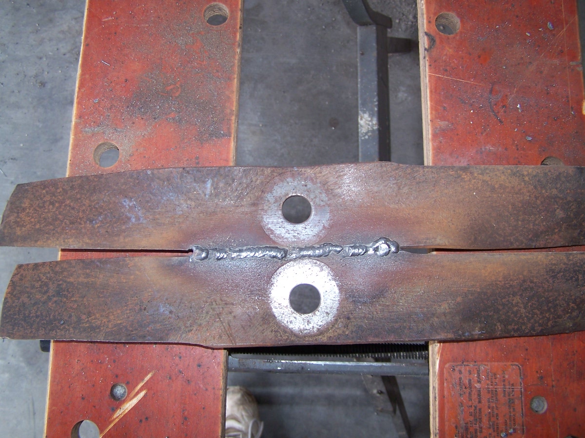

Made some sparks with my new Hobart today! Butt-welded some old mower blades together just as a test. Obviously, I need a lot of practice, but so far I'm happy!
:dance1: :dance1:
I'm going to keep my eyes open for a used cylinder so that I can try some gas welding. Thanks again for all the good advice.
