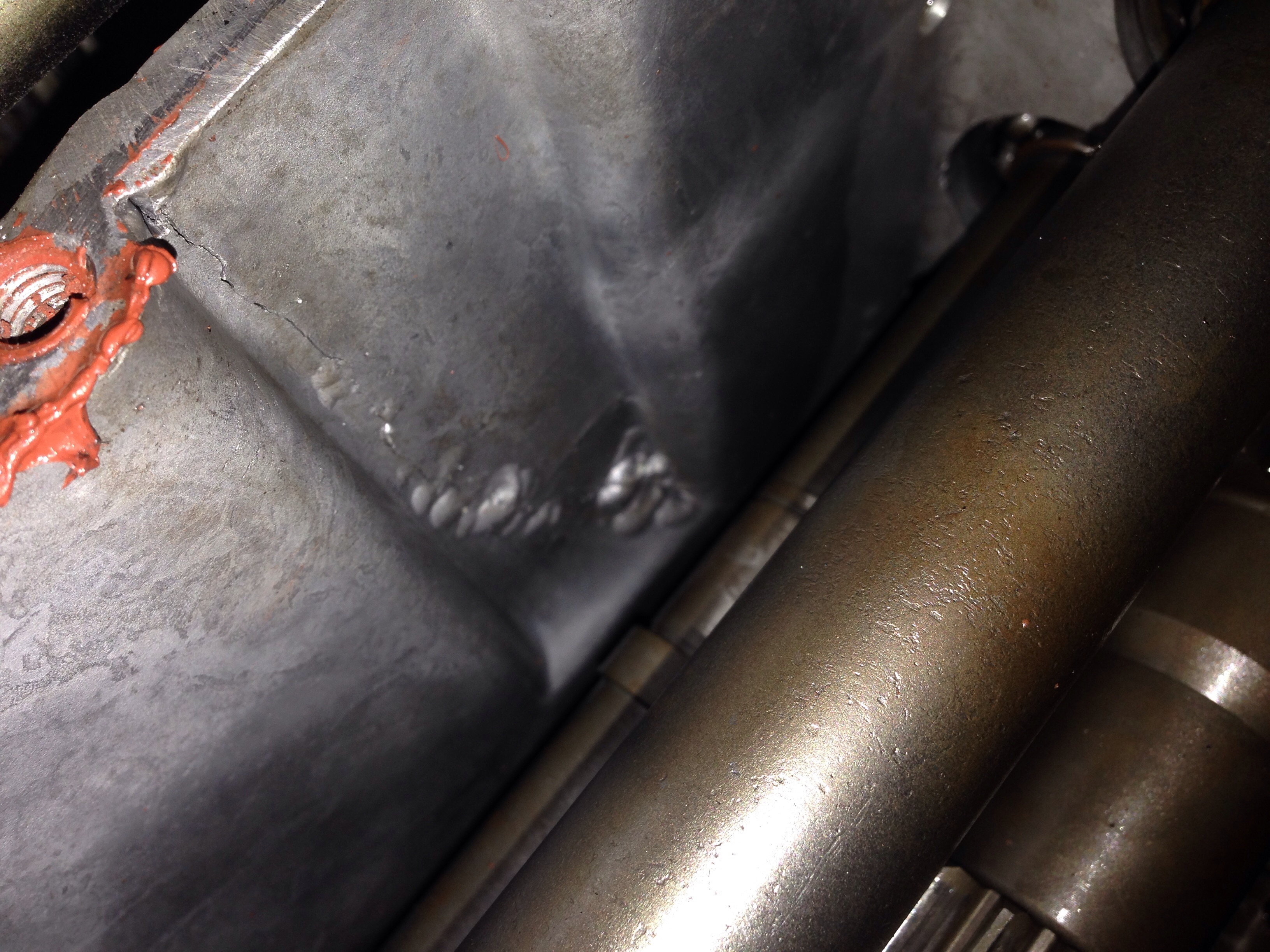

Here is the crack on the inside of the case. As you can see its a long hair line crack. It has been welded on the outside should I have it welded on the inside to. View attachment 483405
Poorboy, from pic you must have it apart?? did you tear down yourself??
and what is the final result???
   / Just bought first tractor and got ripped off
#153
I built a brace on the outside and epoxy the crack. So far no leaks and I have been using it quite often. But if it breaks I will just probably part the tractor out.

Glad to hear you made the best of it and are getting some use out of the tractor.
