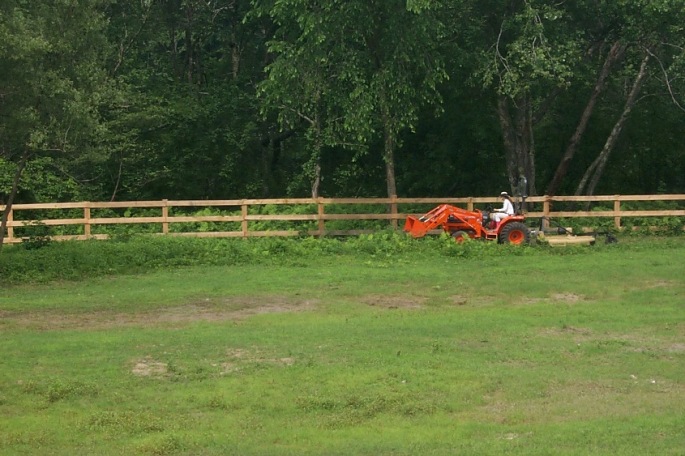

I just hit 52 hours on my B7800 and it is a useful device to be sure.
Have a ball .. check out the step modification a number of us B7800 owners have done

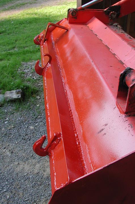

Now on the bucket, I say reinforce the top lip. I did and have never had an issue with the loader, and I have stalled it when trying to move concrete pieces mixed in with fill dirt more times than I can count. I doubt that a weak upper lip offers any advantage over a strong upper lip. I doubt bending a bucket offers much weak-link type protection. From what I can see in my case it is the system pressure relief valve that protects my loader.
I will try to attach a photo of my stiffer upper lip...I think I used 2x2x1/4 inch angle. I know I could have stitch welded it, but just started welding at the time and needed the practice, therefore the continuous bead...:D
