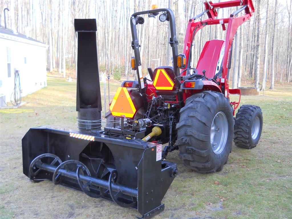

Looking forward to not having to rake gravel back up from both sides of our 1/4 mile driveway in the spring anymore.
The heated cab will be nice

Ouch!!!!! they did not put skids on it or sell skids for that snow caster?????
Your going to need a hard freeze before you can use it or pack down the
first couple of snowfalls for the first few inches of base to avoid problems.
I hope that they can sell you skids for it as the cutting edge even tilted back
by threading in the top link is going to dig.

I finally noticed something on your new blower. Hard to explain, but--- the sheet of steel that forms the bottom of the blower does not extend out to the full extent of the vertical wings. Boy, I hope that makes sense. On the blower I had the bottom went from the outer edge of the vertical "cutter" on one side to the outboard edge of the vertical "cutter" on the other side. Leonz comment brought this to my attention. Tipping my blower back so the lip was 1" to 2" off the ground would have a much greater impact on not scraping up gravel than on yours. That's because the lip on your blower is further back - its actually behind the auger. The lip on mine was in front of the auger because this sheet of steel was much bigger, wider, deeper - whatever.
Anyhow - seeing what I see now - I would recommend that you obtain skids because tipping your blower back probably will not prevent digging.

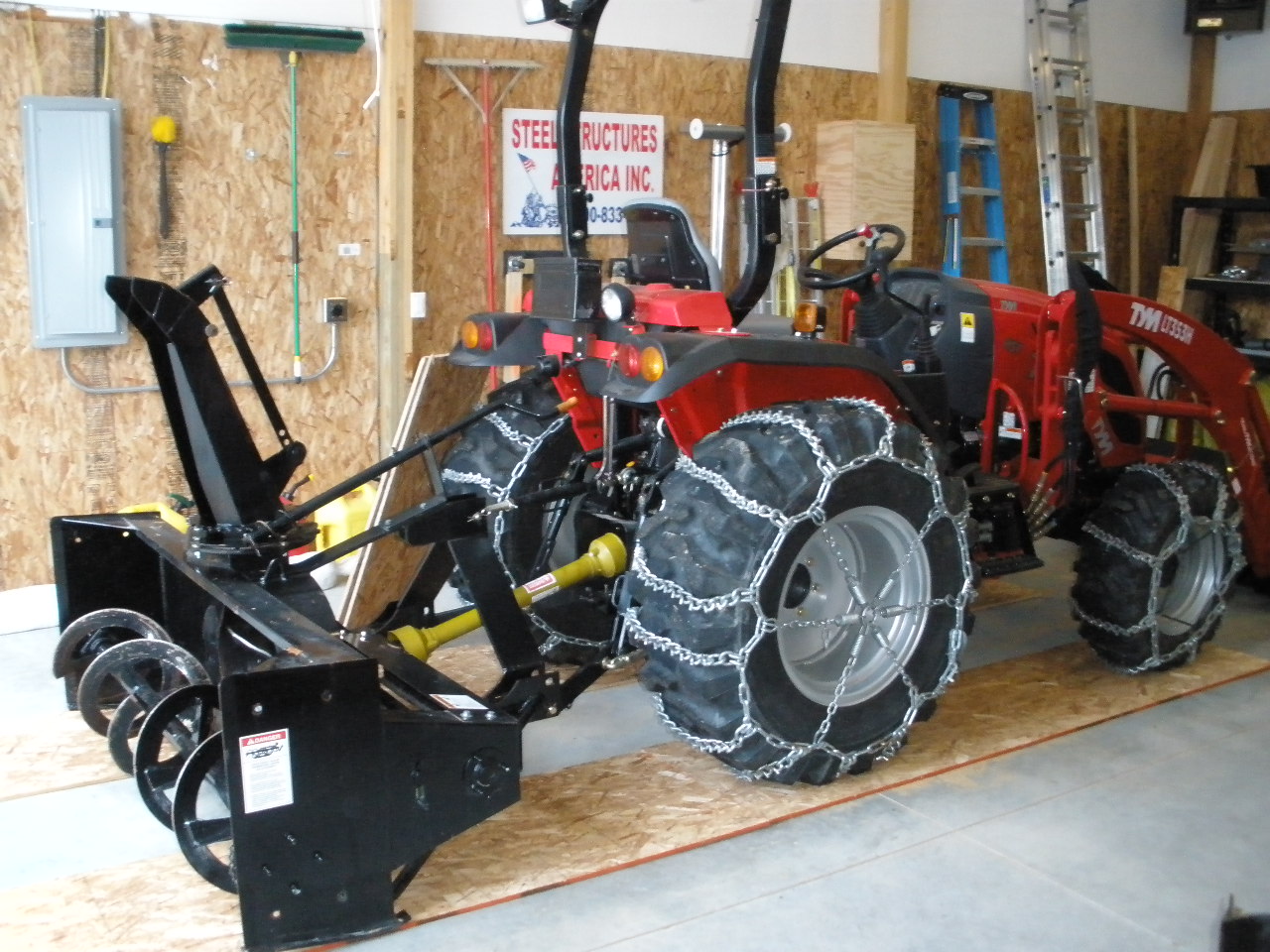

I made a set of skids for my 78" rear JRW blower out of 3.5" by 4" angle that bolts onto the sides of the blower. You can put these on for the first few weeks of blowing to help keep the blower elevated a little as you build up your frozen base. Driving on the first small snowfalls help make this base. Once the drive gets frozen, you can pull the angle off and go with the factory skids. Tilting the blower back a little at the start helps too, but remember to keep the PTO shaft angle less than 15 degrees while it is under load blowing snow. Depending on the winter and the weather you get, you will still run into soft ground at the side of the road occasionally. Clean, grease chain, and paint the inside of the fan/chute area each spring.... and ENJOY...!!!!! Here a picture of my blower with the added angle iron skids at the first of the season.
