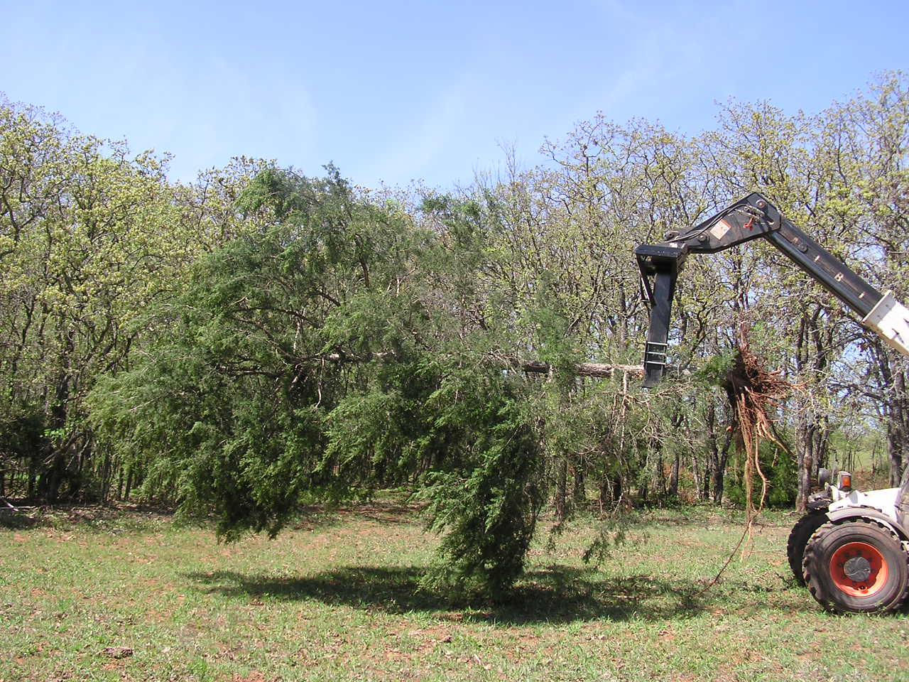

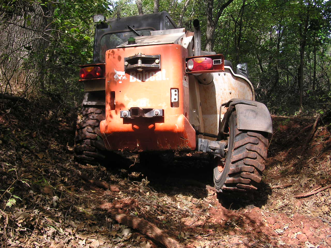

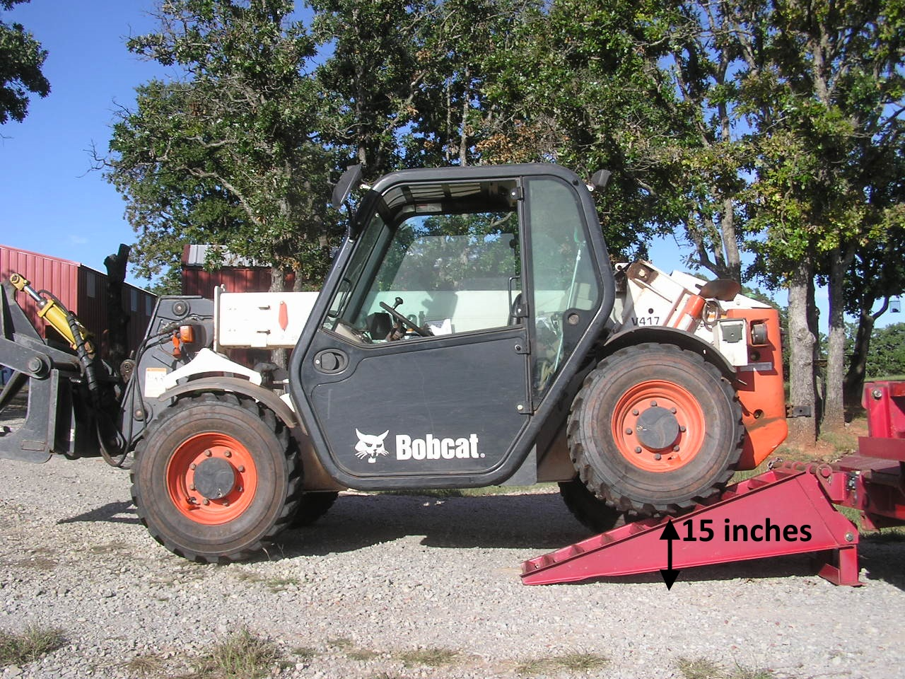

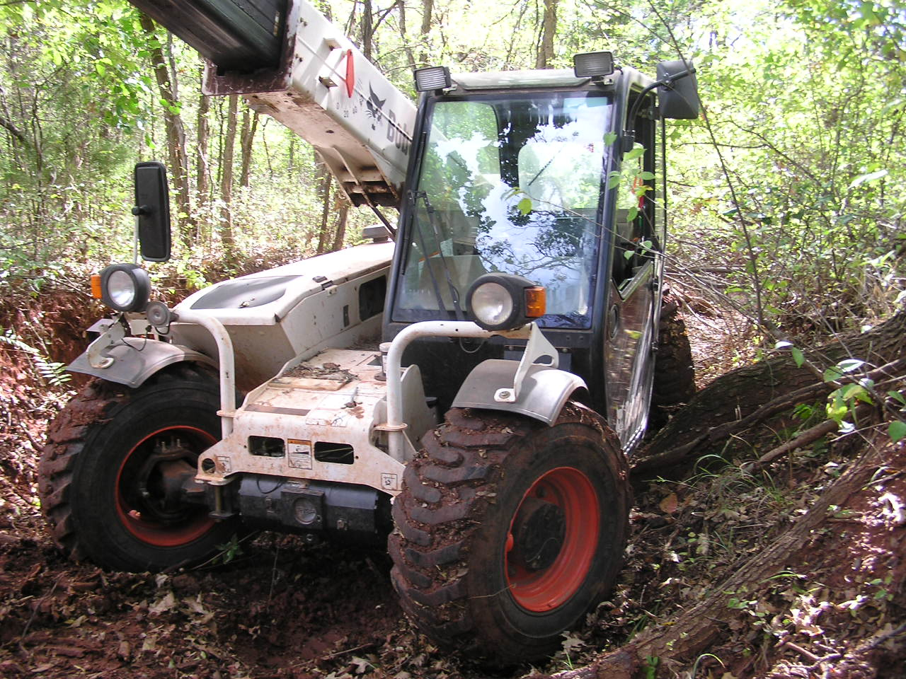

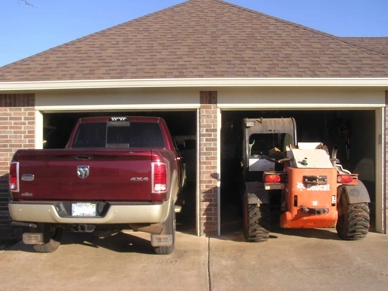

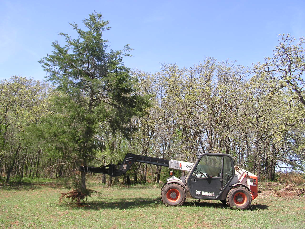

Here is mine, no suspension, the rear axle pivots and steers:
That makes it very stable with heavy loads on the loader:
Small enough to use in the woods:
And park in the garage:
I sold my tractor soon after I bought my first Compact telehandler (y).

Yes, the pivoting rear axle as shown above.

That is a very impressive picture, holding a tree up in the air. Yes, I DO need one of those. Living without one is somehow incomplete.
Thanks!

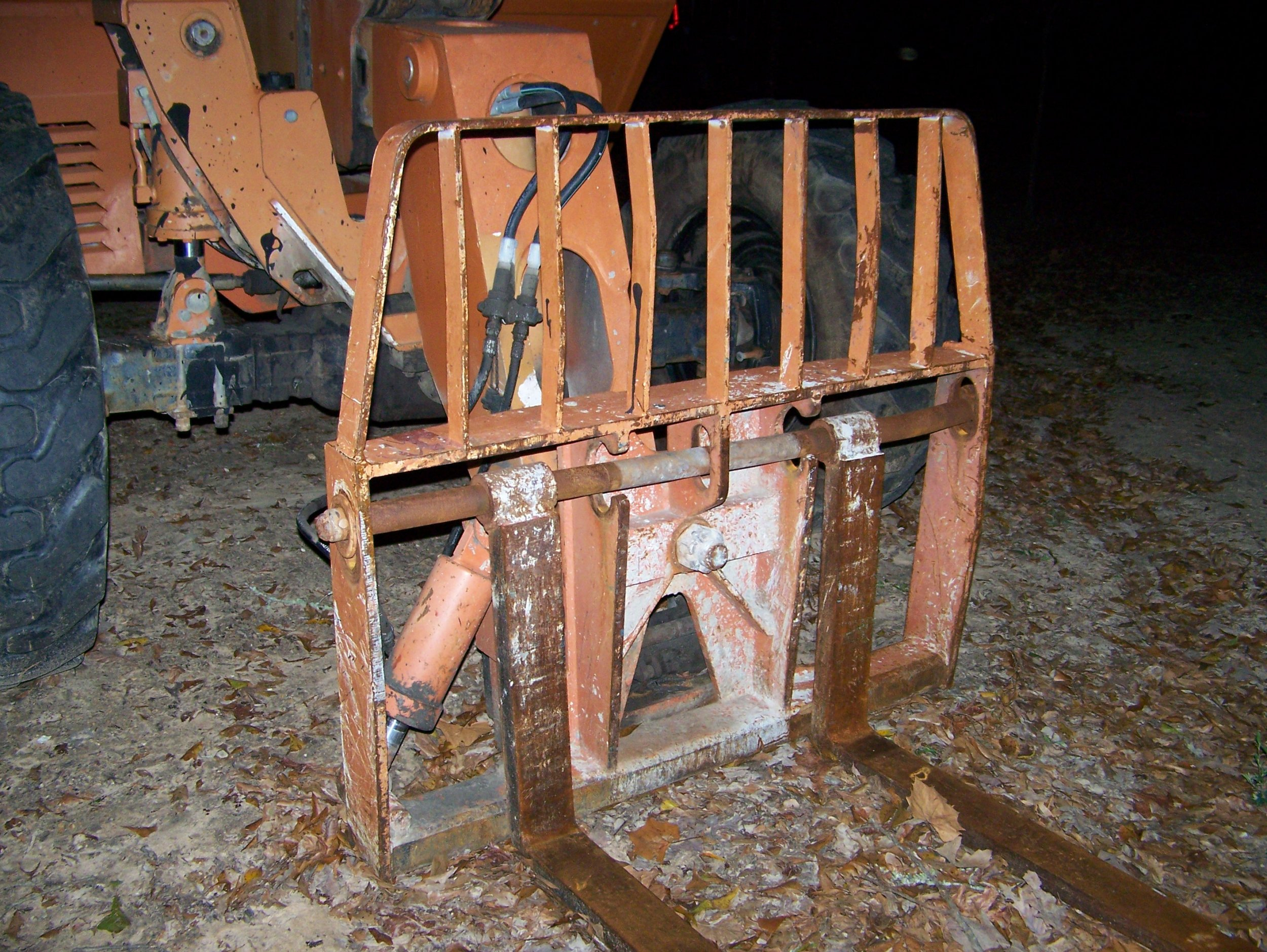

My Lull's whole frame tilts.
The cylinder rod is over 3 inches in diameter. The stroke isn't that much, but tilts the machine more than I am comfortable with. You can see above the axle. The rear axle pivots, but no cylinder on it.
At 9 feet wide and 20,000 pounds, it feels solid crossing shallow ditches diagonally.
hugs, brandi
