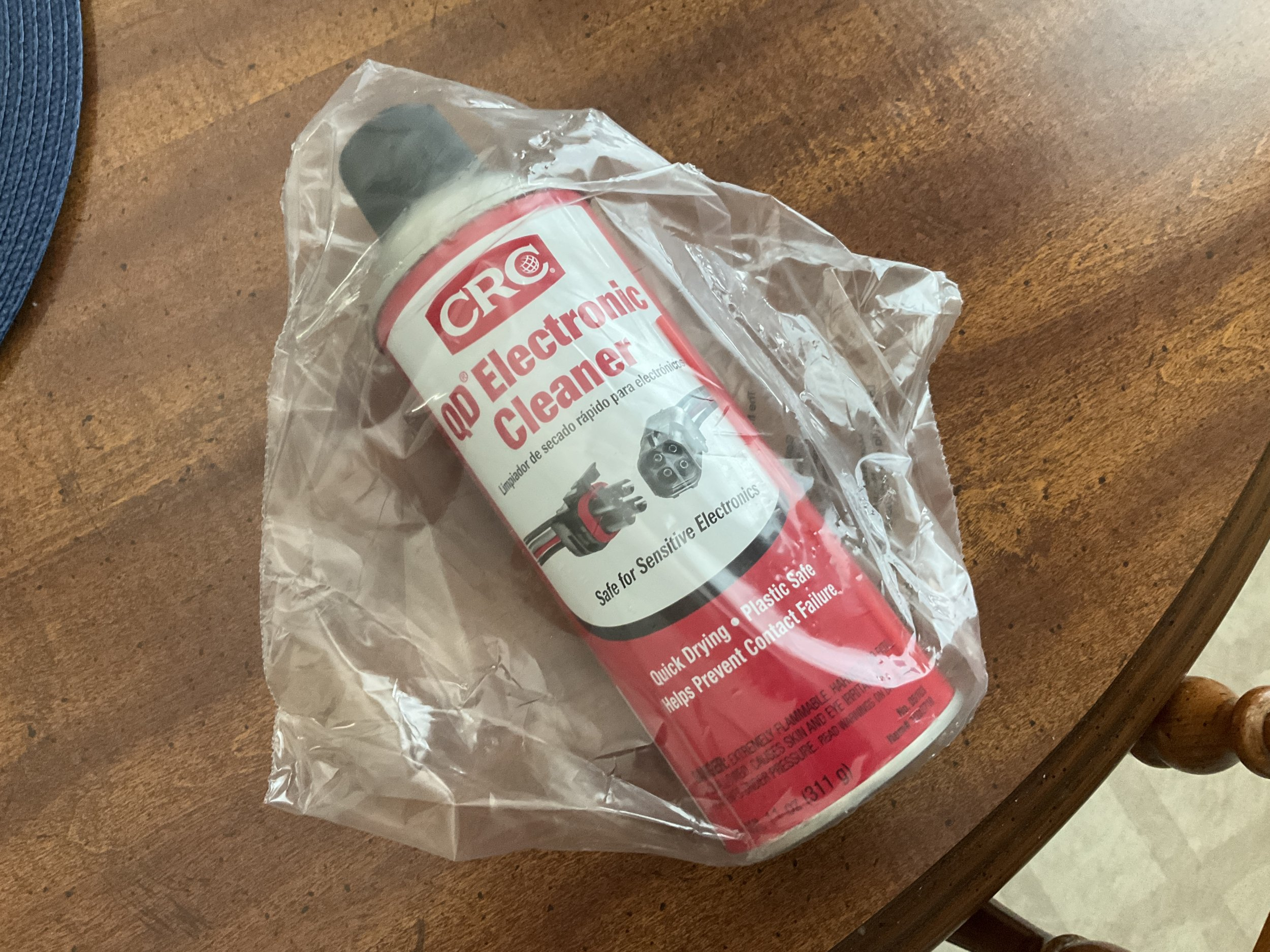

Own a New Holland WorkMaster 50 made in 2015. Was having a problem with clutch making it's contact not allowing tractor to do anything except lighting up lights on dash. Also one set of headlights would not light up.
Used the following on all electrical contacts at clutch lever and headlight contacts. Everything back working like new.
The following is what I used. Not advertising product but this was the product that corrected problems. Other brands may do the same. If you have any of these problems this is a quick check before replacing lights / connections.

Interesting. I will have to try that to see if I can get the backup camera on my pickup working again. I'd gotten used to having that extra view to the rear.
   / Just in case! #4
Oh yeah, been using that stuff for years. Works great on switches.
