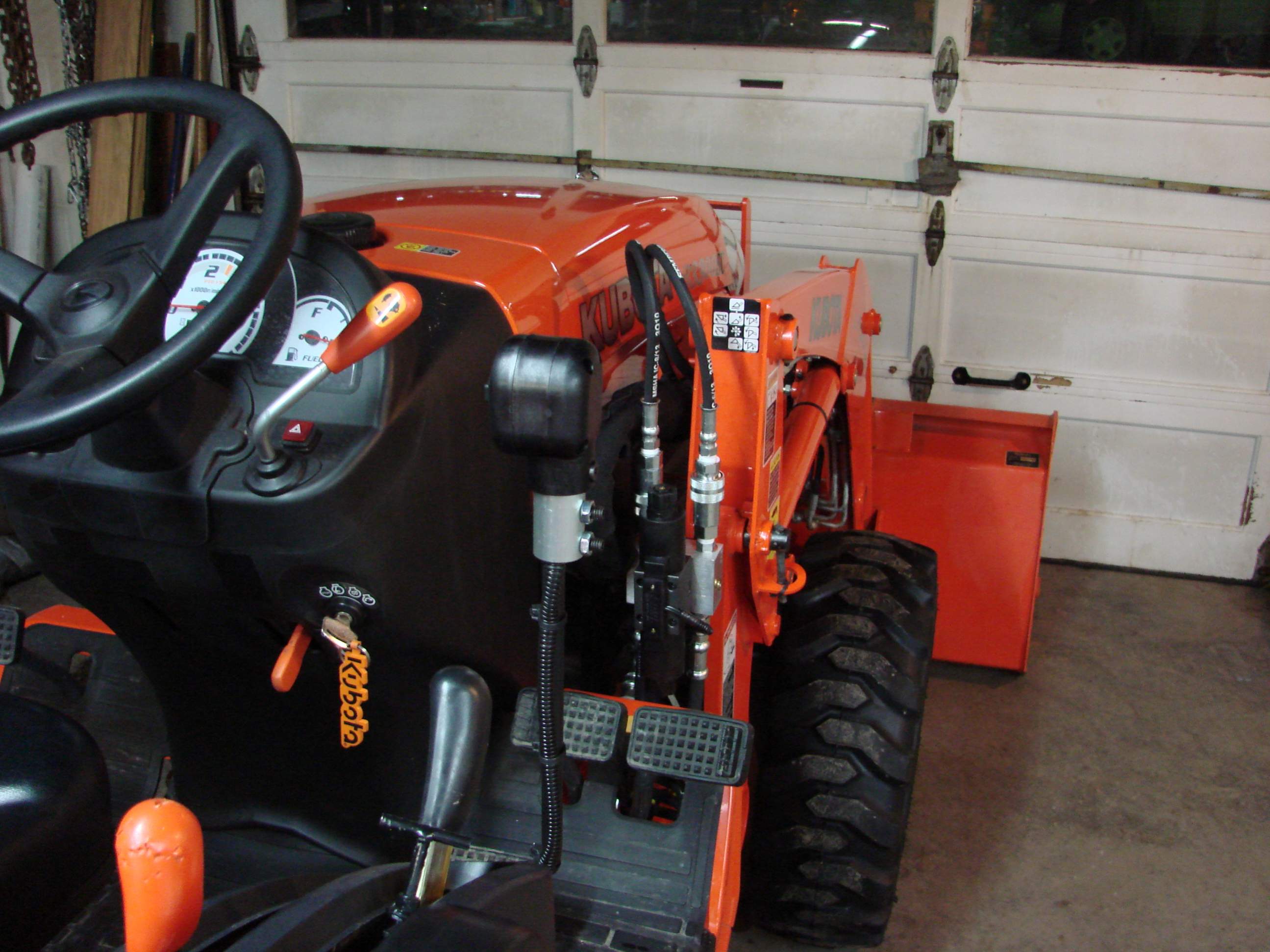

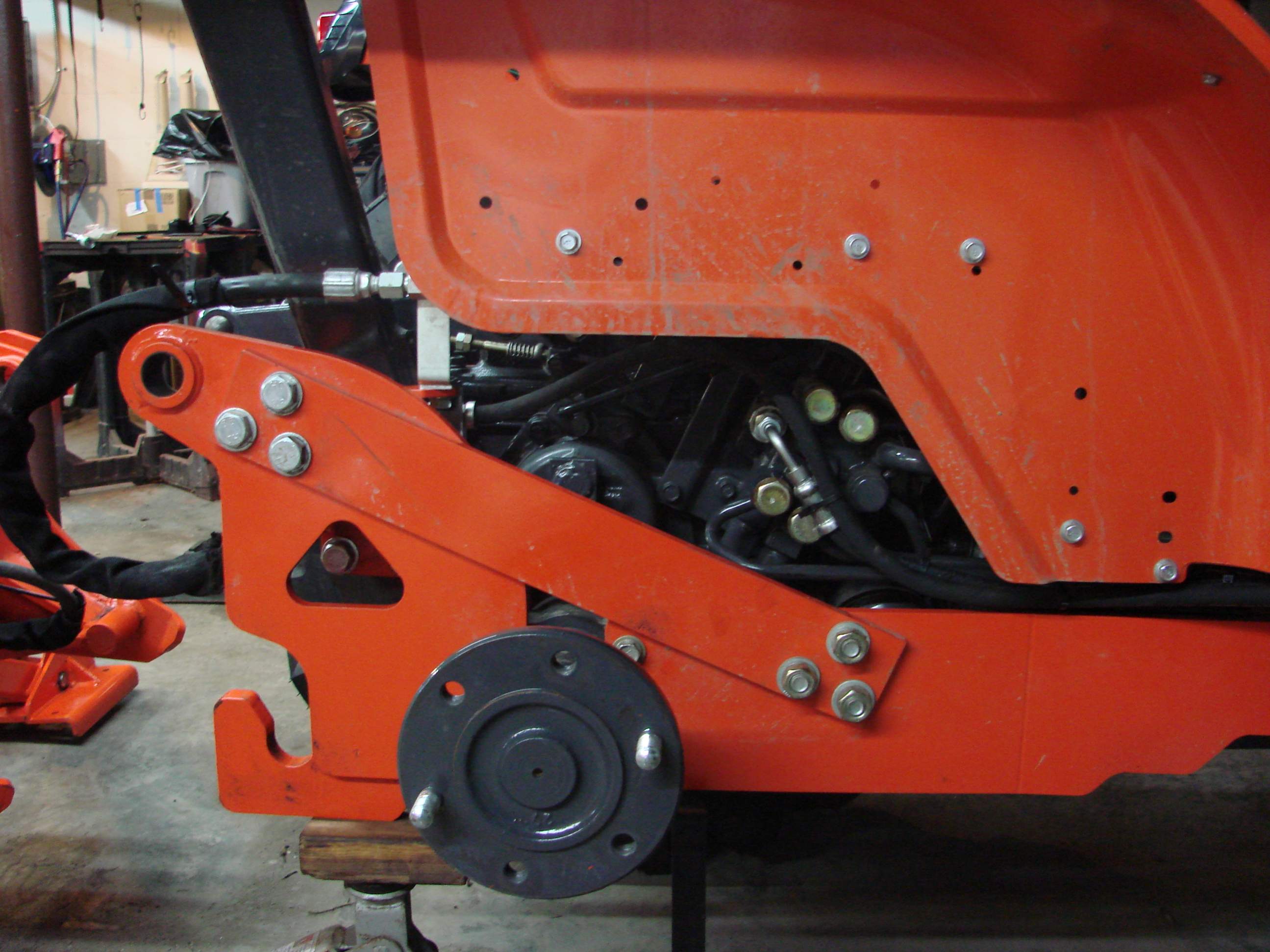

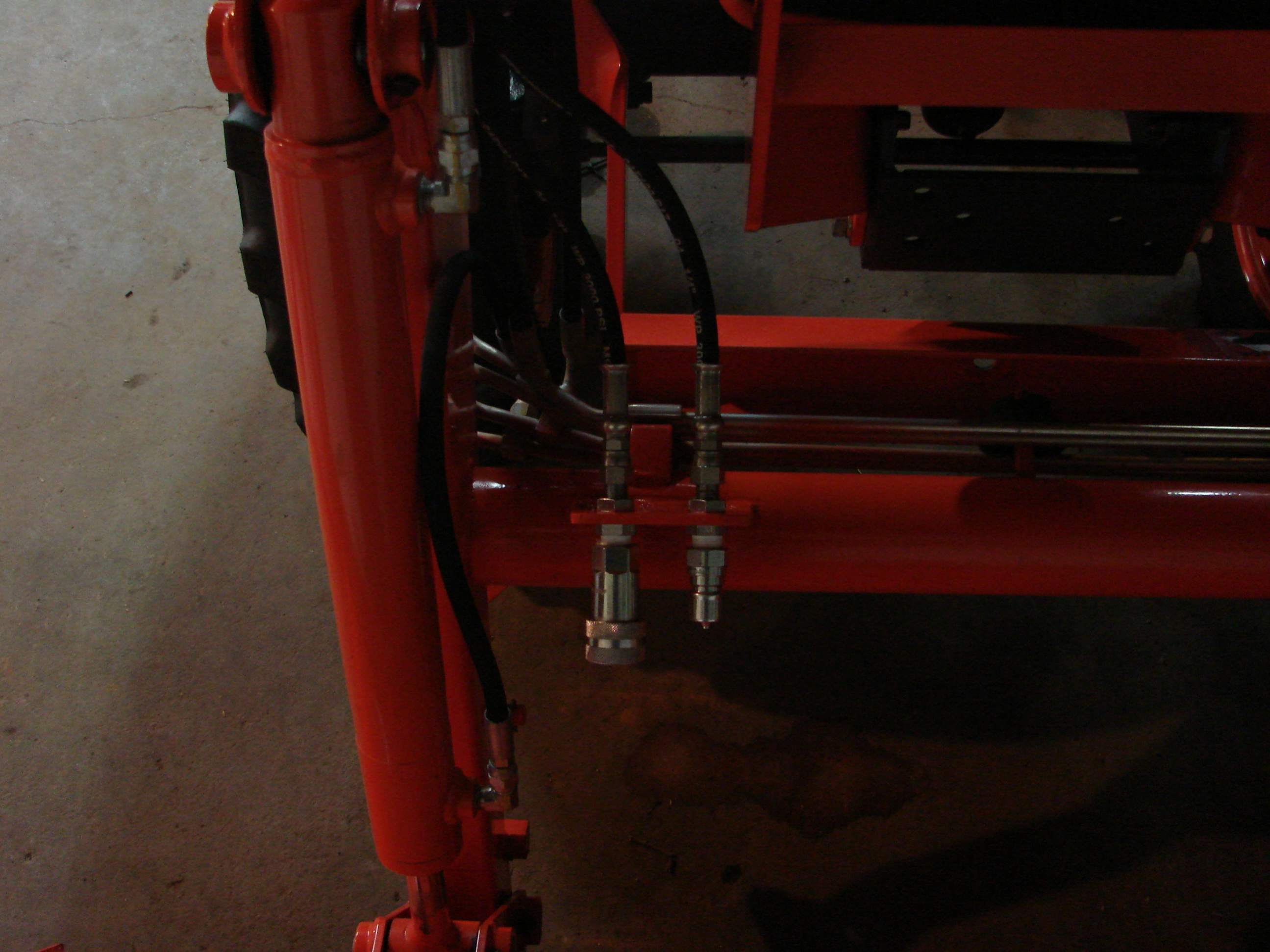

I just finished installing my 3rd function kit from wr long last night on my B3300. I shopped around and found Iowa Farm Equip. to be the cheapest place to order from. It showed up in 2 days.
I must say, I am very pleased with the overall function of the kit. It comes complete with everything you need, if you do not have a backhoe. Because I have a backhoe, I had to add in my hydraulic loop for that, but had to purchase one fitting. Very simple to do. The hardest part of the installation was taking off my loaded tire! lol
For all of those contemplating which route to take in adding a 3rd function to control a grapple or front attachment, I believe this is the only way to go. This kit from WR Long is complete with specific hardware for your model. If you are mechanically inclined and understand how these things work, you can purchase this valve and make you own kit for less money.
Next week I will be installing one on my nieghbors JD3320.
Hope this helped some.
/ Just installed WR Long 3rd function #2
Nice work............................. now post us some pictures or we won't believe you ! :D
Here are a couple pics.

Nice work! The more I read about these kits the more I want one...
/ Just installed WR Long 3rd function #5
I like it ! Very nice kit and good work there.

Thanks guys for the good comments. I am going to order the WR Long bolt on grapple this week. It looks to me that it is one of the best on the market for the money. Built very well and I can remove it if I need.
So...after the valve install, I used my tractor and noticed the right front tire was hitting the bracket that the WR Long valve mounts to. So, I scratched my head for a minute, tried to relocate it, but that failed. I ended up cutting an 1 1/2 off the bottom of the bracket. I then, very reluctantly, welded the bracket to my new tractor. I think it came out well. Painted it orange to blend in more and added another bracket at the top to strengthen things up.
I sent WR Long an email about this, as I am sure they would want to correct it. They are a great company.
I think the problem is that the LA504 also comes on the B3200 and that tractor has smaller tires that probably would not hit. Just my observation.

I did get your e-mail and I'm going to redesign the bracket. You are correct. At the time this valve kit was designed there was no interference. I run into these issues from time to time. For some reason Kubota, John Deere, Kioti, and the other Tractor Manufacturers do not call me when they make changes to their tractors and loaders. Thanks for the comments. If I don't know about these types of issues I can not fix them.
I appreciate your business and comments.
Nelson
