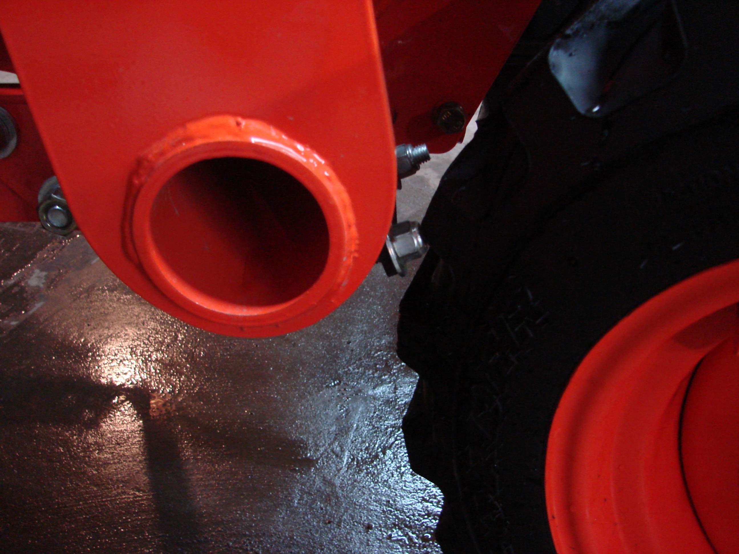

I've been told that the valve mounting bracket for the LA504 interferes with the right front tire on some loaders. I visited a Kubota dealer this morning to design a new bracket. I'm planning on using the 2 bolt holes that are located on a plate welded to the 4" round loader support tube. I'm assuming that these two holes are used to mount a support frame for the backhoe. I'm wondering if you could take a photo of this location so I can see how it looks. Also could you tell me how thick the material is. The did not have the backhoe attached on this tractor. Also, one more thing. Can you tell me how long the bolts are.
Thanks for your help.
Nelson Long
W. R. Long Inc.
