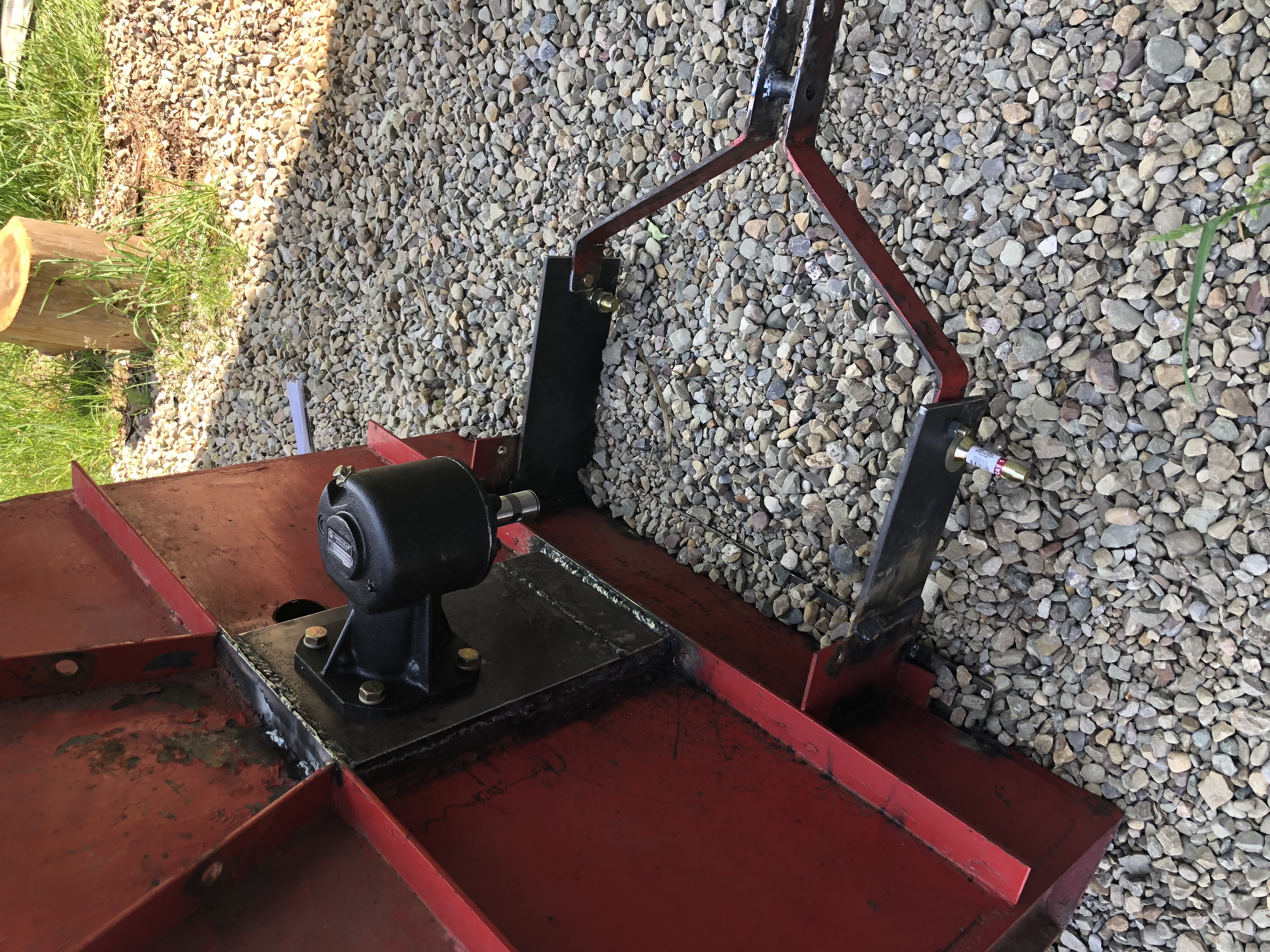

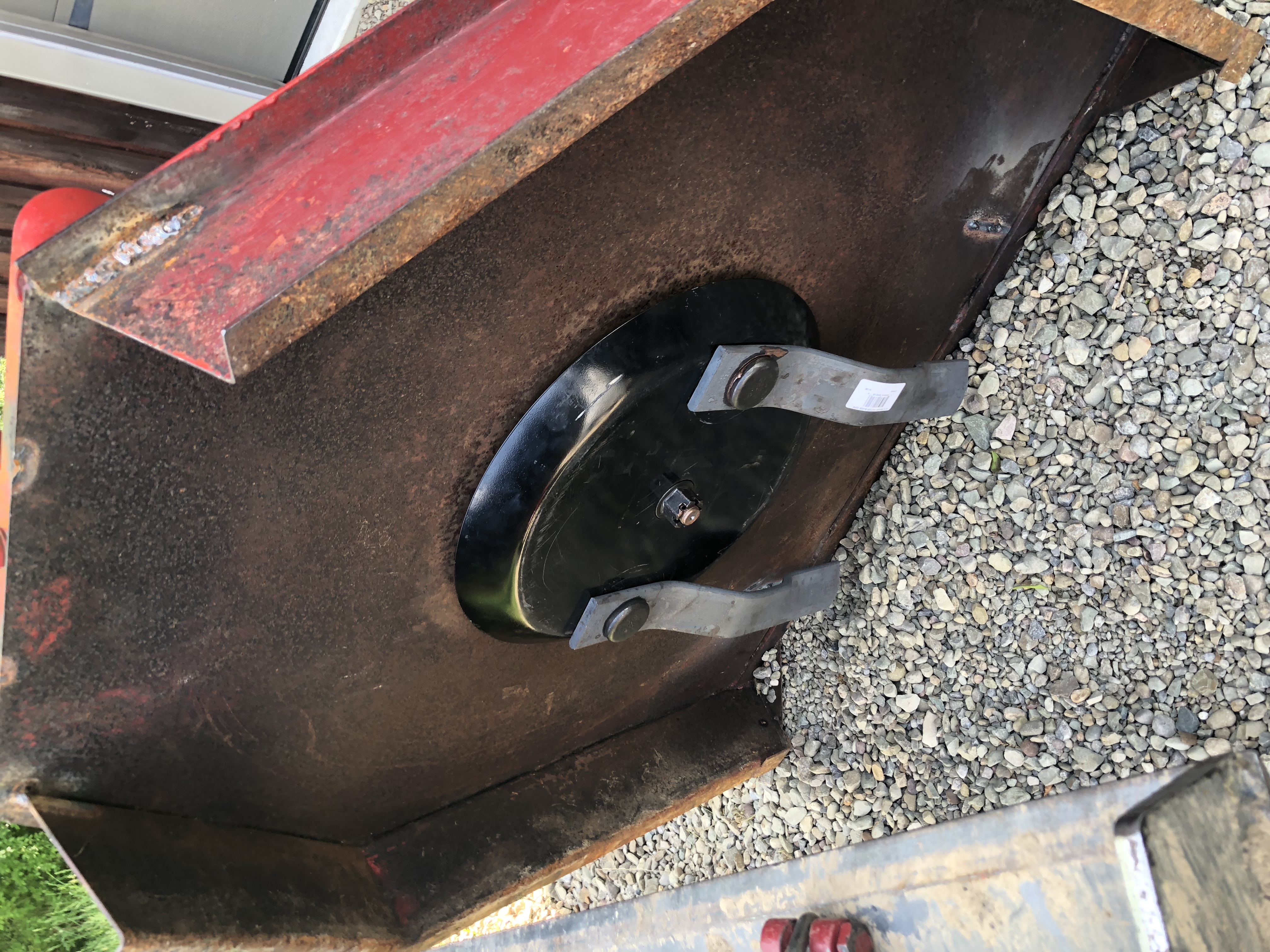

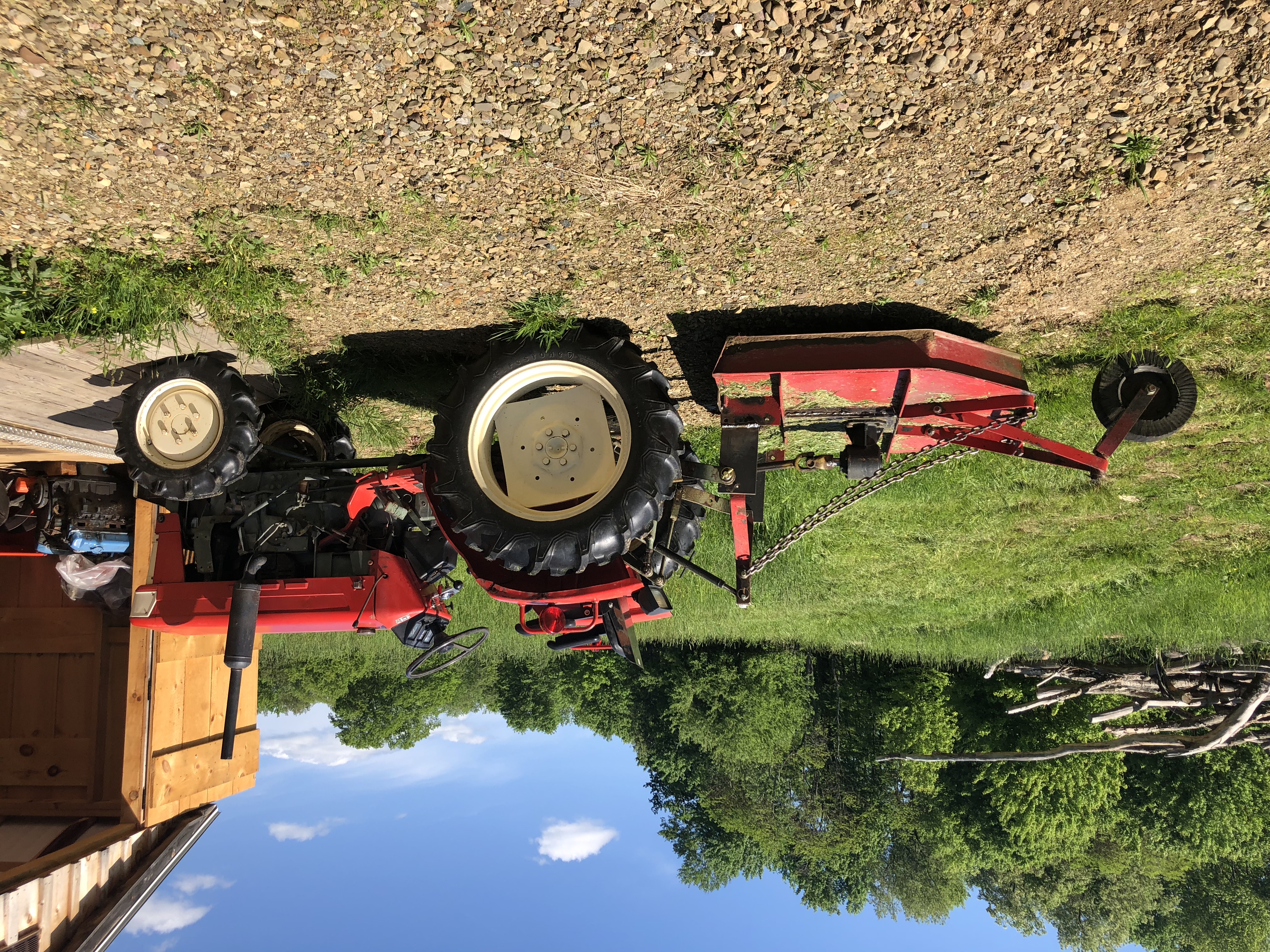

A42D1783-15CA-4B75-9634-CE817F9CD995.jpegCF864963-F511-42FB-B662-F0F4A7F36E50.jpeg3F741C25-97E2-4079-B88C-FFAA6DC5DBB6.jpegFinally got the brush hog finished today. Spent a couple hours trying it and the tractor out. Both worked very well. Have a lot of mowing to do hopefully next weekend if the weather cooperates.

Great job on the repairs to the brush hog. Man, I wish I could weld.
