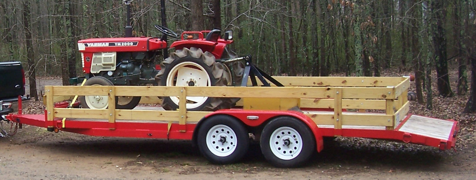

When I was moving the Yanmar around Daily Yrs. ago the D.Tail was the way to go. Depending on where I had to park was when or if I even had to pull the Ramps out! Not sure I still had it Clem.. I sold it and took a 16' and $ on trade with a full gate. Both the Mowers Barely fit. But I had to lift the wheels. Which was not that big of a problem. In laws needed that one which I let go because of it. I have a Dual Axel 20' still if I need it. Which I'm going change to a back gate if I used it a lot. Staying with a rear scoop to back up and dump on is what I really keep it around for. Which works Really Good. Both ways On and off and it holds "A Lot"...... I need to put a drop gate on it and then I won't hardly need to look back when backing up on it. One reason I even took the 16' on trade was the ramp. A couple inches and I wouldn't/couldn't of done it.........
This is good info here. I have a dovetail car hauler I use with separate individual ramps. I trailer maybe once or twice a year max. And can load without ramps at farm backing to the edge of the highway ditch and just driving on. At my house I can just drive off as well. And technically if I crank it way up in the front I can drive on without ramps

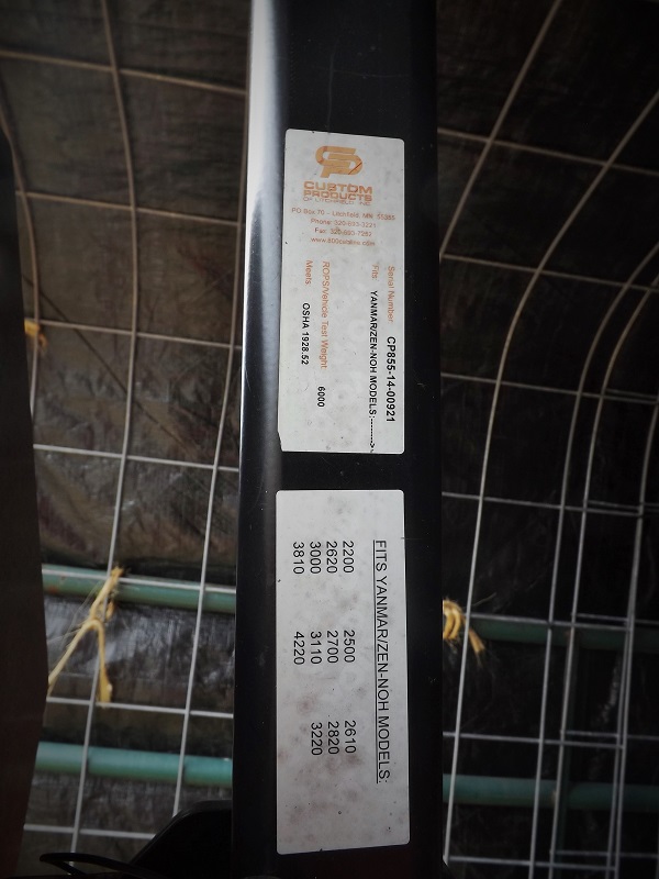

Not sure if you read a few postings back about getting a ROPS for you Yanmar. It's a life saver - literally. Fredricks has a bunch of them that fit all of our Yanmars and CUT John Deeres at a very attractive price. It's more than just the foldable type, it has seat belts and the PTO shield setup. Find the ROPS that fits your Yanmar here: ROPS Manuals — Fredricks Importing right down to the detailed drawings and mounting!
If any ROPS is still outside your ability to afford, then do quick search and find the National ROPS Rebate program for homesteaders and farmers. It will reduce the price by 70%.

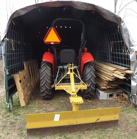

The other thing a ROPS is hand for ... A sun shade mount, lighting mount, behind the seat tool carry-all bin, mount the SMV sign, a place for the up-holder. :) I've attached my ROPS info pix on the YM2610 ...

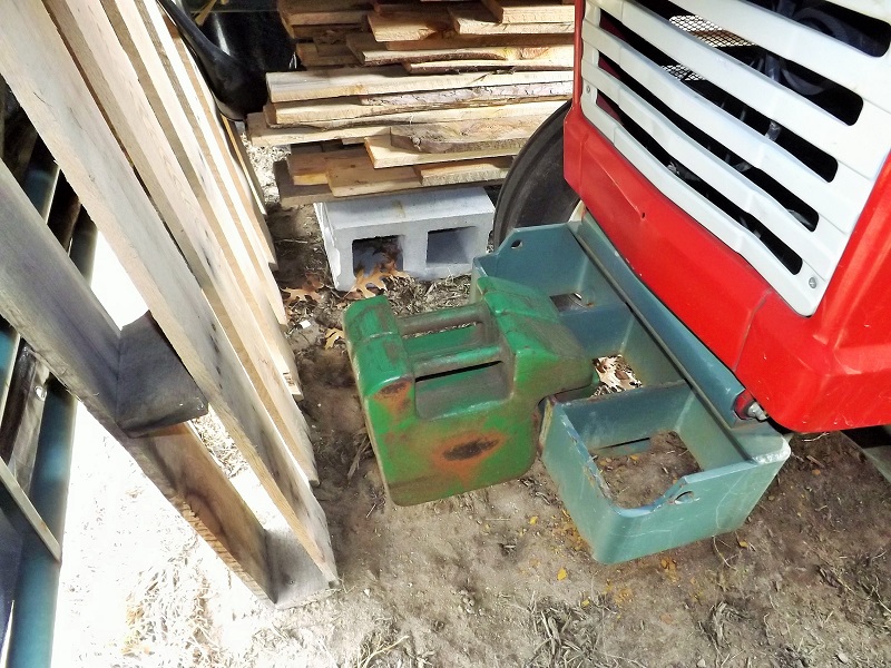

Another hand item to have are the front weights. The Yanmar CUT weights are identical to the John Deere because Yanmar supplies them. JD in green, Yanmar in black. Not sure why black and not pale green or Yanmar red. I've looked around and the majority were black.
Lowes has them for $64 each with FREE shipping to the local store of your choice. Unless you find a CL deal, it's hard to find these used at a lesser price. If I ever get time, it would be nice to make a 2D drawing of the mountable weight and make a simple frame mold to make these out of concrete. :) Of course concrete density for 20Kg is a larger size, so maybe using FreeCAD v17, I do a 3D model and adjust the size to match. hmmm. FreeCAD: Your own 3D parametric modeler

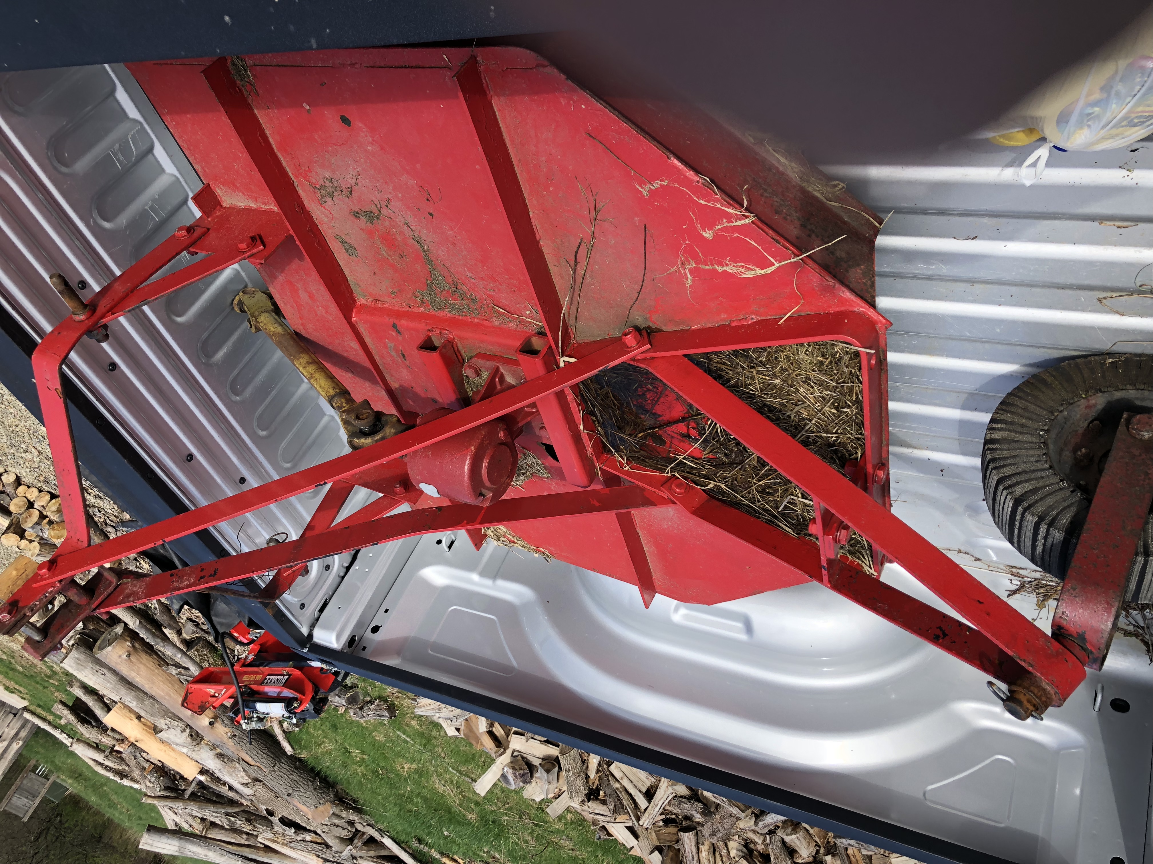

Thanks and yes I do plan to get one of the Fredericks ROPS. My place is pretty hilly and I definitely want that extra bit of safety margin a ROPS provides. I spent today properly tightening the head, adjusting valve lash, changing oil and filter, flushing cooling system and putting in new antifreeze, degreasing and steam cleaning engine. She痴 clean and purring like a kitten. I also picked up a lightweight 4 foot brush hog just for this tractor. I plan to use it for more controllable mowing near and around about 500 Norway Spruce that I致e planted over the last 8 years or so.
Nice brush hog. I couldn't find a 4ft in my region last summer, had to buy new a 6ft size. I wanted a smaller one to get in/out of tighter places.
Since it's used with no history of when the gear oil was changed, it would be smart to flush out that gear box and put new fluid in. This way, you know that you know if was serviced very recently. I typically flush mine out with diesel. First drain out the gear box, recap, fill with diesel and run the PTO connected just under 200rpm for a few mins. Not too long to get the gear box hot. Just enough to get the sticking gunk out. Re-drain, let it air out over night and in the morning refill with new gear box oil. If you don't want to wait over night to evaporate out the diesel, brake fluid works in a pinch.

The brush hog has a bent main spindle. I know the guy I bought it from and he said his brother hit a rock or a stump and bent the output shaft. So I paid $50 for it since the rest of it is in such good shape knowing that I’d likely have to replace the gearbox. Surplus Center has 40 horse gearboxes for $129 that I’m sure I can make fit. So for a little work and less than $200 investment I should have a good mower. I’ll dig into it in the next few weeks.

Yea those boxes are generic and it should work. I think it's all the same gear box. Agri supply sells one too.

Have the brush hog all torn down and have the gearbox etc removed. Welded up a few cracks and hammered things straight again. Have a new gearbox, stump jumper, and blades ordered. So once it all comes it should go together pretty fast. Field is greening up fast so I’ll want to mow in the next couple weeks.

The last item is your straps on the trailer/tractor. You always want ad close to a 45 degree angle as possible. A few suggestions there on a short trailer. Go from front if trailer to rear of tractor and to opposite sides if need be. Also can go from front of tractor to rear of trailer. Forty-five angle stabilizes side to side movement. Your rear straps would stabilize forward travel, but from what I see in the picture, I am not sure that rearward travel has much restriction.
