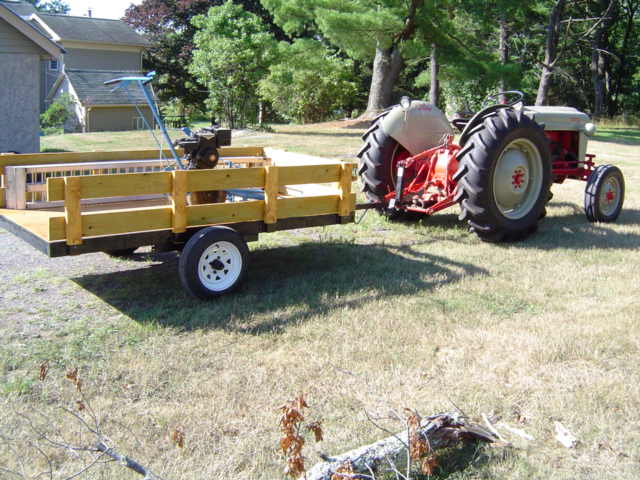

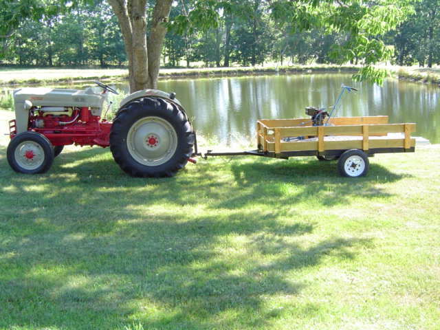

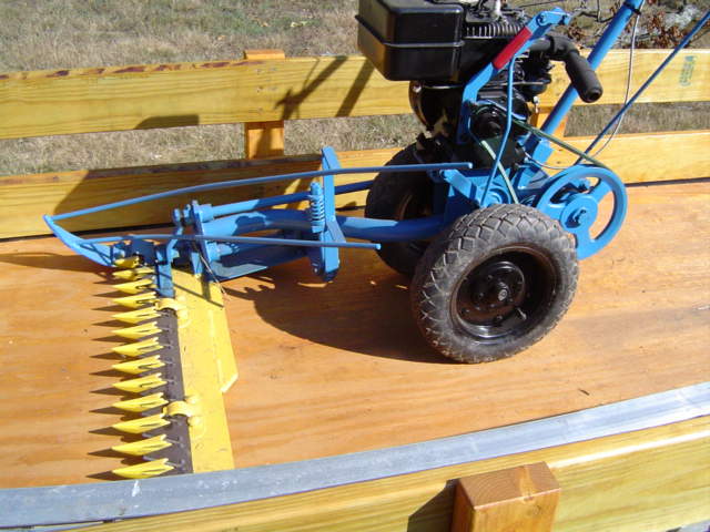

This should be the last installment on the trailer build. I replaced the oak tongue with 2" square tube and angle iron diagonals, which seemed to make it much more rigid. The additional pix are of the NAA Ford tractor, the National Mower Co., sickle bar mower and the trailer ... my 3 "Saving Old Iron" projects in the last nine months.

   / Just Saving Sime Old Iron #27
Looks good, you got to have a farm cart.
