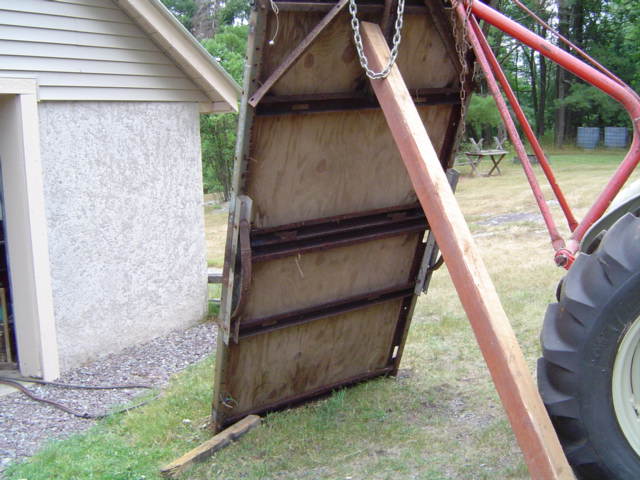

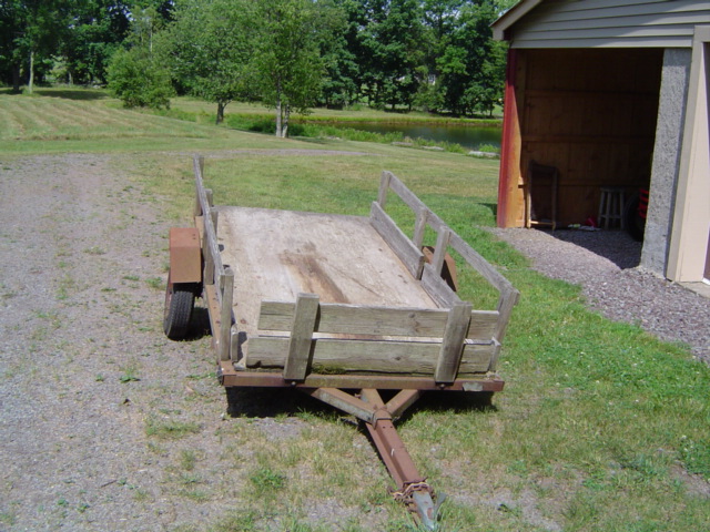

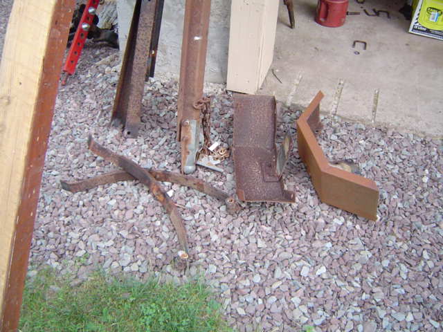

The "potential" wasn't as obvious, after I got into it!
Yesterday, I hauled two loads of brush, just to "prove it's need".

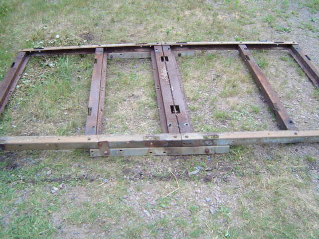

Yesterday afternoon, I took on the "restoration". I spent most of today in the hot blistering sun, burning off bolt heads.

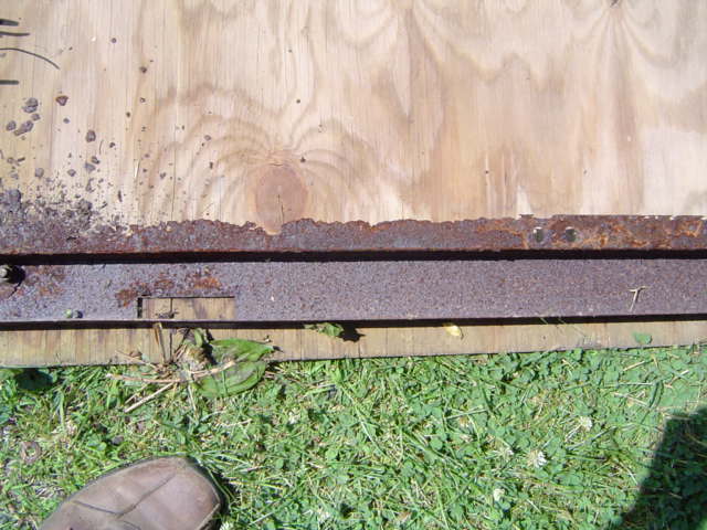

When I finished today, I hadn't salvaged much, except the outside frame rails.

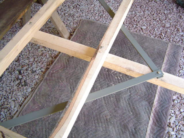

I can't find any metal "hat channel" with the same dimensions, so I believe I'll replace the bolsters with oak.
I still have to straighten the axle, and replace the wheel grease seals, races, bearings and dust caps. Plus, I believe, I'll get a new tongue.
After getting in to it, I believe, it was a "kit trailer".

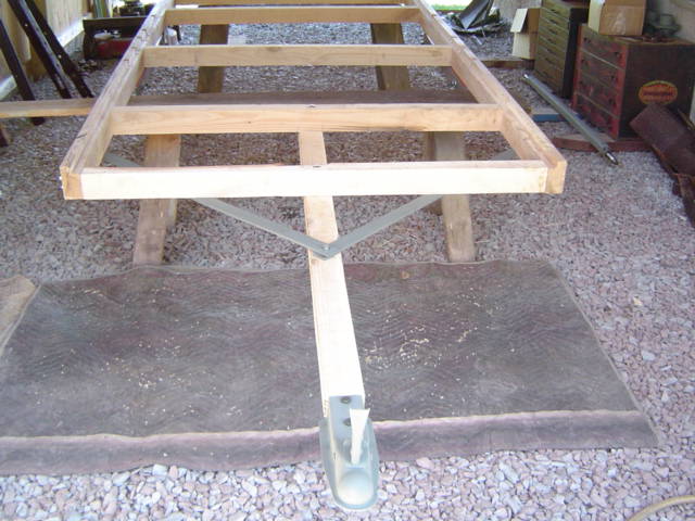

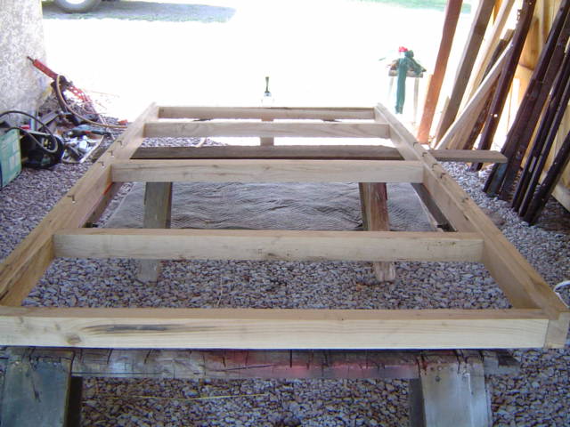

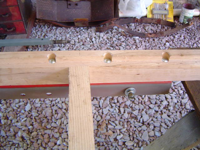

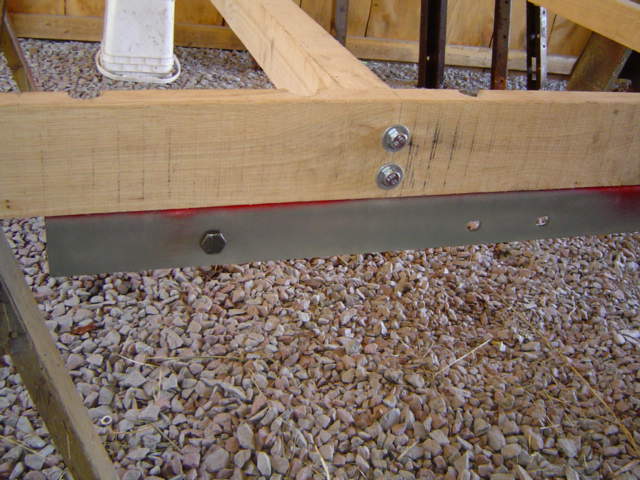

I think, this project is in the right forum ("Build-It Yourself"), but maybe the wrong thread ("Just Saving Some Old Iron"), as I haven't saved much old iron!

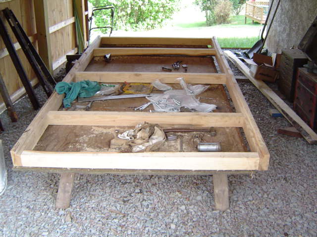

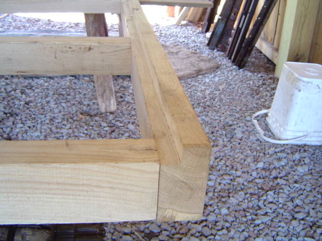

The frame is nearly done. I used full dimension 2x4 oak, some is cut down in size. The side rails are full, but have the inside corners cut out, to receive the 3/4" plywood deck. The hardware is mostly carriage bolts and lags, with a few machine bolts. The spring hangers are installed.
I have the springs to clean up, yet, the bearings, etc. to put in the axle hubs, post pockets on the front and sides and build the sides and paint ..... I think!
Frame1.JPG frame2.JPG frame3.JPG frame6.JPG frame7.JPG frame8.JPG frame4.JPG

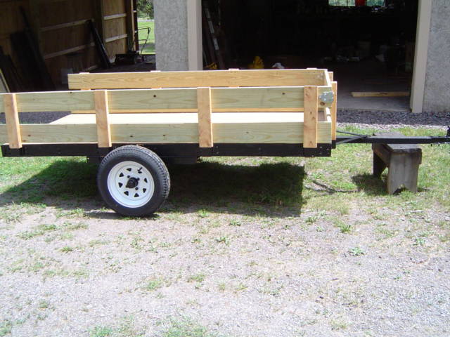

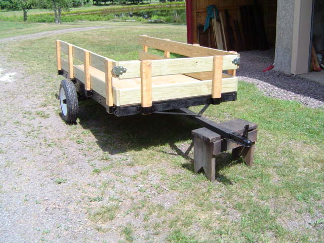

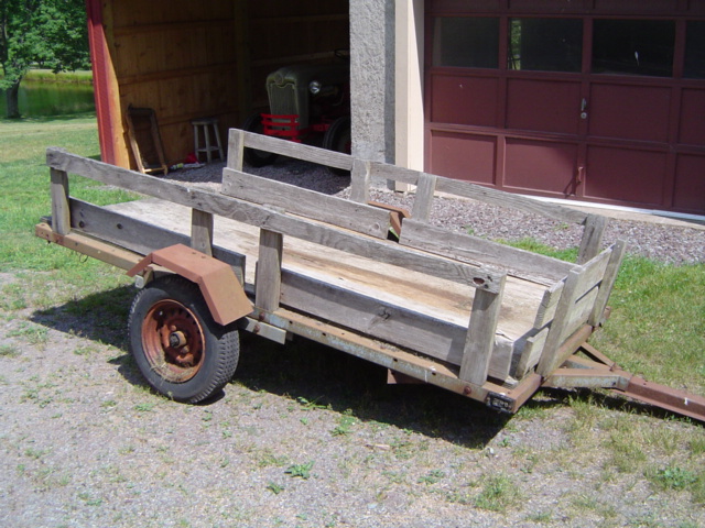

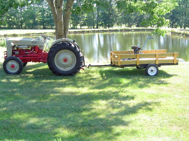

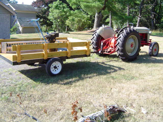

Before and after shots.
Well, it's all done, except for putting some deck sealer on it after the wood dries out. I had to get pressure treated for the sides, as they didn't have any 5/4 x 6" without. The only thing, I have reserves about is the oak tongue, but removing 3 nuts will allow putting on a steel tongue. It was more of a project, than I anticipated, to attain my goal. .... "A BEER TRAILER"!
