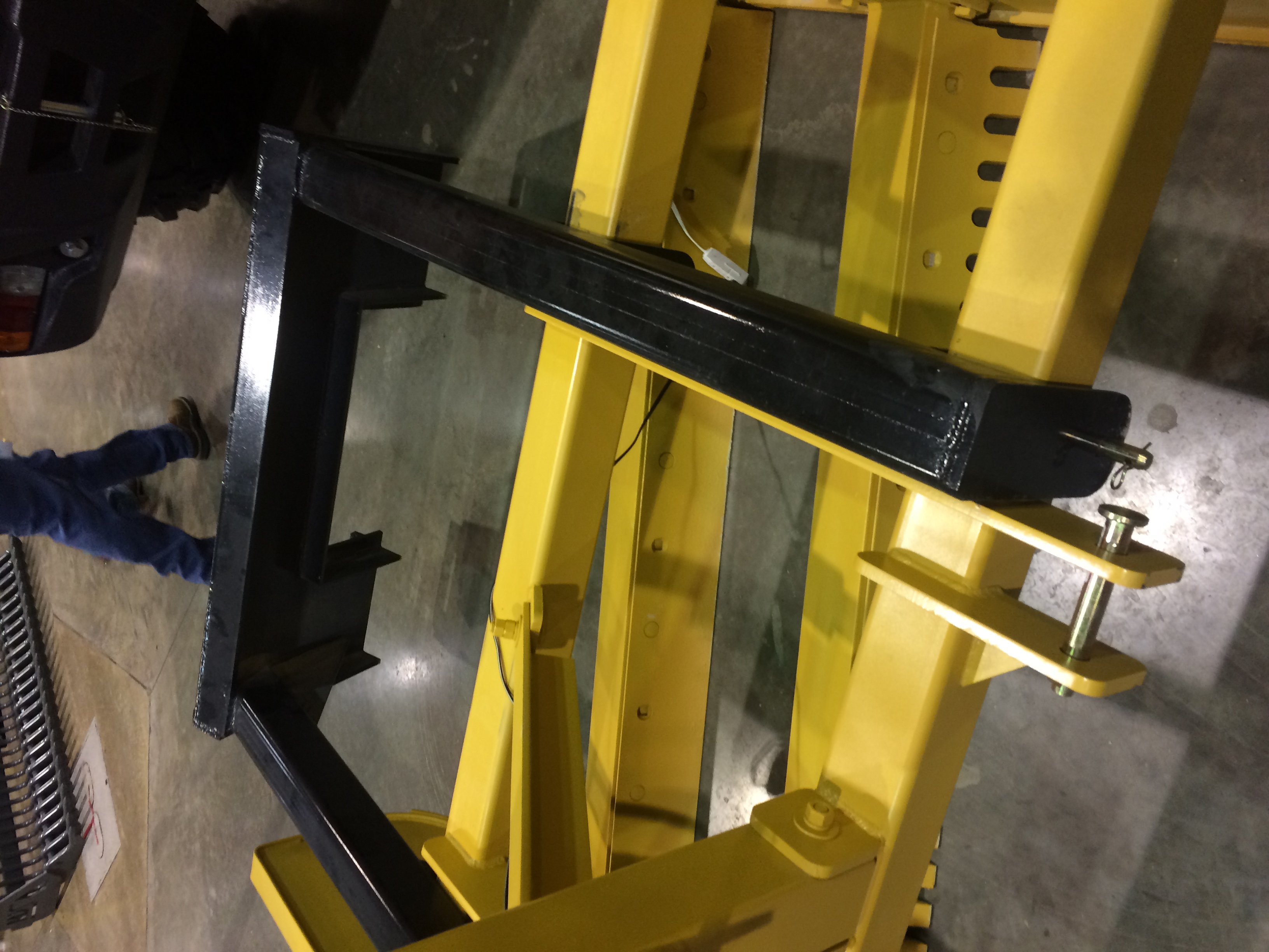

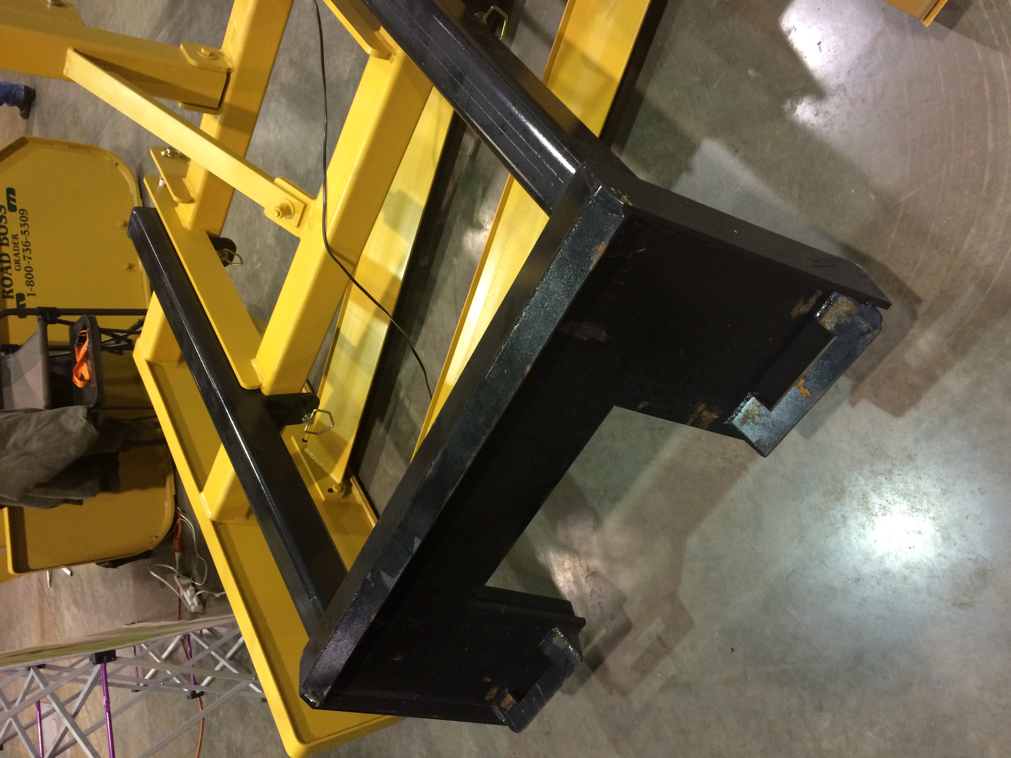

I wonder how effective a box blade would be with an SSQA attached to the backside so the box blade could be used (reversed) on the loader frame to move snow.
I have a few uses for a box blade but not enough to be worth buying one as a 3 point mount only. But I do get a lot of snow to move. If I were to setup a SSQA mount on the backside of the box blade for moving snow it might be more efficient/effective than using the bucket. I would still use my rear mounted snow blower for moving the bulk of the snow but in areas I can't use the blower, the box blade may be handy to have due to capturing the snow.
I am sure someone has already done this, if so, what was the results?

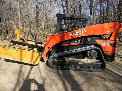

Don't move snow, but I saved this idea for pushing a box blade from Road Boss on a LPGS:
