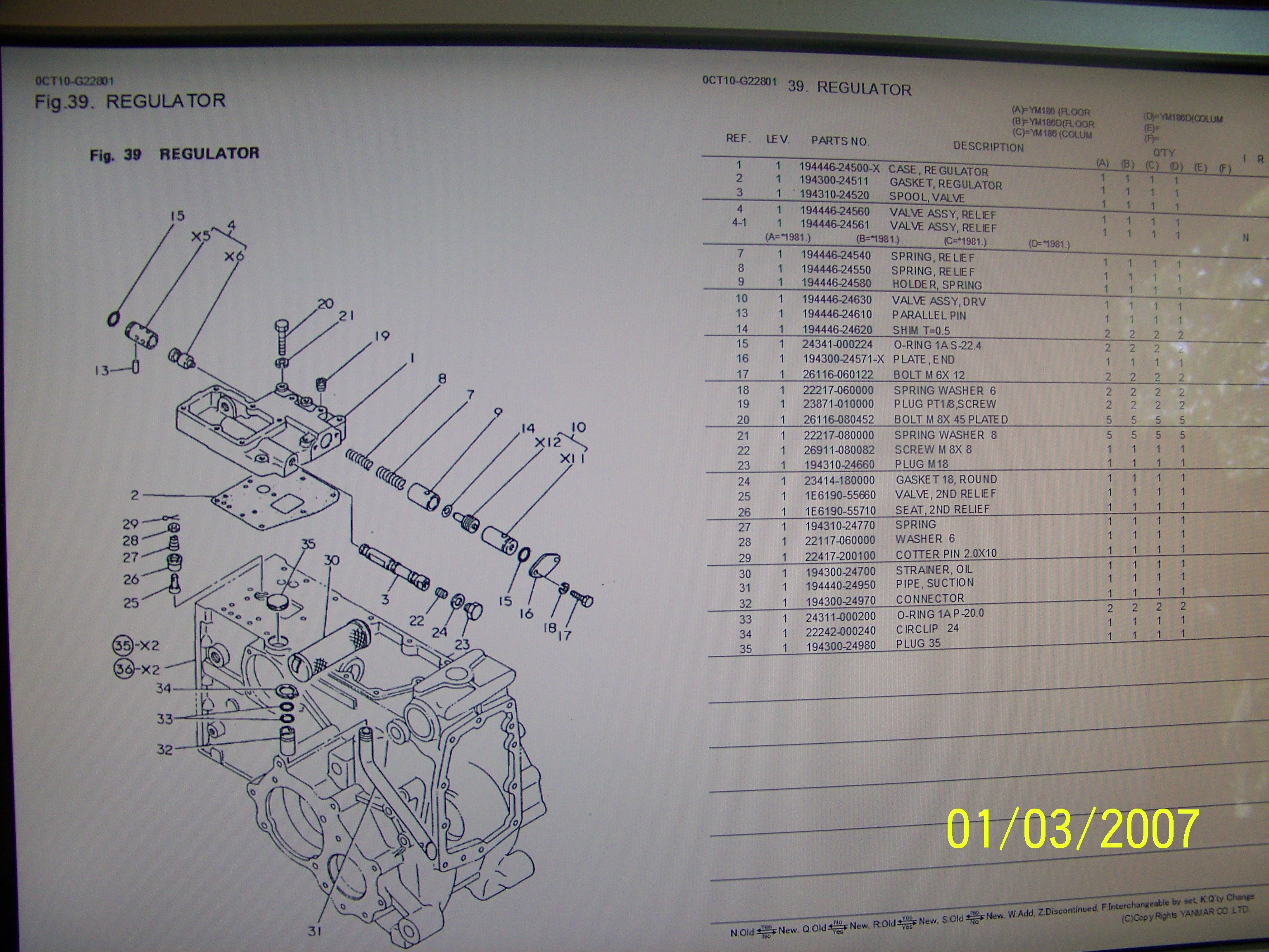

Can't tell you exactly where it is located, but every Yanmar powershift has it. Usually a plug with large screwdriver slot holding it in. You may need a parts manual unless someone has more info.
   / Just won't go #14
Here is a page out of the 186 parts manual. I don't know how close it is to the 187.

Put JD 303 trans-hydraulic fluid or equivalent in the tranny. Get ALL the heavy gear oil out. System will not work with that oil. This may require several flushings. Flush with your favorite oil/diesel mix or cheap trans-hydraulic fluid from some wholesale tractor shop. That will work fine.
The power shift has it's own internal hydraulic pump for both clutch pack pressure and forced lube pressure. They are 2 different internal circuits. The whole tranny is very, very clever. No, I've never had one apart...wish I had, though. They are nifty and I'd like to see one up close. Problem is that they are nearly bulletproof. You rarely ever hear of a power shift having a problem other than dirty filters. Although yours may require a disassembly and internal cleaning. But check the pressures first. The shop manual will give you complete instructions for testing the pressures of each circuit. In the manual, transmission mechanicals are in section 50, testing procedures in section 250.
Test the power shift pump pressure (1/8" NPT in top or side of regulator case, front plug is control pressure 200 psi, rear is lube oil pressure 6 psi).
From what I've heard over the years, if pressure is low or takes more than a half a second to build then it's either worn pump, restriction in the galley, clogged filter, or stuck relief valves.
