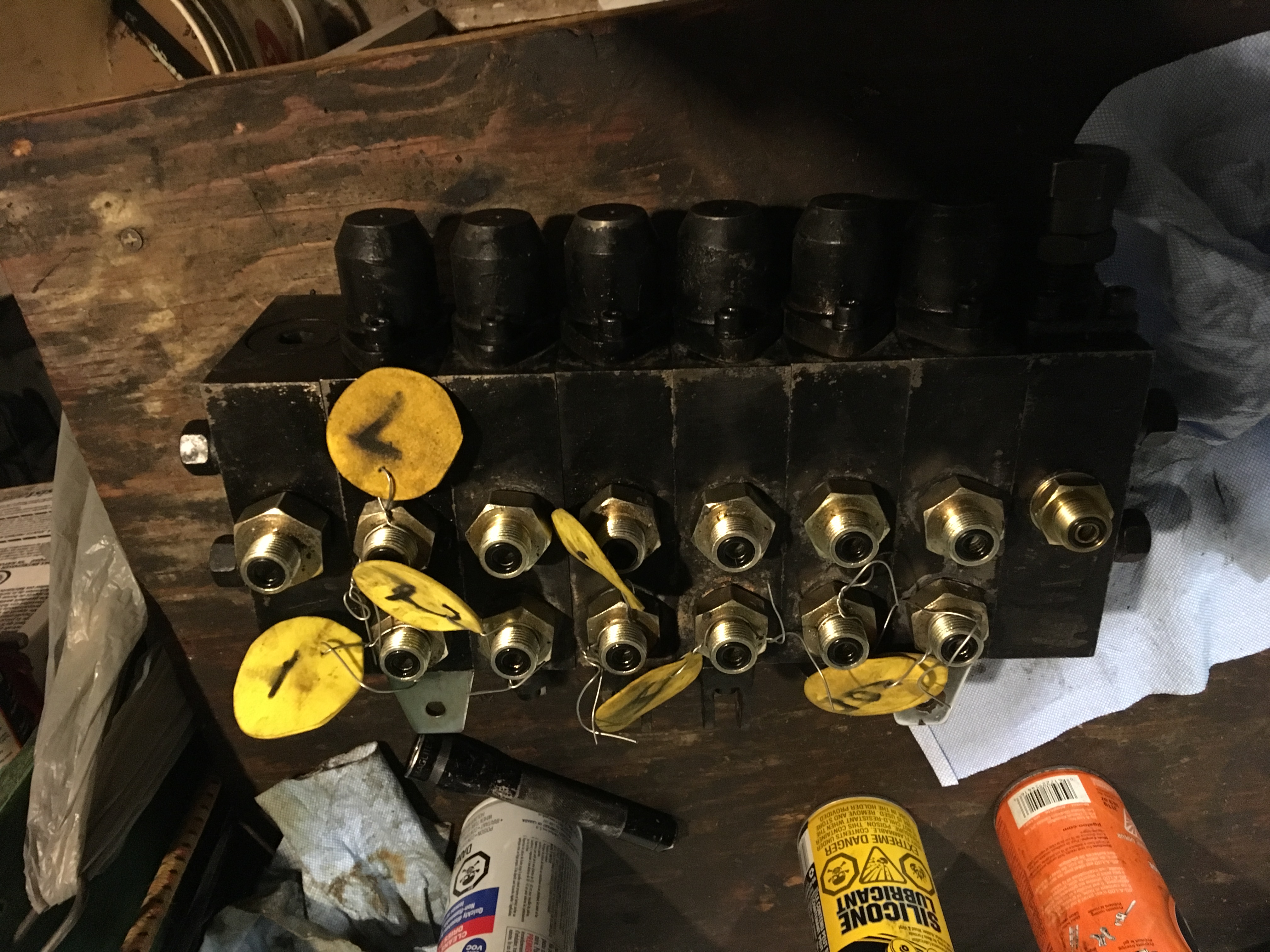

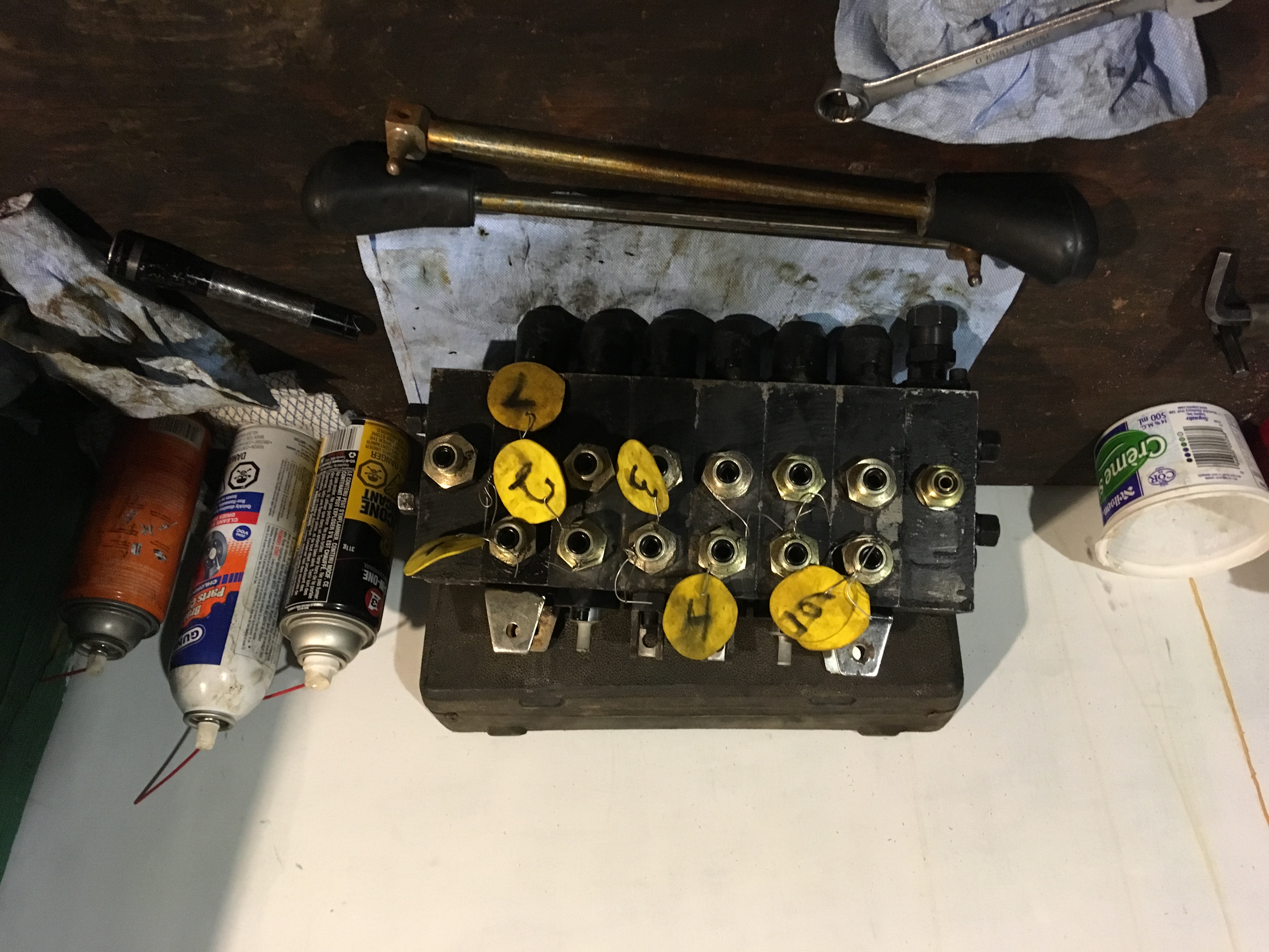

I used a 3/4 inch pipe threaded elbow which threaded directly into the tank and the filter head on the other end of it. From the filter head I attached a 1 in. rad hose which went on to connect to the control valve. I welded a pipe thread fitting onto the fitting that screws into the valve in order to attach the one inch rad hose to the valve. Those adapters on the ports , are they visible to the naked eye without taking anything apart? Sounds like you are saying the port adapters are screwed into the the valve and the o-ring face seal fittings screws into them or do I have to take the valve bank apart again? In the operation and maintenance manual I have a page that illustrates the backhoe hydraulic system assembly. This illustrates all the parts that could be seen without taking anything apart. I can see the o-ring face seal fittings on this page but I do not see the adapters. Am I missing something?
Yes, that is exactly what I am saying. Disconnect the hose end ORFS fitting and then unscrew the adapter. If you do this to both the swing circuit and the Dipper circuit(the one that seems slow/labored?) and look thru those adapters I think you will find the center bores are different diameters. Swap both small ones to the swing circuit and both large ones to the dipper...

Yes sir Ron. You made my day. You solved the problem. Like you said, the adapters on the stick boom side had very small center bores while the swing side had quite larger center bores so as you know, after switching them over the backhoe seems to operate normally. Thank you very very much for all the help you've given me on this project. I really appreciate this.
