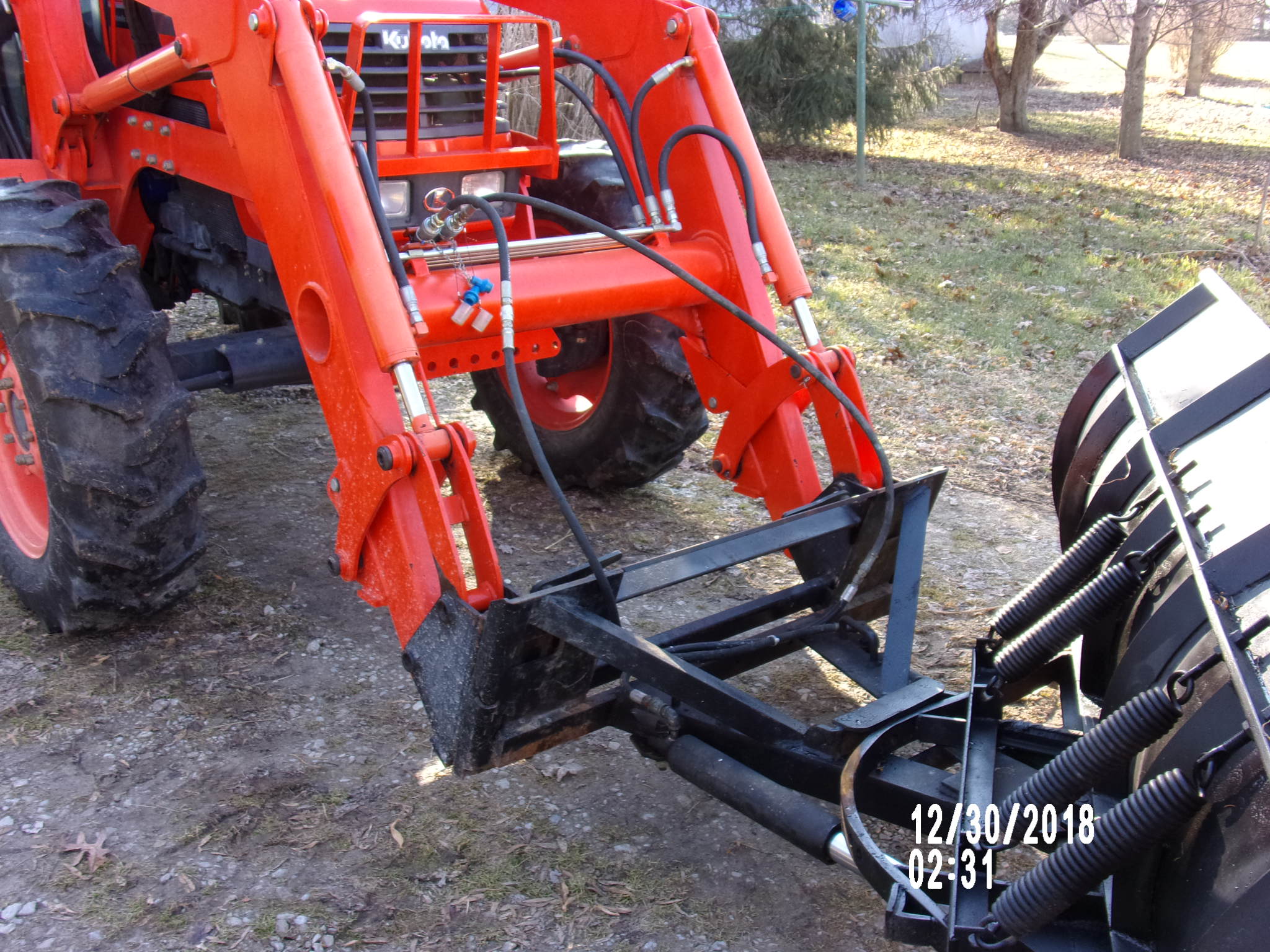

I did mine on the cheap on one of my Kubota's. It has 3 sets of remotes and the most I use are 2 sets at a time so I softlined one set with a QD split at the loader and fabbed up a bracket on the loader cross tube. When I need the loader remotes, I connect the hoses and use the remote valve to run what I need run I think the whole setup was about 150 bucks and my time.

Npt really, just measured what I needed from the rear quick disconnects to the loader valve, made a carrier bracket from some flat stock and installed male Pioneer QD's. Ran the hoses through the Kubota sheath up the loader arm to the cross tube and welded on another bracket with anoth set of Pioneer QD's there. The other ends of the loader hoses have female Pioneer ends. Got all the hoses at hydraulic fittings .com and all the Pioneer couplers at my local NH dealer (had them all in stock. Even used NH blue plugs on the loader end. Blue goes nice with orange... I use one of the in cab remote valves to control the function of the remote valves on the loader.
