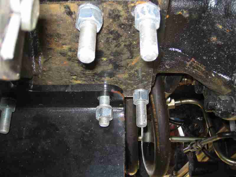

Based on what I read here, yes it seems to be a common problem. the 4wd/2wd lever is held in place by a ball in a grove on the shift rail that is held in place by a spring. I would check the ball/spring, spacer to make sure it is properly installed. When proper, the lever will "click" into position as you hear the ball drop into the grove on the shift rail. Reasons for the problem could be that the spring is too weak, the shift rail is not travleing far enough for the groove in the rail to get under the hole wiht the spring and ball in it. or the spring and ball could be missing, or just the spacer which puts more pressure on the ball could be missing. Or the rail could be improperly installed so that the groove does not line up with the ball/spring/pin assembly...

Hey guys,
I had the same problem .... slips out of 4wd so I made a bracket like CaptainJack refers to. But I was thinking, if you can get any automotive bracket that has a curve on it like for an alternator or powersteering pump, I think that would work too. Get a Knob with threads and a nut and wahser. Take one of the bolts out that hold the shifter cover down and bolt it on there.
Here's a picture of mine....Knob Side
This is the shaft side that hits the 4wd lever and keeps it in place.

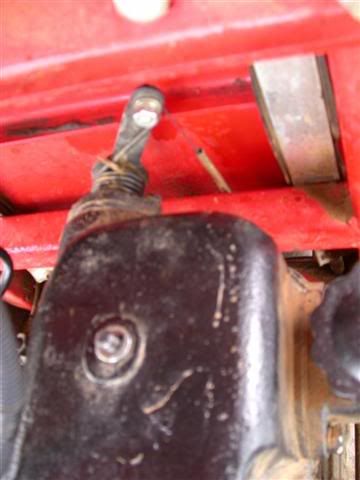

Could you help me out regarding how your decompression actuator is plumbed? Maybe a picture or two; one at the valve cover and one where the actuator/pull knob? is located. Warm weather starting is instantaneous, but it believe it would be helpful in really cold weather and when you wanted to manually turn the crankshaft when setting valves for instance.

Do you have a cable/knob for the decompression? There is a lever on the back of the valve cover. The spring on it keeps it in the off position. With gloves, rotate down. Now you have pressed down on the exhaust valves and decompression is obtained. The cable comes from below and as you pull the knob it pulls the lever down. Mine has a simple nut/washer to clamp the cable.

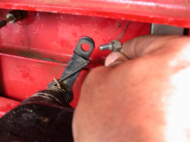

CaptainJack,
Here is a picture of the decompression lever on the back of your valve cover. There should be a cable connected to it via a nut/bolt. Mine was disconnected when I got it. Loosen the nut/bolt and slide the cable through the hole in the bolt. Pull the slack out of the cable and tighten the nut. When you check the pull knob, be sure there is a little slack in it so you have not accidentally set it too tight having the decompression lever slightly activated. Hope that helps.
In this picture, the nut that holds the cable is on the lever. Never mind that I am taking the bolts out (I am removing the lever arm to remove the valve cover to do the valve lash adjustment)
This one shows the bolt that has the hole through it for the cable which is connected to the knob on your dash.
This one shows the cable connected to the lever arm of the decompression rod.
Oh, and the actuator pull knob is down low on the left side of your dashboard. Actually below the dashboard. It's about the same elevation as the "kill" switch only to the left of it...
