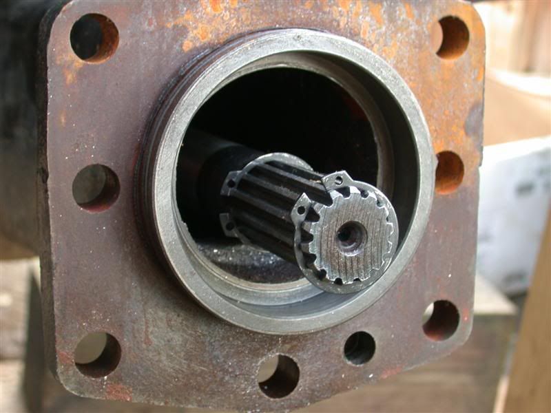

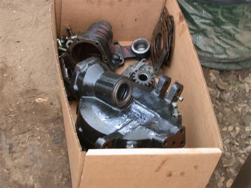

Well, I finally got my Kama completely repaired during that period where Loretta's tractor arrived. It has been a hectic several weeks to say the least. I have some photos, but unfortunately none technical enough to show the step by step repair taking place.
Then on the other hand, some of you are probably saying Thank God for that!:) hahaha

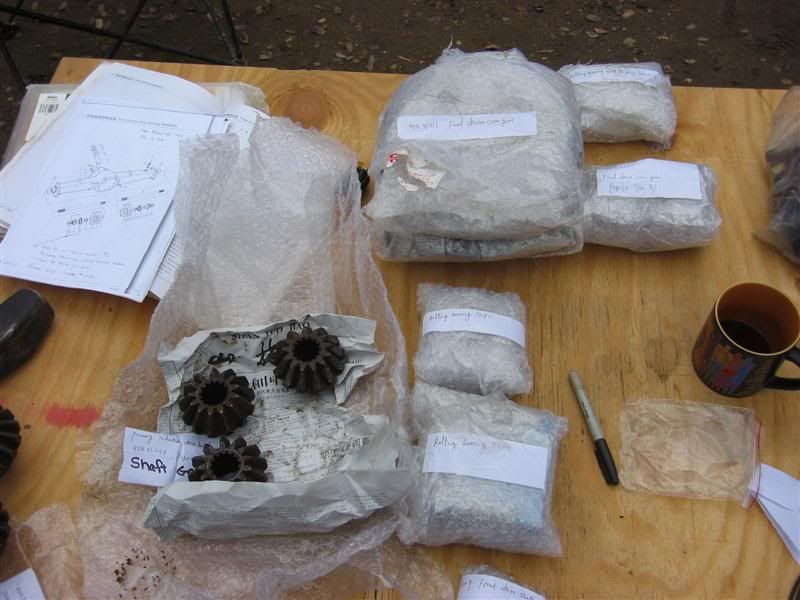

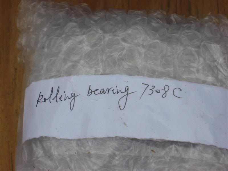

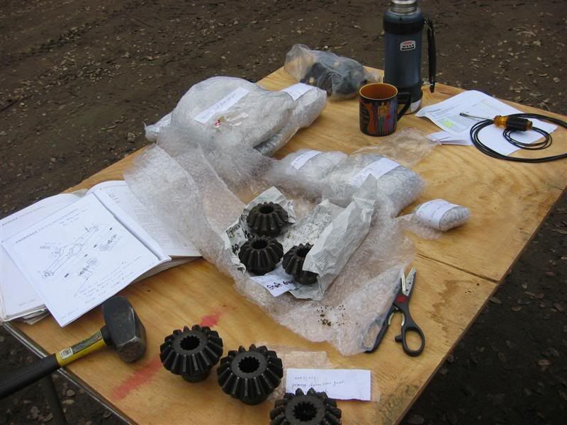

Anyway, I got a bunch of gears, bearings, shims, seals and stuff for the repair. But as I said earlier, the only real damage was to the two sets of miter gears. Both the left and right drive axle and reduction gears were replaced. I also replaced a couple bearings that might have had some shavings in them, just to be sure. Then also all the "O" ring seals and a couple retainer clips.

Prior to that, Loretta and I spent an entire day cleaning the other gears and components and getting them all organized for the re-assembly. This turned out to be a major PITA as I soon ran out of room and tables. There were a lot of parts that I needed to "look at" so I'd get the assembly done in the right order.
