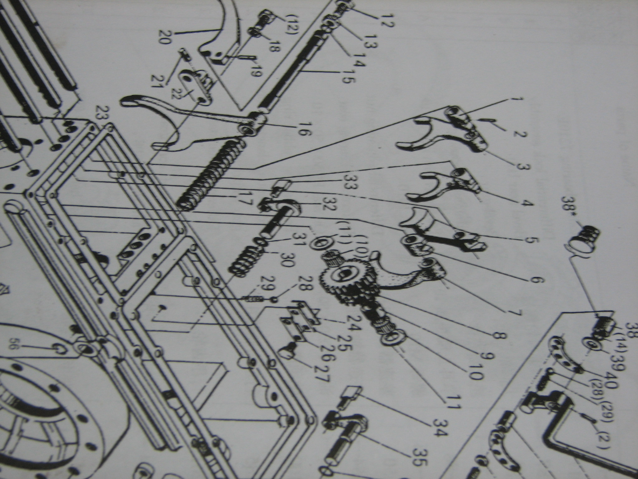

Pics from KAMA parts manual. Could you point to a part number and picture number and tell which snap ring I'd be looking for? How do I get inside the case?
Does the whole rear end, etc have to come off???????

The area I have seen this problem in on another tractor is in the Mid connecting housing (page 15 of your parts book if you have the same edition I am looking at) the problem on the other unit was snap ring 6 was out of place, allwoing gear 4 to slide back and forth. this is the idler gear that works with gear 16 to make reverse. To tear down this box you split the tractor, then remove the steering system and anything else attached to the bellhousing area. The mid connecting housing can be unbolted from the transmission/diff housing, rear axle assy and benched for dissassembly, repair.
Sorry for those interested in this thread that dont ahve the book. I don't have all the scanning/picture posting skills to be very impressive on these boards. I did hear that a picture is worth a 1000 words, but i have not found that I can use 1000 words to describe something very effectively...

The problem might very well be as you described Chip. And if I'm all wet, I won't be offended if you tell Jeff to ignore my suggestion. But I recommended to Jeff that he split it between the mid-connect housing and the tranny. That will initially avoid some of the additional dismantling associated with splitting one box forward. With the shuttle box isolated from the tranny, perhaps a little rotational troubleshooting can further isolate which box the problem's in. If it turns out to be in the tranny, he's saved some dismantling and reassembly work.
Since the mid-connect housing internals are not accessible through the bellhousing anyway, why take it off the engine? I understand it's necessary for shaft removal, but why to check for/relocate a misplaced circlip? Breaking between the mid-connect and tranny will expose the aft end, removing the shift plate will expose the top, removing the transfer case expose the bottom.
But I don't know where "snap ring 6" is located in relation to any of those three openings.

I was able to determine the snap ring #6 as Chip described, is the offending item. This was accomplished simply by removing the shuttle shift cover. Any idea the internal diameter of the snap ring? If I work at it, I may even be able to slip that sucker on without dismembering the thing?? Wish me luck.
Thanks

Looks like 25mm
//greg//
/ KAMA TS254 Reverse problem #35
If you can, you are better than my guys (its pretty far down there) but definately worth a try! is the bearing still intact under that gear? if so it will be fixed if you replace the snap ring. On the one we had, the missing snap ring allowed the bearing to slip out (caged needle bearing) and the gear and shaft were ruined, necessitating the total dissassembly. (I think that shaft does come out fht bellhousing side if I remember correctly. We benched the complete housing, but that does not mean it is necessary. My experience is that short cuts usually end up in back tracking and going the original route anyway, but others have better luck. Wishing you the best of it (luck)! I can measure the shaft on monday to determine snap ring size.

I must be living right. I was able to slide the roller bearing into the idler gear and push the snap ring back in place and all is working correctly. I used two long screw drivers to guide everything into place.Total time for the job was about 30 minutes!!! Replaced the shuttle shift cover, and away she went.
