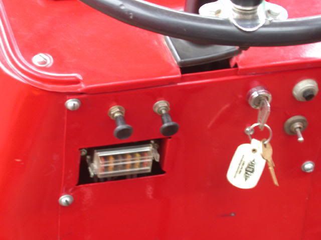

After testing every circuit with my amp meter, I was able to determine the exact amperage fuse required for all the circuits.
NOTE - YES you can us a clamp on DC amp meter to measure current draw.
I then installed the appropriate fuse to protect the circuit being fused.
Here is the finished product:

The New ATC fuse block fit PERFECTLY after drilling two new holes. I also installed two standoffs to move the new fuse block away from the metal and more forward for ease of fuse inspection and replacement.
Here it is installed ready for wires:
