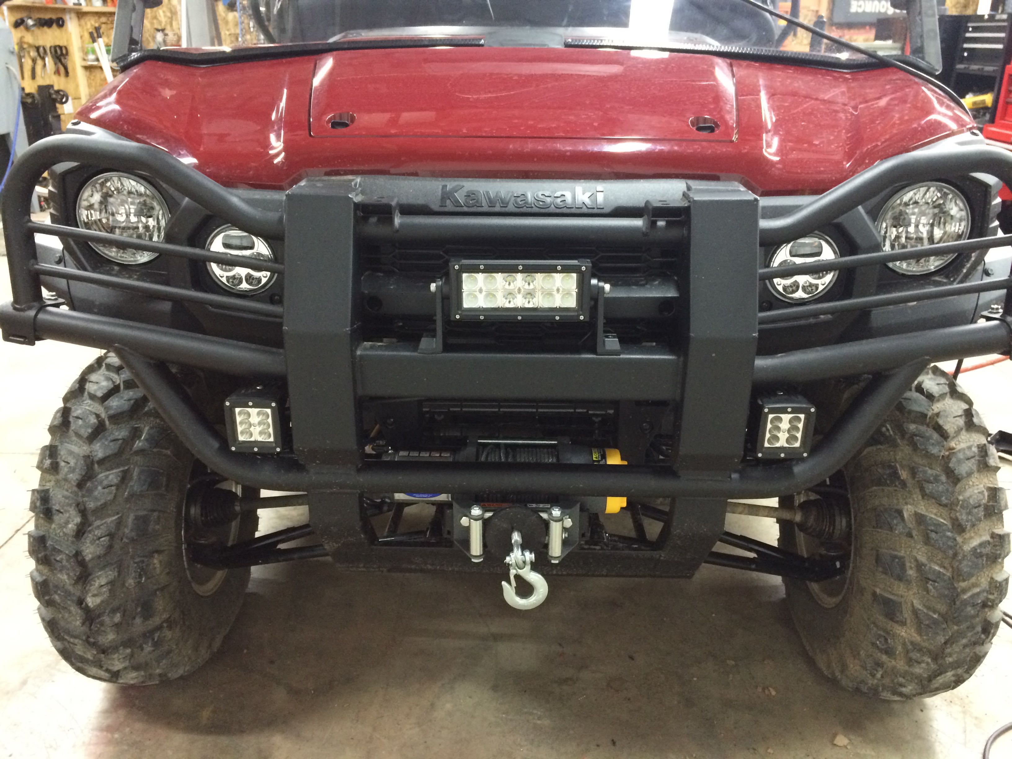

CODE54 - Any chance you could post some pictures on your winch? Did you do an aftermarket fuse box?
   / Kawasaki mule pro 2015
#52

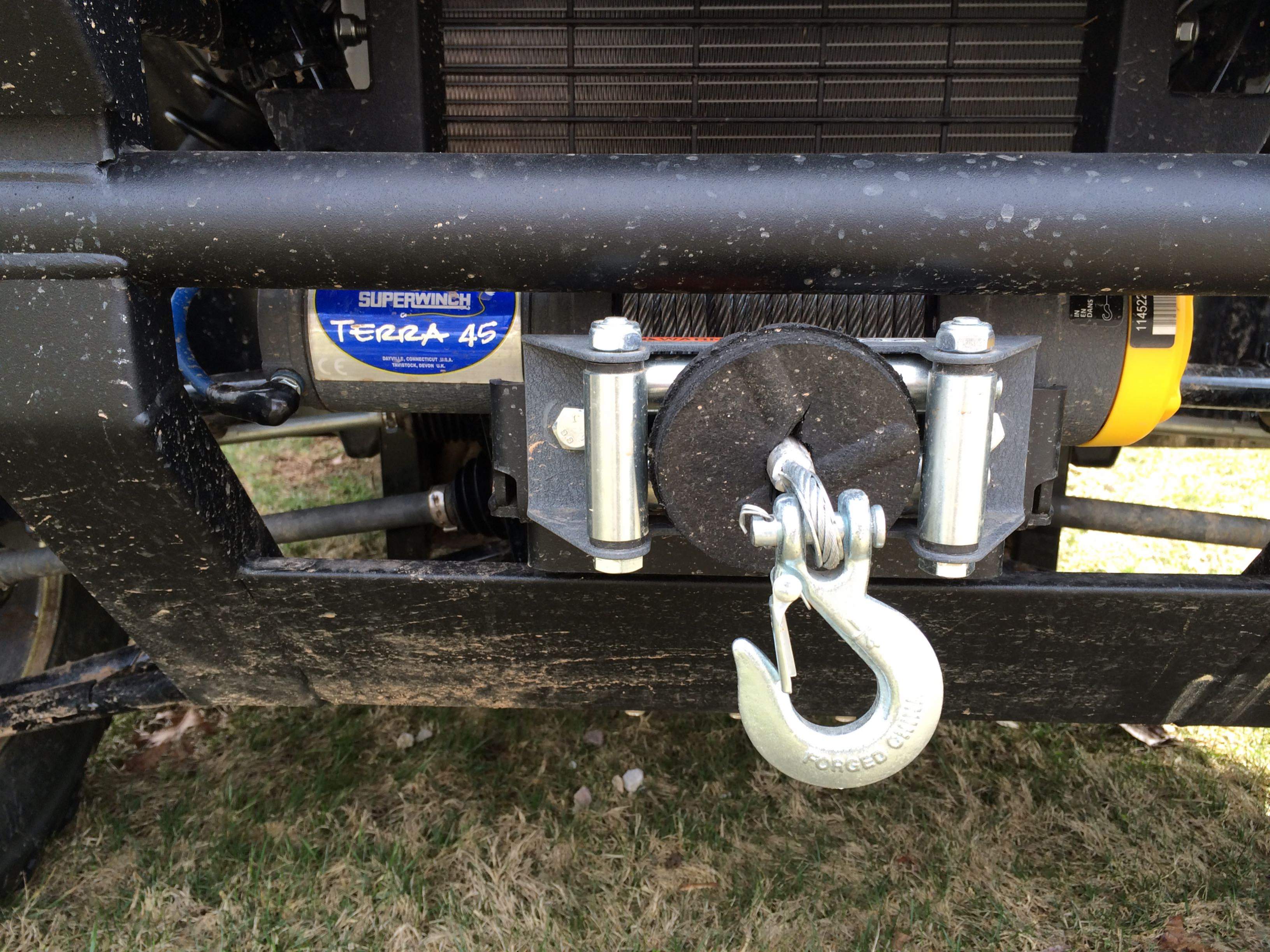

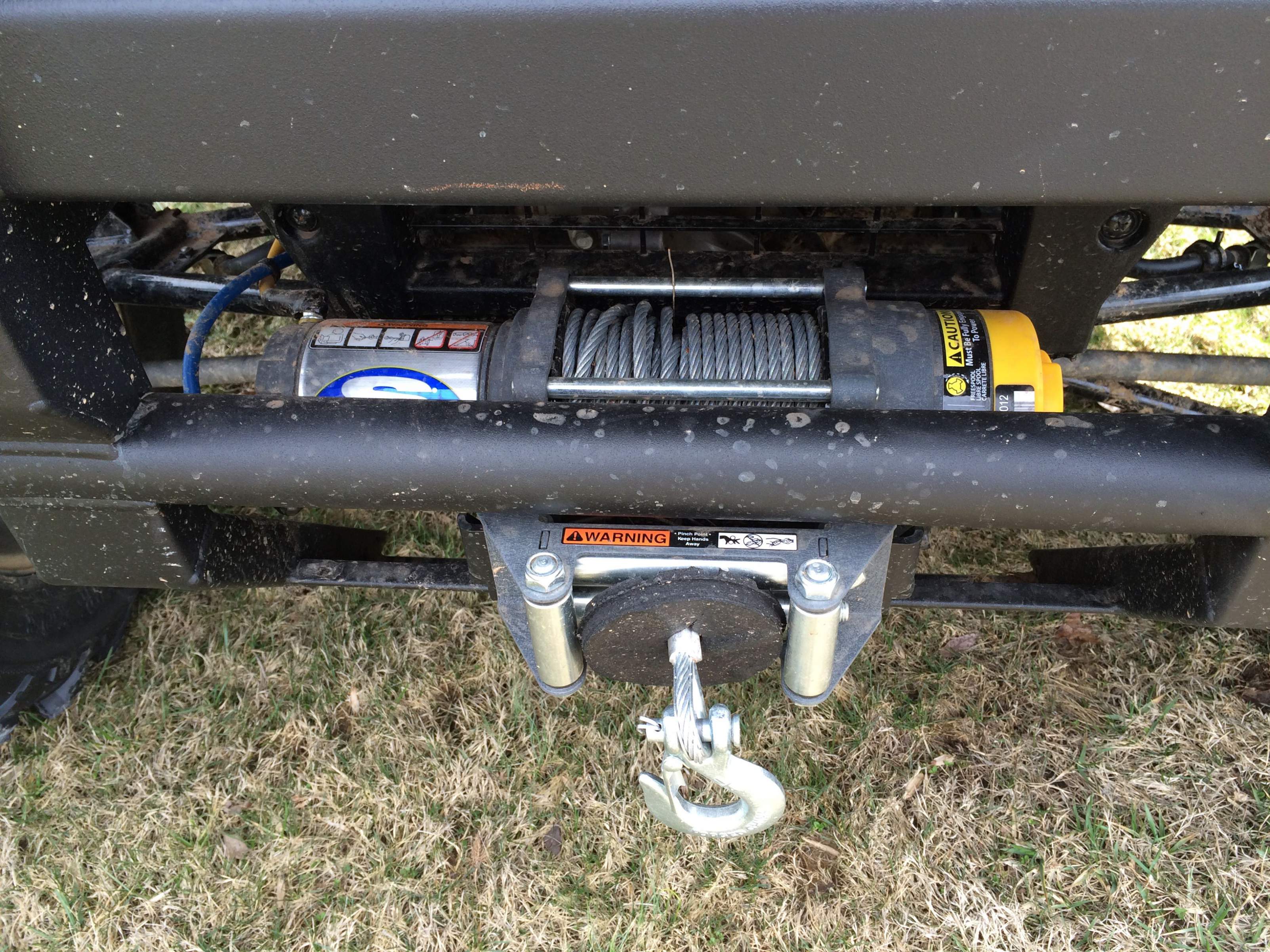

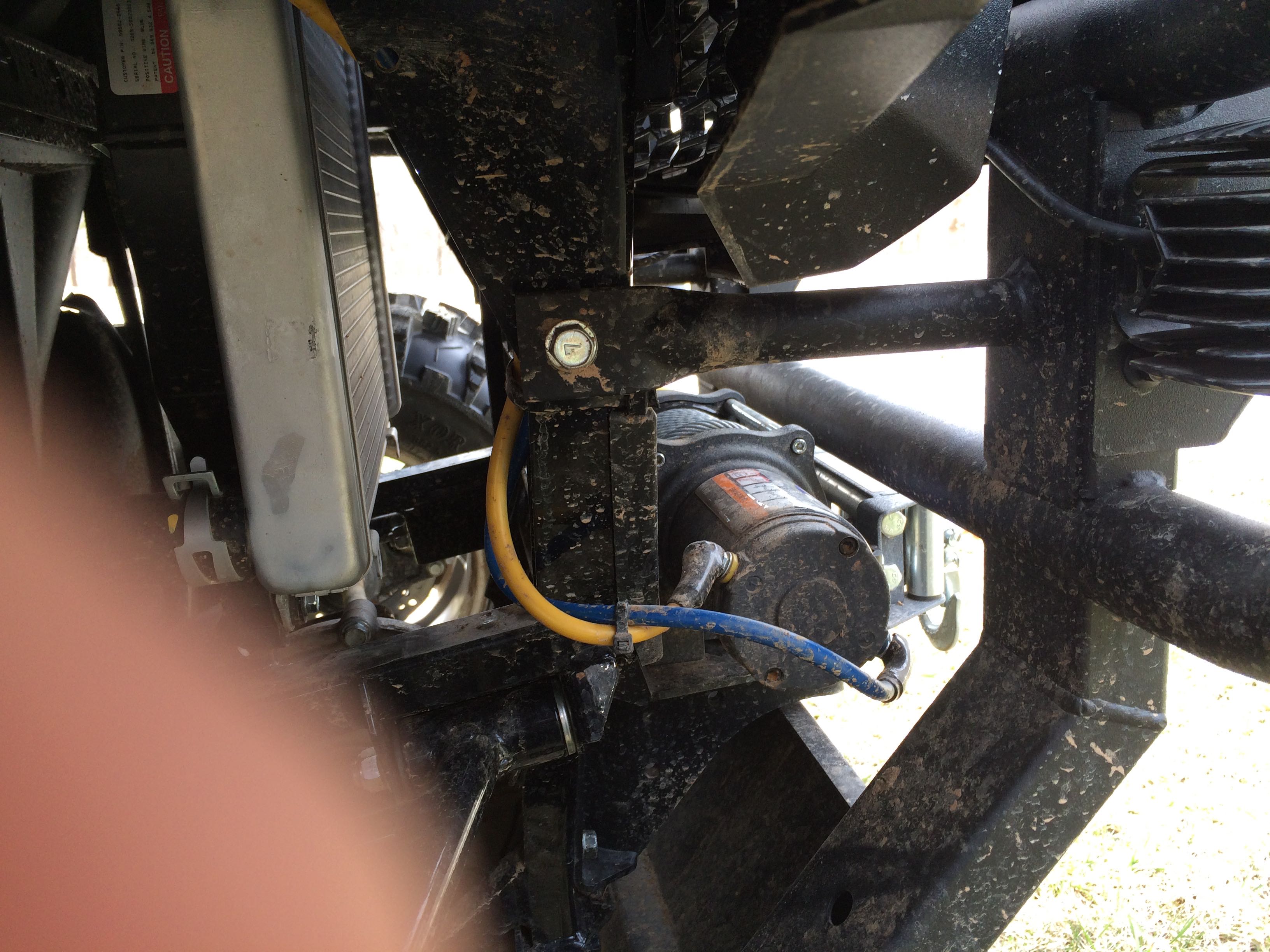

Ask and you shall receive.....
I shot a couple of quick ones this evening for you. I am running a Superwinch Terra series 4500lb on the Kawasaki factory mount. When I bought my machine no one had a mount out at the time so I just got the over priced factory one but it works. I went with 4500lbs due to the weight of the mule and figured if I load I could be close to 3000lbs so with a snatch block I was still ok.

Oh - forgot....
Yes I do have a separate fuse panel. Mounted it up under the hood on top of the glove box. A little hard to get to but out of the way and dry. Right now I have a TON of extra wire sort of wrapped in loops taped down in there so it is not pretty but functional. I wanted to have a bunch of spare wire in case I need to move it to put in a heater or something.
I currently have a 6" light bar, 2 front mounted D2 LED lights, a horn, a backup camera and monitor, and a set of LED backup lights wired to the panel. The winch is run from the battery to a a separate circuit breaker, then to the solenoid then to the winch with a lighted cab switch and a outside plug for the corded remote.
Hope that helps explain it a bit better.
