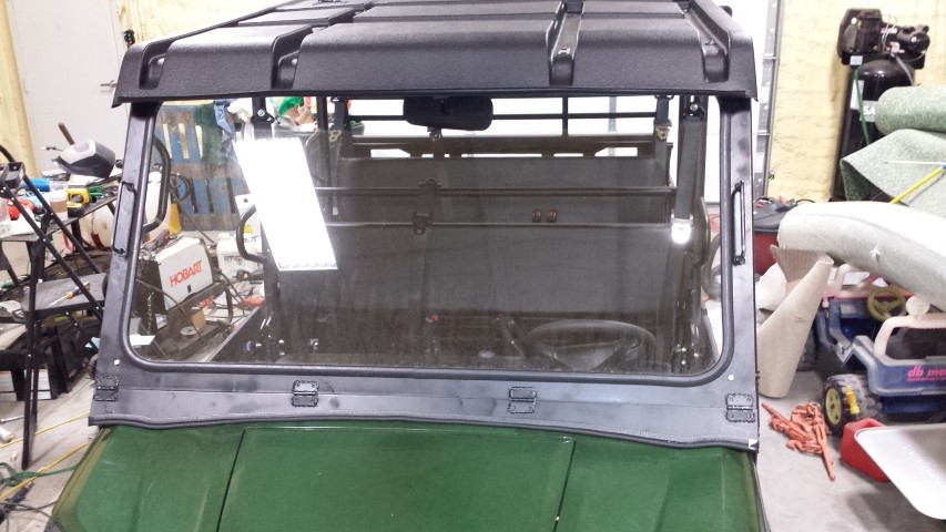

Did you use auto glass and frame it with Alum/steel? NICE WORK
   / Kawasaki mule pro 2015 #32
It is auto glass and I made the frame with 1/8" steel flat stock. Have around $250 into it. I plan to get some better pictures of it once I get the final fit done. The one thing I found out in the project was the width at the bottom of the roll cage and the top of the roll cage don't have the exact same measurements. I wonder if they are all like that?

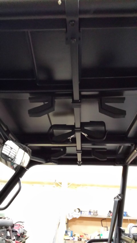

Picture of the windshield mounted and the overhead dual gun rack.

Nice work - looks like it came out great! So what is next on the list?

Custom cab and heater are likely on the short list. Maybe another dual gun rack for the rear passengers. I really should be rebuilding a mower engine but the cab and heater project sound a lot more fun.
Possibly a skid plate but don't really have rock in this area. Will depend on if my brother comes through with some free/cheap uhwm or hdpe sheets.
Gonna hold off on any sort of lift for a few years but sure liked the looks of the lift.

The auto glass you used, did it came out of a particular car model and year that just happen to be a perfect fit?
   / Kawasaki mule pro 2015 #38
The glass is new and was cut to fit by the local glass company. I just built the frame and took it to them to do the rest. The glass itself was only $115 or so. The rubber trim was a few dollars per ft. Way easier than I expected and very happy with the results. I might spray some bed liner paint on it as the current paint job is awful as it was freezing the day I did it. All i wanted was some primer/paint on it before the glass was set to ensure I didnt have rust around the edges.
