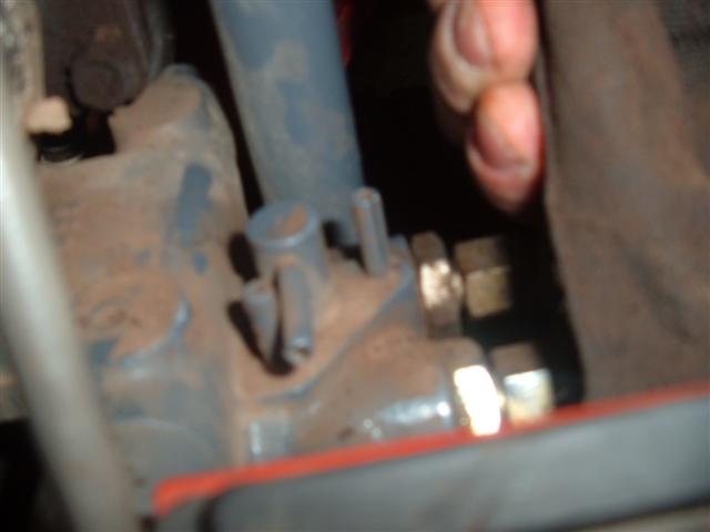

Drewl,
Outstanding idea. Two questions:
1) Do I really need a 3" hole? Will a little smaller work?(2")
2) If I read it right, you can get the rachet and an extension between the tire and the inside wheel well.
This has to make it alot simpler than trying to get my chubby hand in from the back.
Tom
/ KB2375 assist #22
Yeah, I guess most any size hole will work. Again, this is about as bad a location for a critical valve as there is. Locate it there? OK......then give the customer several ways to access this all important valve. While thinking about this, there easily could be a thumbwheel rod with universal joints or something. Again, terrible set up
on my back no more /forums/images/graemlins/mad.gif

That's a great idea Drew - any pictures?? I'm guessing you don't expect the socket to fall off?
Funny thing is I thought about the hole in the fender myself. This valve has got to be the worst design feature of an otherwize great tractor.
David
/ KB2375 assist #27
what do you know..............I took a pic but now have a problem with this computer so I can't upload it. The socket is on very snug so no, I'm not worried about it falling off
/ KB2375 assist #28
this pic doesn't show much other than the socket on the valve and if you look closely you can see the access hole I made

Thanks for the pic Drew.
Can I quit standing on my head now? LOL /forums/images/graemlins/grin.gif /forums/images/graemlins/grin.gif /forums/images/graemlins/grin.gif
