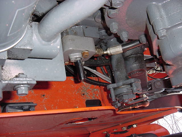

These are the remotes that currently exist as many of us with backhoes probably have. Are we talking about a second set? Again, I'm confused

Okay here we go...
Kioti valve, This is the one you have to reach in and screw in or out the valve.
Known to the Kioti world of dealers as a "hose kit" part number 322018 list price $170.00
Kioti rear remote kit part number 322026
list price $276.00
This will allow you to turn on and off the backhoe by the remote lever that will be located by you 3pt. lever.
You will also have the option of using your remotes for other attachments.
Now to the Woods hose kit.... part number 1011447
List price $275.00
This is a hose kit that after you installe it you have to hook the male and female couplers together to complete the flow of hydraulics when the backhoe is removed.
I do have pictures but there are to many to post so if some one know how to post a bunch of pictures in one post I will email them to them and they can post them or I will email who ever wants them.

/ KB2375 assist #51
No no no....
guys your "hose kit" will not do anything for you as a matter in fact you have to remove to be able to install the "rear remotes"
The little yellow lever will go into a slot on the left side of the 3pt lever.
You do not have to modify any thing, it is bolt on.

/ KB2375 assist #55
Okay, without the rear remotes, one has hoses running from the power beyond outlet on the main valve body. A lever must be turned to allow flow to the power beyond when the backhoe is hooked up.
Putting on the rear remotes, with the lever next to the 3pt hitch, the flow of the fluid is now operated with the lever, not the diverter on the main valve body. No more hunching down to turn the lever on and off.
If I have this right, you're going to put on the Woods hose kit and run it to rear remotes, bypassing again the need for the diverter of the power beyond. Correct?
I have mine running of the PB with hoses running back through the tractor where I then hook up the backhoe and move the diverter lever on my main valve body. A much easier location to access on the CK20. I don't have rear remotes.
