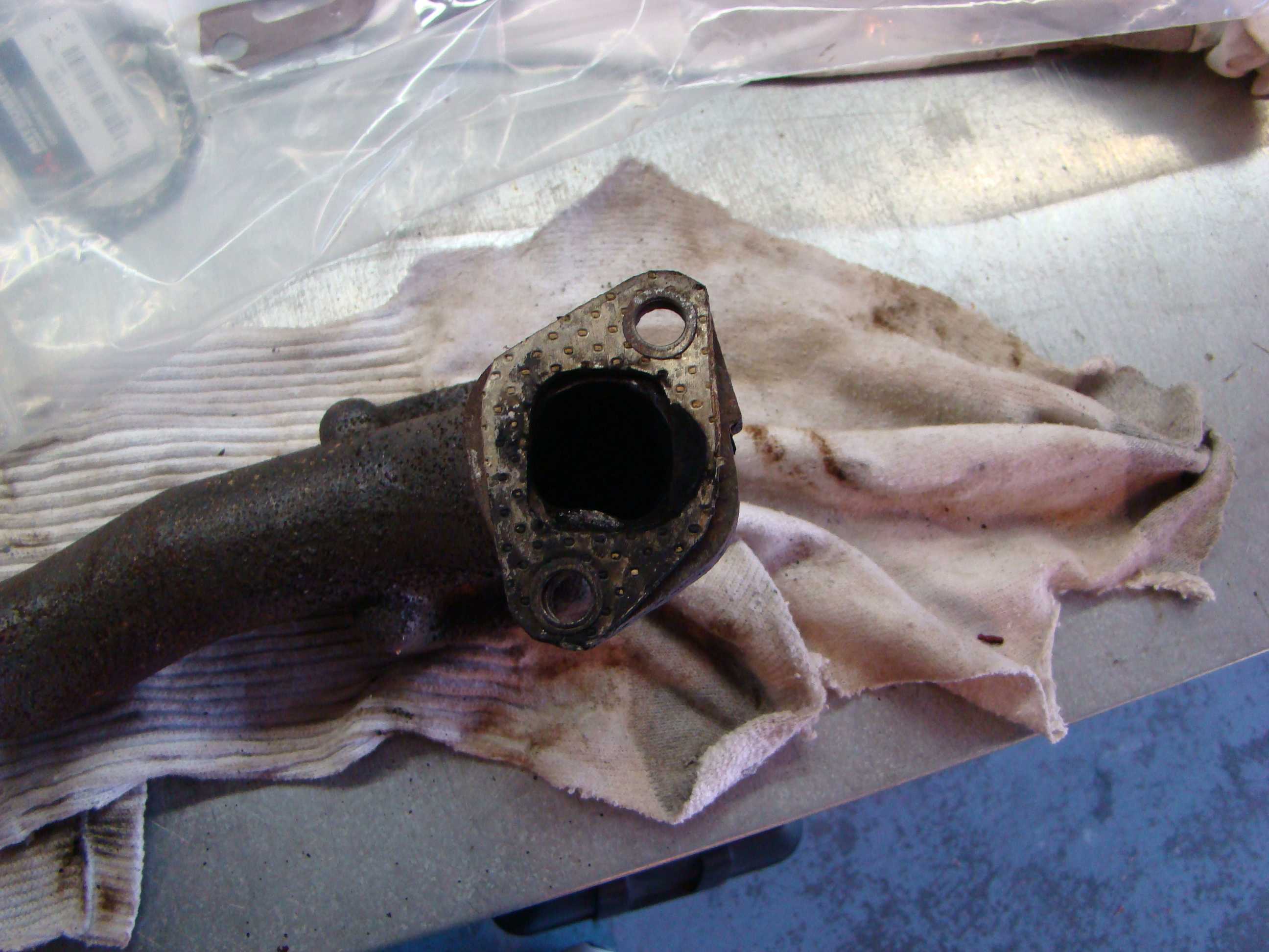

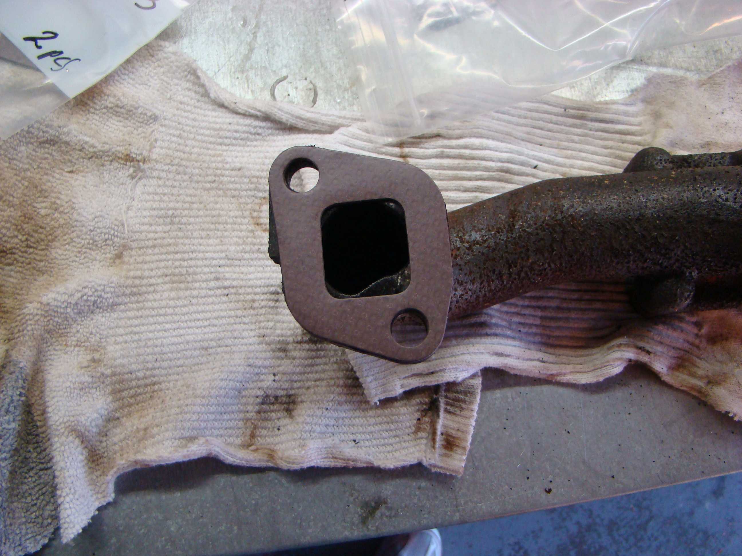

Exhaust gasketing and manifold begs of more questions. I'd have to say the manifold came off another engine although I'm surprised the bolt pattern matches so well. Apparently if the gasket bolt holes line up it's "good enough" - and even if the gasket was meant for the other side (or rotated 180 degrees) this is what I saw upon disassembly. I ended up grinding the rectangular pattern into the manifold to match the new gasket to help things out. We'll see what happens...

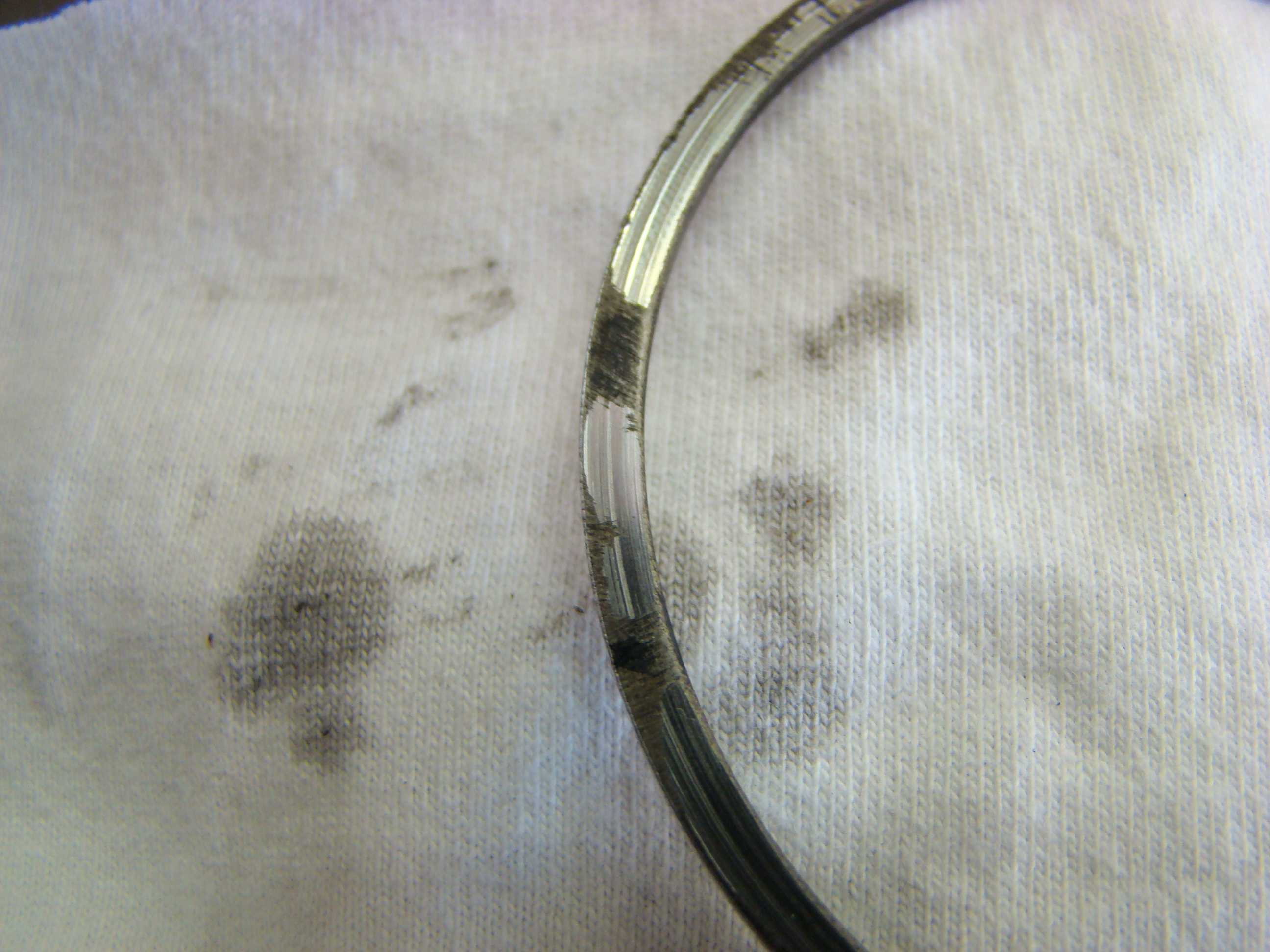

Crank pin journals check out ok - less than 0.001" wear. Need new piston rod bearings though as I can see some copper/grooving showing in the existing bearings and they are about 0.004" out of spec on wear. Rings check out as far as gap and side clearance although the ring thickness and piston groove dimension are not what I have listed in the service manual (both much less) so I'm a little wary of getting replacement rings since they won't even fit in the piston groove according to the literature I have. Both top piston rings show damage on the bottom sides. I think I'm just going to flip them over (keep the good side down on the ring groove) and re-hatch the cylinder and go from there.
Also found where previous repairman must have lost a rod nut and replaced it with a smaller one :confused2:
Oh, and the ring gaps were not staggerd like they should have been. Top two ring gaps were nearly in-line, the 3rd was about 180 degrees out on both pistons. I didn't really pay attention to the oil ring placement but will stagger all gaps 90 degrees upon reassembly as shown in the manual.

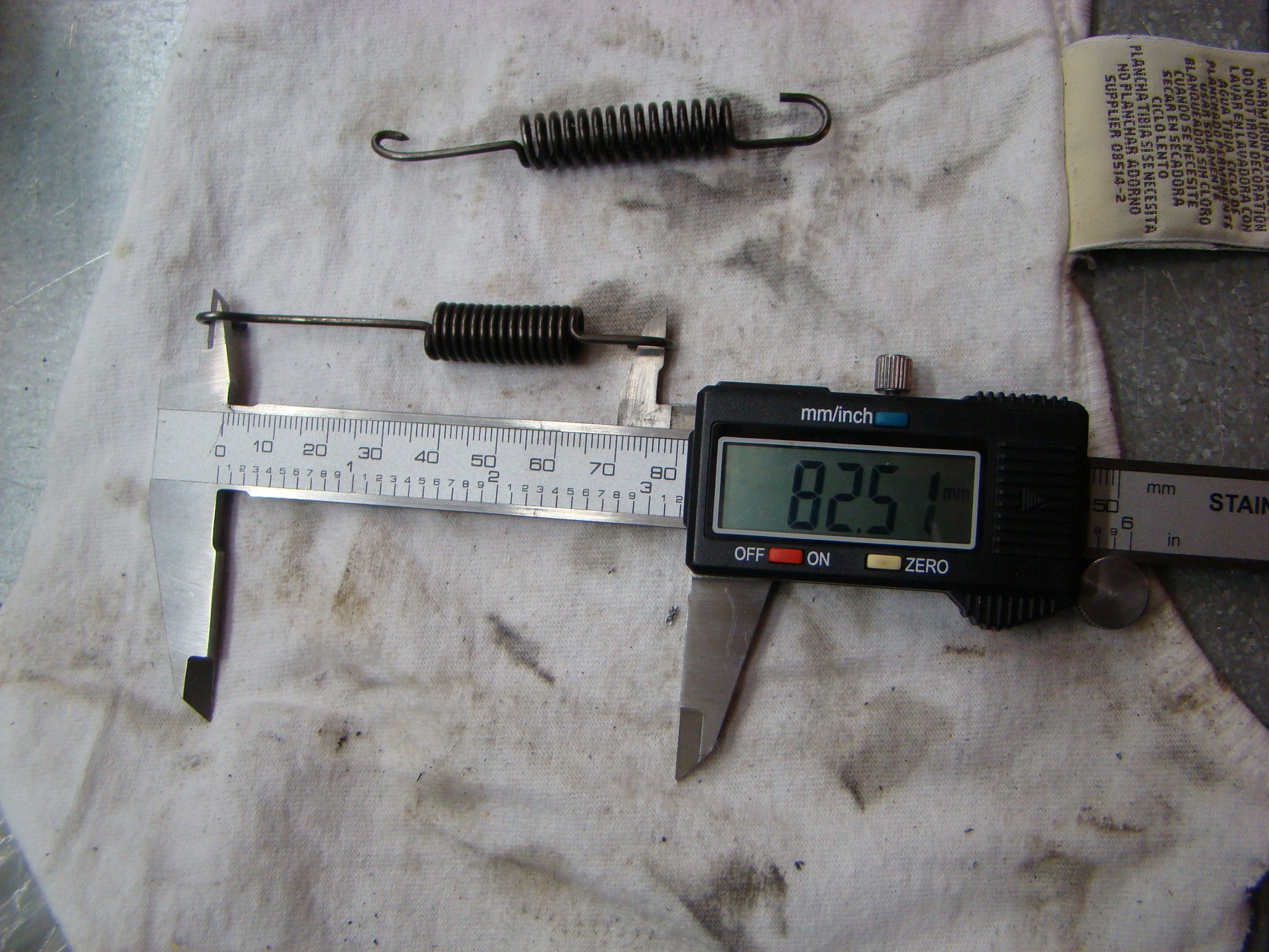

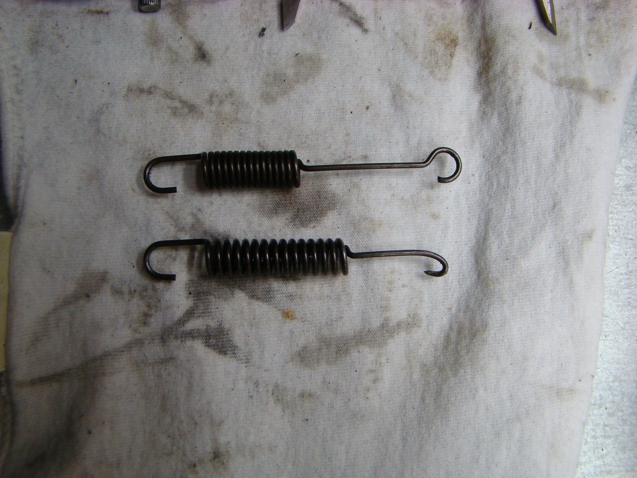

Finally got a replacement spring today for the governor control. Although somebody has clearly tampered with the original spring, it is close enough in spec. that I don't believe it to be the culprit. I guess I'm back to injector timing and I'll do my best to check/correct it going back together. The only other thing I think could be wrong is possibly the keyways are slopped out/have been altered (why wouldn't this surprise me?) and that is throwing off timing between the crank and cam slightly. I probably won't pursue that theory as it is more than I want to get in to. For future reference, a "good" spring has a free length of 82.5 mm and a spring constant of 6200 N/m.
