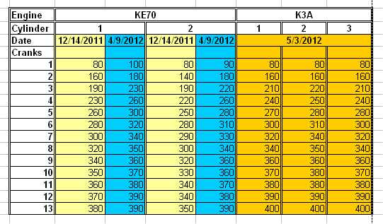

#46
Well not done yet. I compared compression results from a K3A engine in a Satoh 373 and found the results rather interesting. Take a look at the attached image. The two different test results on the KE70 were because I installed new rings on the later test. You can see a marginal improvement, but not one I was expecting. I concluded the pitons were too "out-of-round" to be able to seal again at the time. Since the K3A starts and runs good, and no lack of power comparitively, I have to conclude the KE70s problem is not compression which is what I suspected before, unless for some reason the comparison is not valid. The results my friend had are most likely due to him either not breaking the injector lines when testing, or because of the lower elevation (or both). The saga continues...
